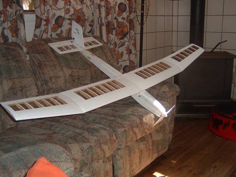

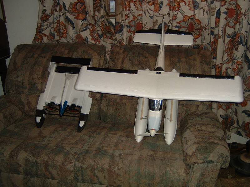

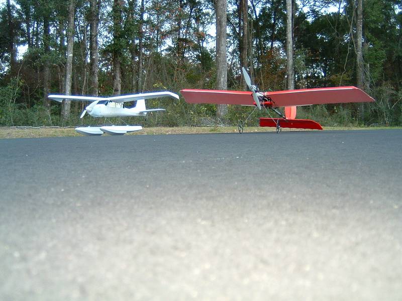

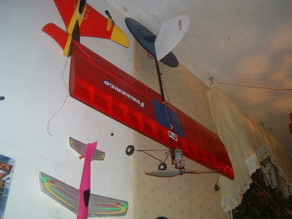

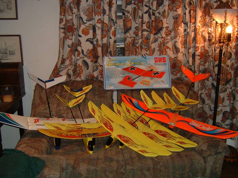

CL415: I got one word for ya - E-starter -, I flew wet-ones for 40+ years an let me tell ya, It's a whole new world sence I got into elc fly'in an has me gittie bout dumb-thum'in round just about where-ever I feel like it!!! your bub, scoooper
ID:	567166   Click image for larger version
