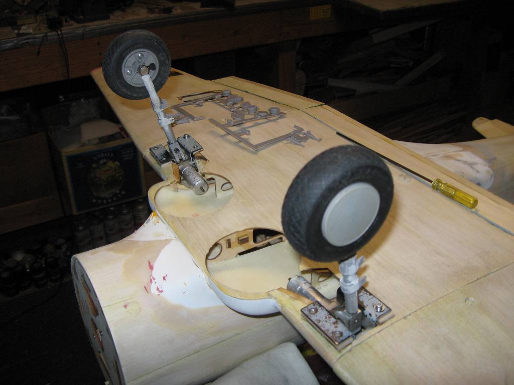

I guess the wing is a little thiner than the old Jemco kit. The Rhom-Airs don't quite fit in the wing[&o]. They will stick out the bottom of the wing about 1/8th" on plates that I made. I just can't bring myself to bend the struts so far forward from scale just to fit in the wells. I did try to compromise, but they will retract just behind the wells. You'll never see it on the ground! The reason for this is the same problem with the full size P-51, the struts come out of the wing just behind the leading edge. RC retracts wont fit that close to the L.E. so they must be mounted further back, effecting the look of the struts.
Here you can see the plastic Robart strut covers getting filled for detail work. And Robart scale wheels.

Good call on the strut covers. I went through a few cutting wheels on the dremel hacking up a set of VQ knock-off robo struts to make them look right with the correct length and proper sag on my Great Planes T-6 ARF. They do actually move...a little, but not much better really than hard wire in terms of soaking up a lousy landing. You can place her next to the Wedell Williams in the static area at the Canyon Crosswinds Scale Fun Fly for protection if you want
Probably fits right under the wing!

Okay, so I know you are set on your old skool Rhom-Air's but what if you were not? Would the new electric retracts have been an easier fit?
Old 06-08-2011 | 08:43 PM
scale dail's Avatar
My Feedback: (8)
Joined: Dec 2002
Posts: 1,471
From: Saugus, CA
Default RE: E Flite AT-6 Texan Convert to GLOW!
Actually I almost went with those electric retracts. They would be easyer. But times are tough we all must tighten our belts and re-use recycle, and save. So I went with as much stuff as I already had.
