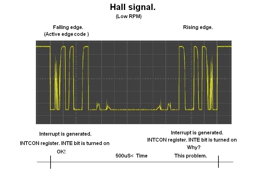

OK, I've finally run the CDI on a real engine. I used a 2-stroke Homelite 25cc engine. Normally runs about 12-13 deg. advance. My hall sensor was about 40 deg BTDC and just using the flywheel magnet.
I tried it once with John's curve and couldn't really get it to run for more than a few sec. I did a 13 deg. flat curve and it ran at about 15 deg advance. It was a little jerkier than I would have liked. It seemed to jump around a little bit within a about 3 degrees. Part of the problem was that my hall sensor was not secure and was vibrating around a little.
I tried to get the continuous spark problem to happen. I couldn't get it to happen on the bench. When I tried on the engine the first time I also couldn't make it happen. But after I hooked everything up and ran the engine for a few sec a couple times then all of a sudden it started doing the continuous spark thing.
For some reason it wanted to spark continuously only when the magnet was tripping the hall sensor. I flashed a new curve onto the chip and got the engine actually running for a bit, but now I could not get the problem to happen!
This whole thing is kind of a mystery to me! I can't tell what caused the problem and I can't easily reproduce it! Flashing the chip fixed the problem, but I have no idea why. It didn't do it at first, then started doing it until I reflashed the chip, then didn't do it any more.
I didn't get any sort of transistor heating during any of this, but I didn't run for that long either. It's possible that the two issues are related.
I'll keep working on this and try to figure it out. Now that I can test on a real engine hopefully it will be easier to catch things like this and figure them out.
For the moment I don't have any good ideas. All I can think of is that there is some sort of hardware problem. Somehow the PICs memory is getting corrupted, noise in the power supply or on the pins could be falsely triggering something, or we're getting ringing or oscillation in some part of the circuit.
I hate to point fingers at the hardware, but it seems like the program works correctly most of the time. I just don't see how it can fire thousands of times and then all of a sudden not work right until it is reflashed, unless it is suffering from some sort of electrical problem somewhere.
The program doesn't write to it's own memory or eeprom, and there's really nothing I can think of in the program that would make it do this. There shouldn't be any read-modify-write problems since I use a shadow GPIO register. If the shadow register got out of sync then a pin could be inverted, but it still shouldn't spark continuously like that. With the double check in the ISR, high frequency noise on the hall line shouldn't be a problem.
The PIC memory must be getting corrupted somehow or it's getting bad ringing on the hall line somehow, but also in a way that's cured by reflashing it. I'm pretty stumped here for the moment. Any ideas are welcome.
Maybe running this on the 12F1840 can shed some light on things. On that chip I can actually use hardware debugging and see what's going on in the chip when it's running in the circuit, otherwise I'm not sure how to figure this out.

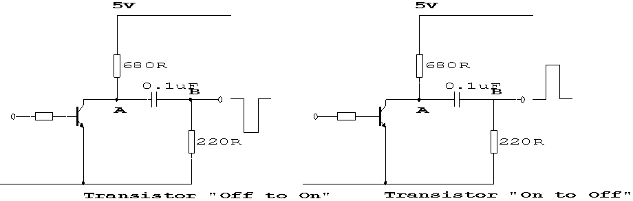

Q2 is normally on.
When it turns off, then the pulse happens.
Q2 could stay off for a week and it would still only give the gate the one pulse.
Pulse feed the gate of the SCR and turns it on.

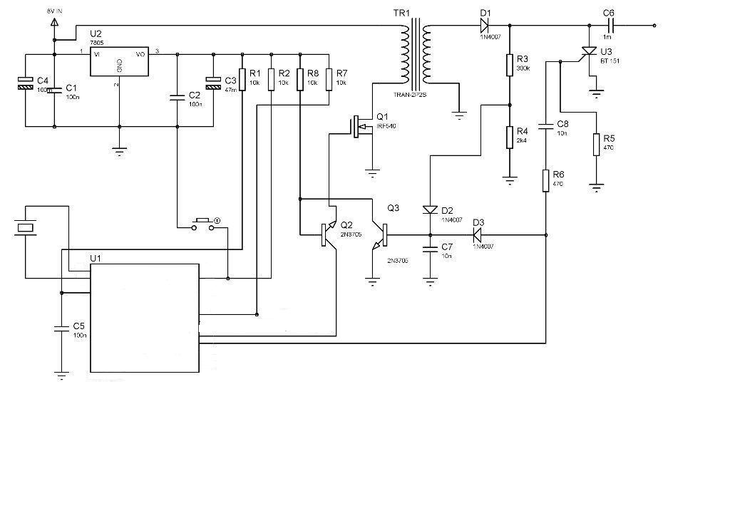

I think, that all problems is in the HV generator. Yes, self oscillator generator is a classic scheme and it works fine. Only I think we need to fulfill some conditions:
1. Stop HV generator when reaching HV tension on a cap.
2. Stop HV generator during SCR is open.
3. SCR must be open by input pulse duration during the HV cap is discharging.(about 1.5ms depends on HV tension and cpacity of HV cap.)

The way that Q2 operates is as Jake said. It is in the "on" state and goes off when the spark is required.
IF a NPN transistor is "on" then the transistor is fully saturated and the Collector and the Emitter are connected. With that being said if the emitter and the collector are connected this creates a low signal , which causes the .1 uf cap( in hv board) to discharge to the gate of the SCR, thus causing the 400v .47 cap to discharge through the ignition coil.
With a 680 ohm resistor feeding one side of a .1uf cap and a 220 ohm resistor on the other leg of the cap. the cap charges. a low going pulse at the 680 resistor/cap junction is what causes the 1.cap to discharge. There is no way that the SCR is "held on for too long".

@Nyemi, but you using a "controlled" Voltgae system at the ZVS.
You can't make spikes with this kind of transformer.
A flyback act like a bobine, it generate uncontrolled spikes.
The transistor can't handle this if the spikes will be to high, it blow it selfs.
The SCR can only shutdown if the Voltage is going true zero.
If the SCR stay open it will fire if the HV will be high enough to make a spark.

Just thinking out loud here but it may be something to do with different devices used for the SCR and Q3 and their characteristics.
Just as the oscillator circuit provides induction to a high voltage through the HV transformer, so transient voltages from the HV discharge can pass back the other way. This may have a beneficial or a degrading effect depending on when this occurs. i.e. if the phasing is correct it could tend to turn the Q3 transistor off for a short period during firing. If not, it might be possible to turn Q3 on harder.
SCR's are also susceptible to "rate of voltage rise". This can actually turn them on if excessive. Usually selecting a higher voltage SCR can be beneficial.

I have done this test over and over here but I know it's not the hardware. What I have in the chip now is Nyemi's software, and it works perfectly every time, no matter what I do. I pull that chip, plug Jake's in and immediately it malfunctions. Plug Nyemi's back in and it will run perfectly again. That test, to me, points to a software problem fellows, no matter how you look at it. I've tried it on every commercially manufactured ignition I have sitting here, DLE, Rcexl, DA, 3W, CH, and even mine which is actually a CH board and components. Tests are all the same, overheats the output transistor in the hv oscillator section on every one of these brands.
So you see, it isn't just my hardware, but a software signal problem causing this condition!!!!! Nothing more.

The hardware is a little critical and the software will do the rest.
Thats why I want to redesigne with the MC34063 a new hardwareboard.
It have the options to stop the HV if there is no spark needed.
It also controles the HV-Voltage and there are no components who can overheated.
We can try, if it is not a good designe we stop to find a other good HV-board.
You have also mention, I need the CDI for my bike so I need a secure CDI.
You can make your plane (..) plug and play, but I need more then 1 hour to replace the CDI if it fails.
Beside the road, into the rain or snow I don't think I can handle this......I think I leave the bike.

I don't say your HV isn't good, but for this designe it have a problem.
I try to make a flash / strobelight from a disposal camera, I use the hardware for a long time.
On boats and planes for navigationlights and also lost plane lights.
It works perfect, but wanted the tube flash at the same time with the spark is a problem.
The last couple of days I distroy at least 10 SCR's and I don't know why.
I use allmost the same schematic like we do to fire the SCR into the HV-board.
BTW, maybe the HEX will be mess up into the EXEL-sheet ?
Do you have to compare the HEX files from a good and a bad PIC ?

SCR requires a positive pulse to turn on, so I still regard your opinion as incorrect.
Below are some supporting images and a web site where you can check if you want.
web site..... http://www.electronics-tutorials.ws/rc/rc_3.html

Nyemi, thanks for your help.
If the hall input is really as dirty as the trace Nyemi posted then I think that is a problem. It would be good to put some low pass filtering on the hall input. Perhaps someone can do some calculations to find the proper cutoff and values.
Maybe some experimentation with the pull-up resistor on the hall line could also help with this.
One thing I can try is turning off the INTE in the GP2 ISR and then turning it back on after the spark fires. That should make sure that no interrupts are generated from random noise while the hall is on (low).
I've got some time today and the engine is here with me for testing. As soon as the locktite on the hall sensor mount dries I'll start testing things out. Should have done it last night, but didn't think of it.
It won't hurt to think of ways to possibly make the hardware setup a little smoother. A wee bit of analysis and tweaking might make things more reliable as far as the signals that the PIC sees. I really should have scoped things out better, but now that I have the engine running I'll have a better idea of the actual signal environment. If the hall signal really is that dirty then I think the falling edge is the way to go since it seems like a dirty signal when it's activated (low), but clean when it's off (high).
In any case stay tuned to the thread, the problem will be solved today.
-Jake
