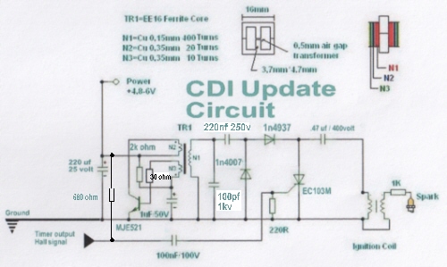

Jake,I'm trying to post a revision of the CDI HV board schematic which should be used in the kit version. It's a revision of what Nyemi posted from RCCDI RC Ignition. I think it finally worked. I built 10 more today, tested and all spark great. I also tested the kill feature on the timer board with a servo operated switch, no RFI interferrence, even using an old 72 MHz. radio ! I used the throttle servo with a micro lever switch, and worked perfect.
Rob, this is the circuit you'll be building and testing with the rest of us. I included a few of the kits in your box.
Seems Murphy's law prevails! Got ahead of myself yesterday and uploaded a picture before I checked it out! Disregard the photo on the left! Use the one on the right which has an added resistor, 680 ohm to the signal coupling to the SCR. Sorry to confuse everyone again..Maybe this one is correct. Let me know if I made any errors, since we want this to be what we are all going to be using.
John
John

Charlie, I have the multispark feature enabled and it still does a steady fire at the plug, but not every time! Getting stuck in the loop somewhere when it recieves a signal to fire, definitly needs fixing!! It does a nice ignition spark test though! LOL
John
John

Try it with the diode I drawing.
I think the SCR isn't closed after firing.
I'm also missing the SCR protection, 22nF/ 600V and 22R/0.5W
BTW, the Bosch schematic is only for inspiration.

BTW, can / wil you test the CDI with the diode who I draw into the schematic ?
I think the SCR didn't close and open again if the voltage is enough to create a new spark.
A SCR is only closed if the Voltage is going true zero, reverse the HV-coil wil do this normaly.

Rob, just tried your 3 added parts and it still does the continous sparking. It's coming from the pic in the software.
Jeff, also tried the small cap at that juncton, also a no go. So it is in the software. Stuck somewhere in a loop until it sees a change of the hall signal because if you move the magnet away from the sensor, it then stops. Somewhere in that control loop lies the problem.
I replaced the burned out transistor and all is well with the HV board again. Ran the engine and it's fine. Just can't stop the magnet under the sensor or you get a buzz of sparks and the transistor heats up cause it is supplying too much current to the oscillator circuit.
Somewhere there's a problem with it, Maybe Jake can find it.
John
John

Jeff, I placed it inline and same thing, so it is getting a signal to fire multiple times until you remove the magnet and that stops the signal.. What a mess, thought we had it nailed, otherwise it works great as Charlie said. Both switches work fine, good starting and handling characteristics otherwise. One last glitch...
John

mmm...ok...just sent you an email with a mod for the input you can try. Should give you one, and only one , pulse as the magnet approaches the hall switch.
If it works like I think it should, I'll poke it in here.

Looks like it may work as a debounce circuit Jeff.

The way it works is, the cap normally has both ends at positive rail. When hall switch turns on, it pulls the one end of the cap to ground.
It gives a negative going pulse at R1,R3 junction as the cap begins it's charge, and then after tou time, the pulse at R1,R3 junction goes high.
It will stay in this state until another high to low transition of the hall switch.
Just have to select correct values of RC so that it doesn't interfere with other timing in the system. i.e. with 0.01uF and 4K7 should give approx. 32uSec.(if I'm not mistaken)
