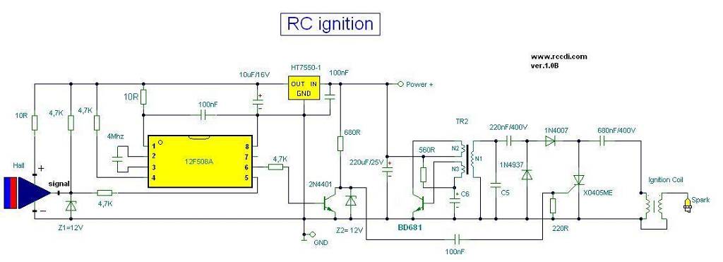

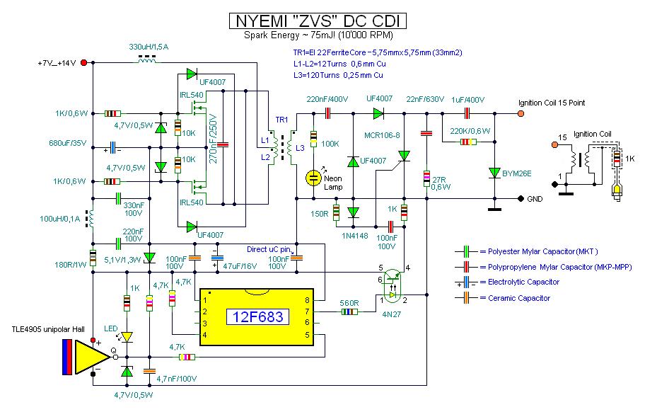

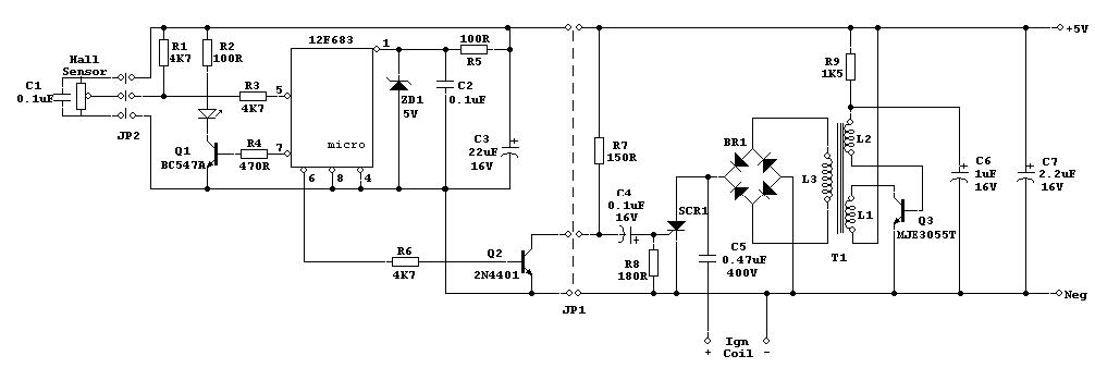

There are make a lot of schematics the last couple of years and not everyone knows wat code belong to wat schematic.
My idea, make a complete package from al the files we are using into the zip-file.
Why, I found 4 differend schematics into this topic.

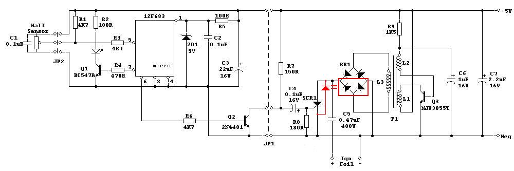

Jake,
I was not sure your intention is, so I just asked you.
Even I don't know why the collector of taransistor connects to the gate of SCR in the design of RCEXL. The transistor need to be ON usually so some current runs from the collector to the emitter. If the gate of SCR connect to the emitter and R like attached, no waste current. Or just the direct connection from PIC to the gate of SCR should be okay. (depends on the type of SCR)
You better to update comment as well.
* Pin 6 (GP1) = Output to HV spark circuit, active high *
Jay.
Jay.
