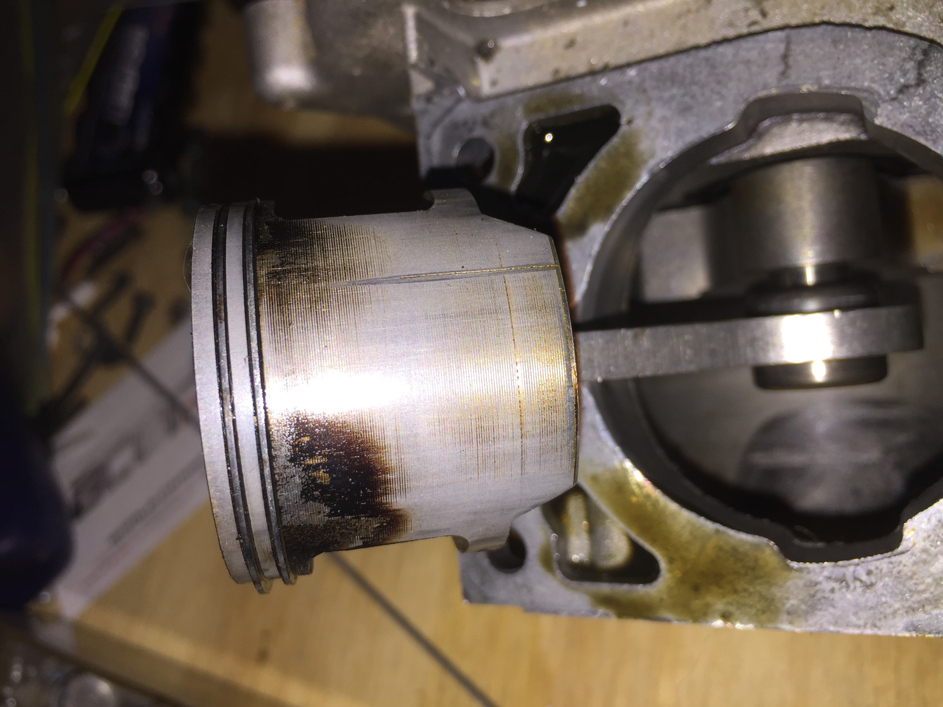

Anyone know what engine this is and what are your thoughts on the condition? I believe it to be a 30cc Homelite. The rings are pinned so I will get a bowman ring. Do I need to get two rings or just the top ring? Also the top if the piston has a nick on it. Will this affect operation and is their a way of sanding it? A bit of carbon on the top of the piston as well.

All in all probably a useable engine, but it's worn. I don't believe it is "virgin". The sideways sanding/score marks in the cylinder were made by someone with too coarse a grit sandpaper. The base gasket does not appear stock, and it is covering portions of the transfer port passages, and the transfer ports appear to be the small ones. The piston is worn. Normally I use a Bowman ring in the top groove only, and a stock ring in the second groove. It appears to me that a piece of the second ring is broken off right where it is supposed to fit over the pin in the piston on this one. If the top ring is undamaged, just use it in the second groove.
The engine can be rebuilt and will run, but it is not the best candidate for an engine you are going to put a lot of time into souping up due to the wear on the piston and condition of the cylinder. It is a 30cc. The fastest, easiest way to tell a 25cc from a 30cc Homelite it to just look into the exhaust port. The 25cc has the bridge in the exhaust port while the 30cc does not.

I would clean everything up real well. Take some 400 grit sandpaper used with solvent and lightly sand the cylinder bore. Then put the top ring in the second groove, a Frank Bowman ring in the top groove, install a new base gasket and you should be good to go. An 11mm carb will work fine.
It is not worn enough that it won't make a good running, use-able engine. I would just choose one in slightly better condition to use as a base for an extensive hop up project.

Junk... Pitch the top end. Look at. the wear patterns. The piston skirt is well worn and it has caused some wear in the jug. Most two strokes that die for causes other than melting down die because the piston wears, it starts rocking in the bore, then breaks the skirt off then boom.... Hint is all of those machining grooves you can see in the piston near the rod.... Guess what on a new piston you will see those run all the way around all nice and even... They actually help hold the oil film for lubrication and reduce drag. Notice how near the ring they are all still there but as you move down the piston, they dissapear. You can see the wear the rocking has caused in the jug.. you would probably need to go well over .030 on a bore to get it round... Dont waste money on a new ring, it will just get you to the end sooner. Find another in better condition for your final product and use this one to learn on...

I get the idea these Homelite engines are not made very well. My low time engine looks pretty worn. Here's some pictures of the piston.
