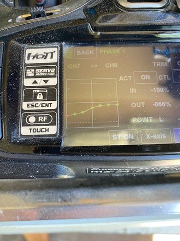

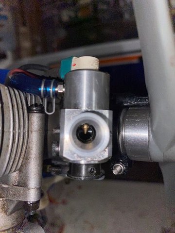

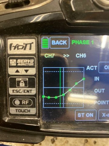

Default Success...
So.... Tried the skinny Venturi mod on the ST .45 setup and it made a huge difference in handling - No other changes required other than a moderate retune which seemed to mostly affect the top end (needed to lean)- The large flat spot the top is now gone and the idle is much improved - The biggest change is tunabiity as the mixture control is no longer critical and very easy to set. I did lose a bit of performance I think but its hard to estimate as it was relatively hot today - I showed 11,300 on a 10/8 today and I think I ran 11,800 or 11,900 on previous occasions (cooler) - I'm going to leave the power "test" to how it feels flying.
I can tell that I will not have to set up overly rich on takeoff with this setup, as was the case before - and I can also tell that tuning will be greatly simplified as there is not a spot in the range that shows critical adjustments any longer.
Here is the comparison of the resulting curve - Without and with Insert.
Previous setup - Big bore
Skinny Venturi

Wow... that is a significant difference. I'd say super result. And if the power loss is an issue, we can fix that "the American way": There's no substitute for cubic inches (although in all fairness, I believe that the origin of those and similar quotes has to be contributed to Enzo Ferrari, who said that it is always advisable to have more horsepower than the competition...)

This is a bit of an eyeopener as it "changes the game" a bit if we are making a simple TBI carb to fit an engine - We can make it smaller and "accept the losses" for ease of handling and setup. No need to get into fancy pumps or regulators as I think i'm going to find this thing will now run great as is.
This ST in its previous form with the 7mm carb never really lost any power in my estimation - It preformed like a good strong .40 on glow (or even a .45), albeit at the expense of ease of handling. I think we have all run some "powerhouse" engines that made tons of power but were on the finicky side. With the skinnier venturi, the "expected theoretical" power loss is there but the ease of Handling comes back.
things I noticed immediately:
1. Mixture setting was noticeably less critical - 1 "click" on my mix curve produced reactions that had me wishing for a 1/2 click option - Now it takes 5 clicks to produce the same result.
2. the engine can run at full power (static) Without showing signs of heating - even at "leanish" settings - Previously I had to keep the mixture overly rich to keep the heat in check statically.
You are correct Bert - Cubic inches can solve this equation - Like a .50 on gas = a .40 on glow.
The original system of an unmodified carb and inline solenoid still trumps for ease of setup and availability but if we go to lengths to produce a "simple carb" - I think we can make it better by getting the size correct.
Hope to get out flying this week to see if the in air performance mimics the "***** cat" this has become on the ground.
