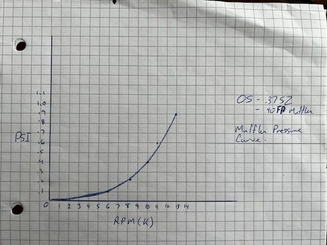

Maybe it is useful to know what relation there is between RPM and muffler pressure for a given throttle opening and (slightly) varying RPM. Because I don't think that relation is linear.
Absolute values are probably less important, but whether it is exponential or not, and if so, what is the exponent...

What if you were to define the actual fuel pressure you wanted based on rpm and then control the pump based on an actual pressure sensor instead of a curve? Pressure would then be very specific for each rpm.
nfortunately, no... The muffler pressure is related to both RPM and throttle opening. If in my helicopter with the gasser (electronically governed) pitch is added, the governor opens the throttle and the muffler pressure rises significantly, despite RPM remaining constant.
And then again it also is depending on mixture strength: For the same RPM and same throttle opening, if mixture is varied, muffler pressure also changes.
Under normal conditions that really is not a big issue, BUT it means you cannot just make a bunch of full throttle testruns with different propsizes (to alter RPM) and take muffler pressure readings and base an entire mapping on that. That measrement would be useful to determine the relation between (all else remaining unchanged) RPM and muffler pressure, and assume that that relation remains the same for other throttle openings
Or do you mean, that the pump is actually controlled by a sensor determining actual muffler pressure in a practical set-up? Yes, that would be exactly identical to real muffler pressure. But it would defeat the purpose of the system a bit, because then a craptrap is going to be a whole lot easier for most people.

I meant that the fuel pressure/muffler pressure is actually controlled to a specific pressure based on an actual pressure sensor that would vary the air pump speed, the bleed valve opening, or a combination of both.

Needle valve.... I found a solution. The typical OS FSR type needles are identical length and thread (and sealing) but the taper is over twice as long . Will try today.
Did take some real quick muffler pressure readings yesterday and despite this being a fairly restrictive muffler (from an OS 40FP) the pressures were lower than I suspected. Also I noted that the mixture setting does change the pressure independent of rpm. As you tend toward lean at peak the pressure drops slightly which is not really what we want. The slight pressure drop seems to proceed the rpm decay just slightly..
The other thing ii noticed is that the pressure is a bit more linear that I expected and this bears out with most gas conversions going rich in the mid range - My quick running setup yesterday pushed very little pressure under half throttle when transitioning (and running) through the mid range. Muffler pressure is typically higher here...
We could drift down the road of adding sensors to measure and relay data but in an effort to KIS I think we might have two basic options now - the E-pressure is not much simpler than the solenoid setup but it is cheaper as the pump is $3 and easy to find.
Will do some more runs today and get some better data if I can...
That makes sense: at peak RPM, there is that small range where the improved efficiency of leaning out basically cancels out the reduces supply of energy, AKA RPM remaining constant, but because of the smaller mass flow of fuel, less gas is produced. So indeed, when going from overly rich to overly lean, just a fraction before reaching RPM decay, the pressure will drop

Waiting for videos to upload from testing today - Good success today...
I did get a "pressure curve" from the muffler tap today and its quite exponential as Bert expressed - Here is the quick graph of it..
I stated yesterday that muffler pressure seemed low but the numbers today were better - I put a 4 oz tank in line to add a buffer and got better numbers on the manometer - I think it does a bit of a sampling average and the pulsating when hook directly must have effected it. It showed about .9 psi at WOT so one of the test I ran I closed in the bleed to mimic that pressure and it ran well at this setting.
Originally Posted by 1967brutus
To me it seems the E-pressure set-up is bulkier?
I think you might think the pump is bigger than it is Bert - Its quite small... controller would be the same size and still runs of the receiver power with very little draw. The pump weighs 5 grams more than the solenoid and we don't need a crap trap. The needle will be a simple "restrictor" in the vent line tee when we know what size it must be. Overall I think the volume and weight will be less. It's a less precise system based on early test but seems less critical in setup also.
