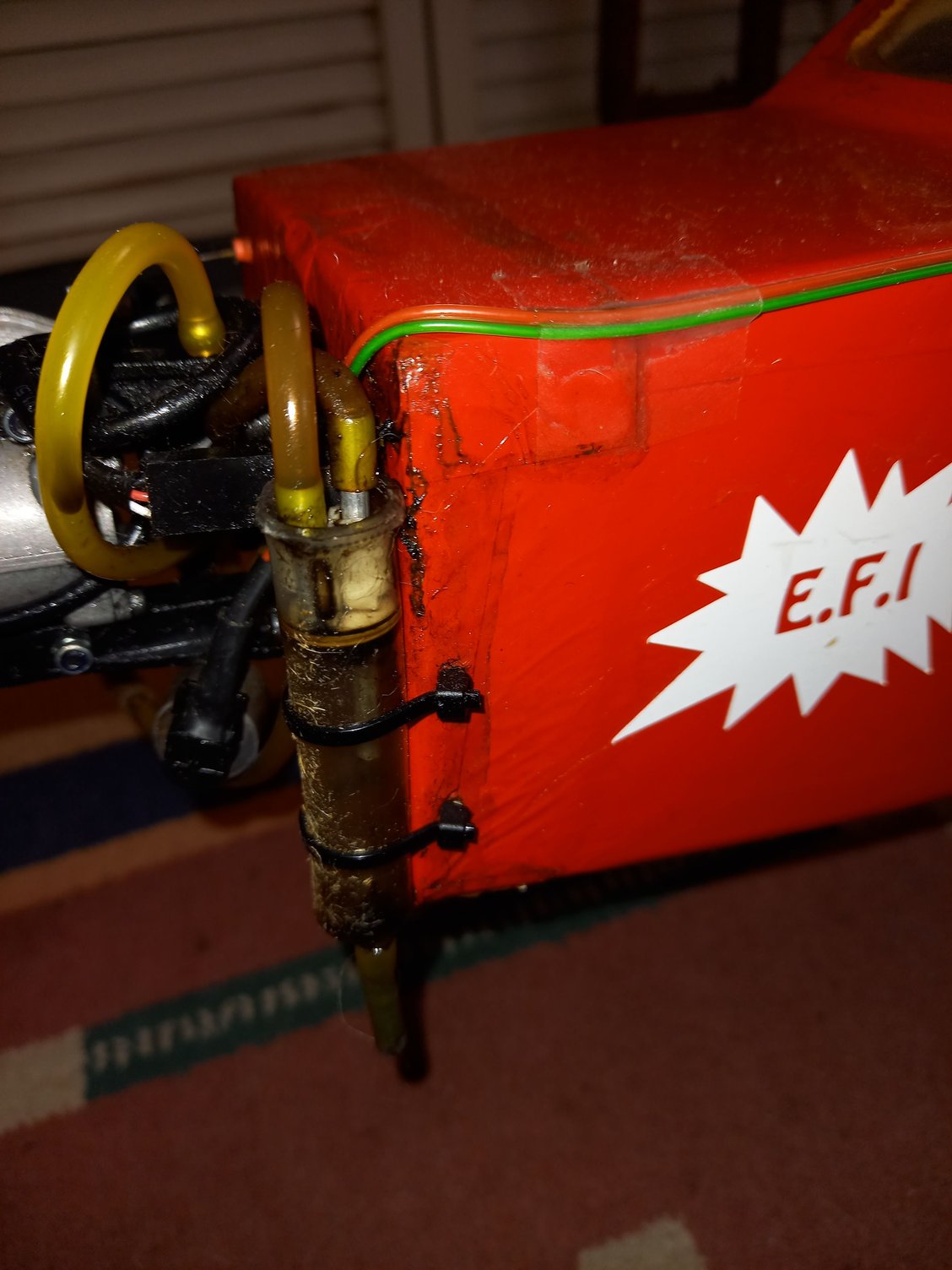

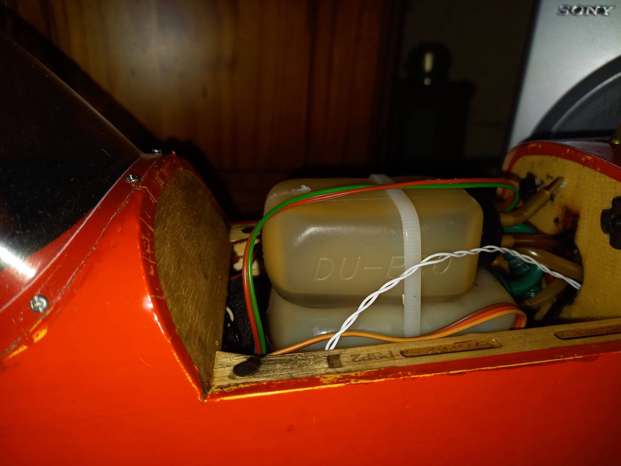

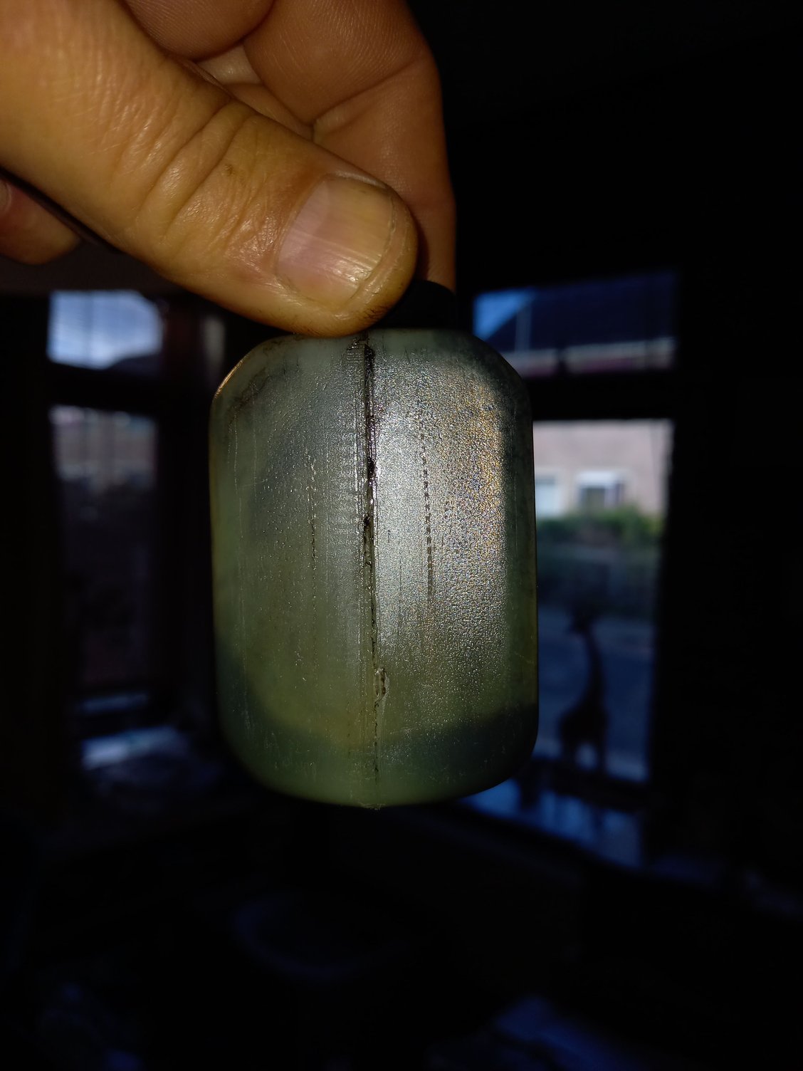

I am not getting it: We started out with a fairly simple, and above all cheap system, intended to run SMALL engines in SMALL planes on gasoline. We're now over-complicating it for the sake of getting rid of a 5 dollar craptrap, and we're losing versatility (I don't see how I would fit an additional airpump and the battery to power it in a 60"wingspan trainer), we're increasing the number of adjustments, and all that to get rid of a craptrap the price of, basically, an old syringe...
This is my trainers craptrap. 10 cent item, and on average I need to drain it once per afternoon, at the end of the day. No biggie. Just pull the cap and leave it to drip, it does its own draining and cleaning.
This is the craptrap of my SpaceWalker. 5 Bucks item. Due to the more aerobatic nature of the plane, there is a bit of fuel reflux. Yet, on average, I empty it only about every 2 months...Engine is in use since about March 2017
This is the craptrap for my ASP FT160. It has not been emptied EVER (Engine is in use since spring 2018...) And in the pic it looks fuller than it is, because I "sloshed" the crap around pulling ut from its fittings. Content maybe 5 ml, still 25 to go before it needs cleaning, which at this rate would be another 16 years)
This is the reason why (I think...) the twin has such a low crud-production: Muffler taps are connected to a T-junction, and most of the dirt shoots back and forth from one muffler to another.
That's just 5 1/2 years of practical experience there, and after those 5 years, I really don't see the issue people have with the craptrap. We have lived for decades with engines that would slime a plane all over, big and heavy fieldboxes, large amounts of expensive fuel, messing about with glowplugs and their power supply, fuel compositions (Castor or synthetic, how much Nitro) and what not, but a craptrap is a problem? Trust me, it is there but properly installed you barely notice it. Depending on plane and flight envelope, I even have one that is TOTALLY maintenance free, because it is self-emptying.

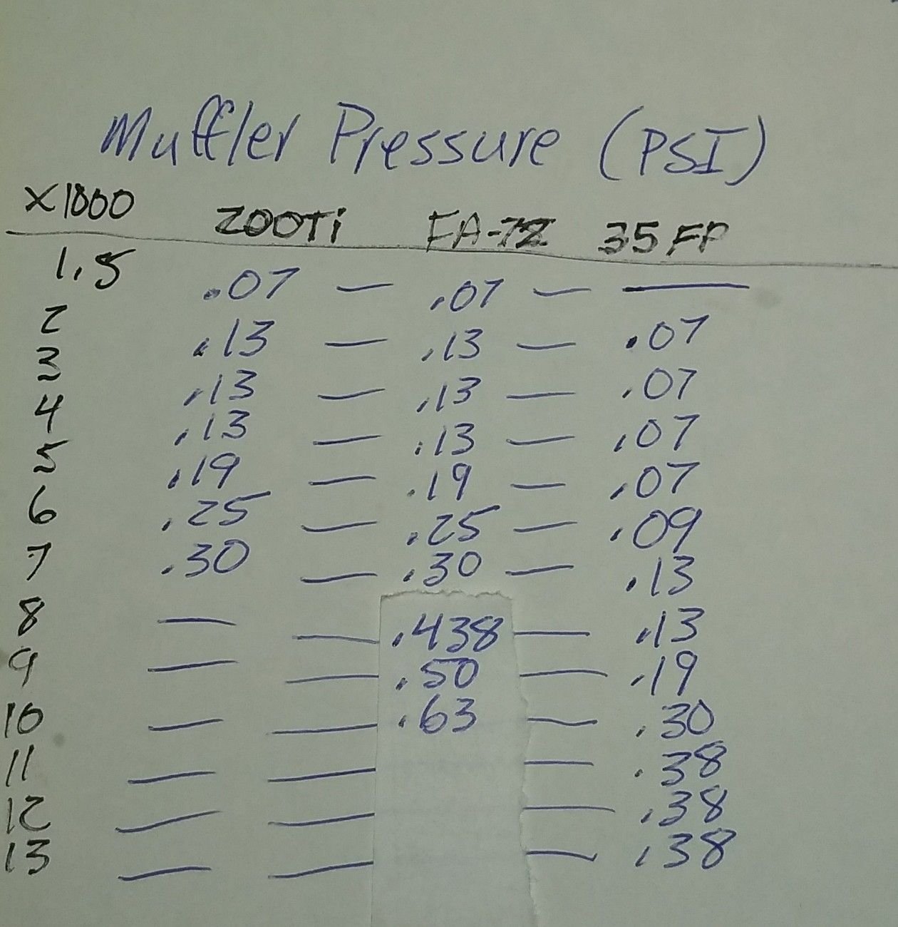

Most RC tanks get pressurized but its only .5 psi - Some (YS engines) get pressurized much more. A small fuel pump would be doable (RC turbine) but I think control of pressure/flow would be an issue. It works in the turbine as its the "driver" and everthing else happens because of the amount of fuel applied - with an IC engine - it must follow a number of other drivers.
#892
The Saito 200Ti has a straight header with a crimped down end. The pressure tap is near the end.
The Saito FA-72 has the cast "trash can" muffler. The pressure tap is in the expansion chamber area.
The OS 35 FP is a stock unit. The pressure tap is in the expansion chamber area.

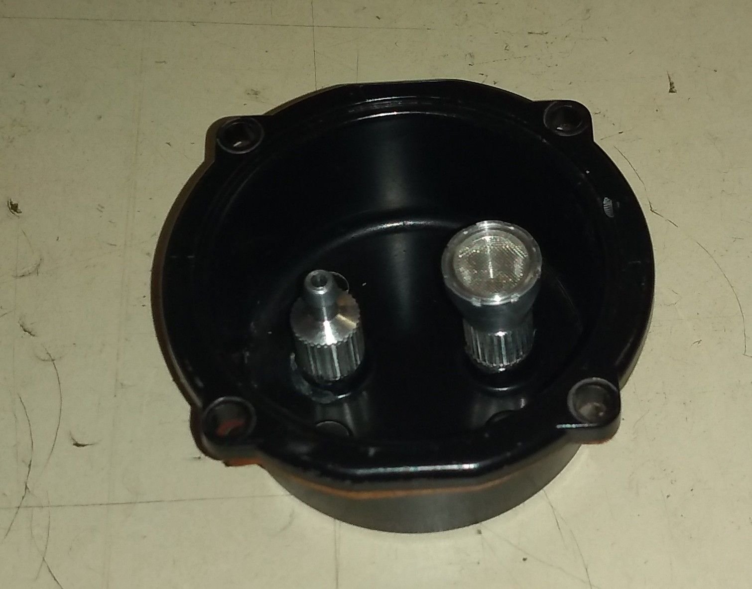

I'm curious what you fellas think about how using crankcase pressure to create tank pressure will affect engine lube. If I was using max tank pressure and regulating I wouldn't worry because of low flow, but I'm not. Whether I use the solenoid as a programmable air bleed or just use an open Tee fitting to bleed off pressure there will be a lot of waste air travelling out of the engine. I fear it will carry away the needed oil mist.
Here's the 220 back plate modded for using check valves. They both leak but that's not critical. Once installed I realized I may not need both checks, just one for checked air inlet. If I don't use an outlet check the crankcase would pull air in through the inlet check and the pressure line, reducing overall tank pressure and perhaps retaining more lube in the crankcase.
In order to set up this system to provide roughly 1 psi at wot I'll start and run the engine off of muffler pressure first while monitoring the checked crankcase output pressure. It should just be a matter of selecting the correct size orifice to bleed off excess pressure. The solenoid will be used for fueling as normal on this go around. If this works as good as muffler pressure the crap trap is history for $10, the cost of an inline check valve and a plastic tee fitting. I may need to add a remote needle to control bleed off pressure, or maybe a piece of brass tubing that can be crimped, not sure yet.
Here's my thinking; When using a fixed air bleed orifice (Tee'd into the pressure line), the more air volume pumped the higher the tank pressure will be. I'm not sure if the pressure rise with rpm will be linear or exponential, but I'm guessing exponential based on my muffler pressure tests.

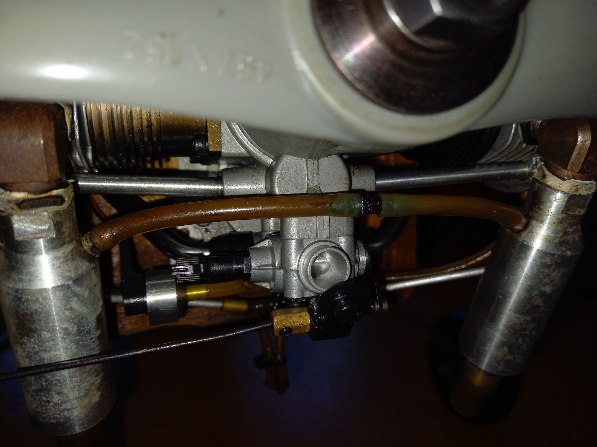

Meanwhile: How to do more of the same and still keep it somewhat "interesting":
Still a first and rough attempt, the OS/Graupner Wankel (Mk I) running on gas, with the electronic mixture control.
The changes are extremely remarkable:
-Barely any crud from the muffler anymore
-It appears to be quieter, which I think has to do with no more afterburning in the muffler.
-Fuel economy has improved by at least a factor 3 if not 4. I was really amazed that the same fuel tank that normally would be empty within 5~7 minutes even at mainly part load, now allready feeds the engine for 20 minutes at the same throttle regime, and at least 1.3rd still left.
-Idle and partload, no more fuel spray from the carb, and idle now happens at throttle openings as used from a normal reciprocating engine, instead of "half open and slobbering rich".
-Noticably lower running temperatures, at least at idle and part throttle, although I have not yet had the balls to keep it flat-out for prolonged periods of time, because lower than "searing hot" still is pretty hot. Yet, the cooling ring remained cooler, and it had all apearance that after reducing throttle, temperatures dropped quicker as well.
I tried to measure the "core temp" and the highest reading I could get was 148 deg C by IR-gun, at which temperature the engine did not show ANY signs of overheating, but yet... Brrrr,
But what is VERY noticable is the lower exhaust temperature at partload. I held my hand at 3"behind the tailpipe to see how much oil the engine is spewing, and that was no problem up to about 8K RPM.
It has all appearance that a wankel, just like so far all the engines I have done, needs time to "settle" on the changed lubricating conditions, because throughout the test the engine started to run better and wanted an ever so slightly leaner mixture.
