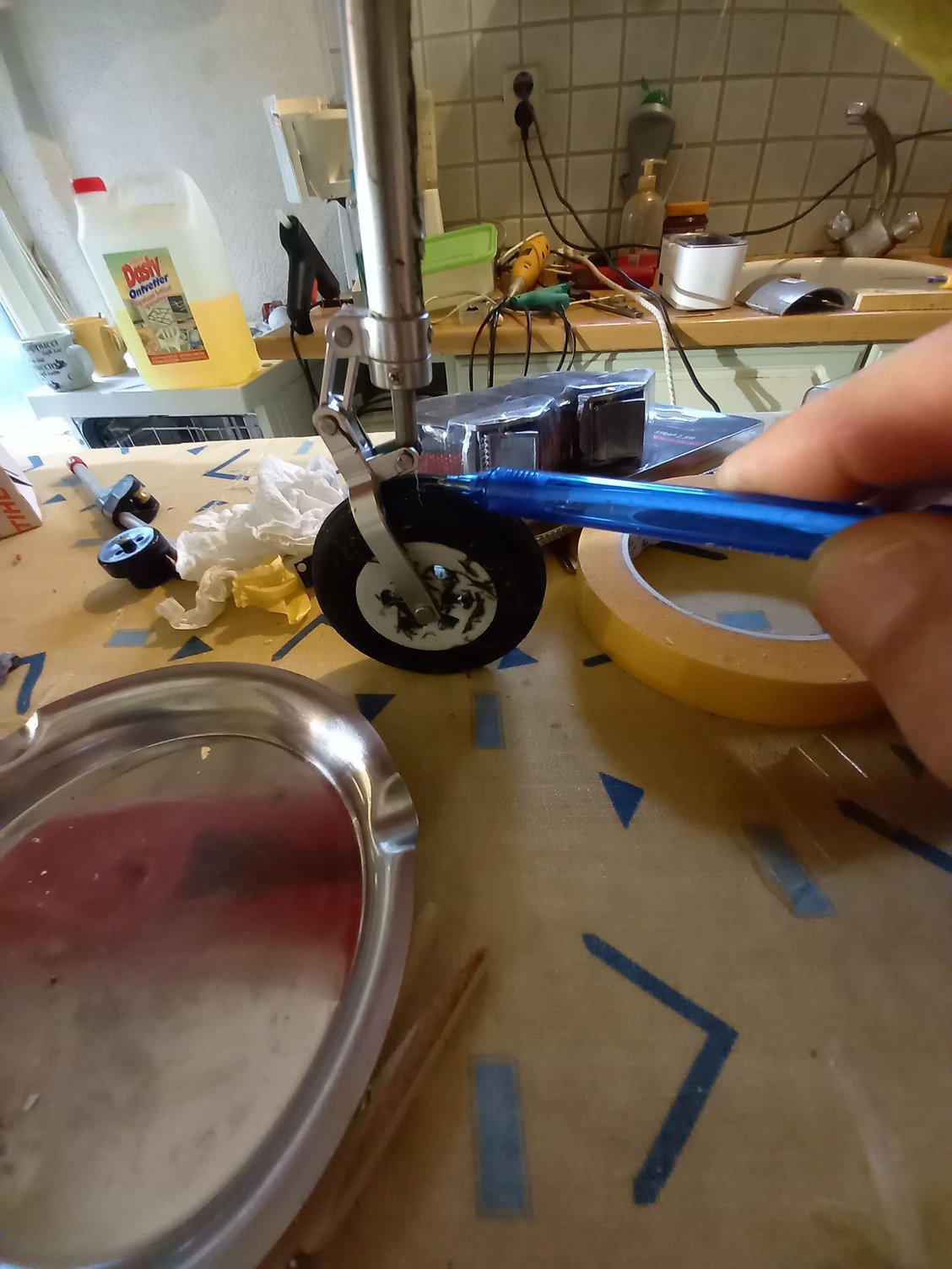

Well... the first attempt at a maiden failed due to a combination of freshly mown grass (lots of clippings) and too wet, making those clippings sticky.
What happened is that the grass collected in the swingarm of the nose gear, not only braking the wheel but also compressing the suspension. So the plane did 2 things: not gather much speed, AND the AoA (which on the ground is 3,5 degrees) reduced to about zero...
I need either a dry field or a paved runway.
On the upside: the plane tracks straight on the ground without even the slightest tendency to break either left or right, as long as the nose gear is not fully compressed, the suspension makes for a very smooth ride, and apparently the modifications I made to the airflow towards the engine made for good cooling, because the engine never overheated during the take off attempts and also not during the downwind return rides. It never came abouve 125 degC core temperature.
The engine also appears to handle well and fairly reliable.
Pretty happy about that, less happy about the grass issue...

Originally Posted by Cat 1
Its so close to going Bert... You could give it more nose up in the ground stance but that could make for a tricky takeoff even if it went off the grass as you would be leaving with lots of up elevator in a high drag condition. Better to find a field that offers less "resistance". It looks to have plenty of power for a delta and once it breaks ground I think you will have a winner. I love deltas and have flown quite a few. They are odd as they are a very efficient planform once "on the step" but sometimes its tricky to get them there. I have done a few models of the Iconic Canadian Avro Arrow. Most flew around at very low power settings once airborne but took a good push to get them going. Also be careful getting them too slow and getting the nose up as they can become unpredictable and hard to get "on the step" again. Your design, like a jet, lacks the low speed flow over the controls.
I am fairly sure it is not the stance, nor the resistance of the grass runway itself.
What happened is that huge lumps of wet grass clippings collected here:
Where I am pointing with the pen. That grass wedges itself between the wheel and the swingarm cantilever.
That causes a torque on the swingarm such that the spring compresses. A bit comparable with what shaft drive does on older motorcycles: Engine braking compresses the suspension there too.
If you watch the vid, a few seconds into the take-off rns you will suddenly see the nose bouncing. The field is not particularly bumpy there or anywhere else, so that is where the nose wheel bottoms out due to this grass collecting. By that time the stance has changed from 3,5 degrees to -0,9 degrees, and the thing sucks itself to the ground.
Without those clippings, OR when the field is dry, I am convinced it won't do that, maintain its stance and just take off. I was seeing about 15 m/s, and at this weight (2300) and wing area (about 46 square dm) that should fly. It does not even get light, so that's the nose dipping.

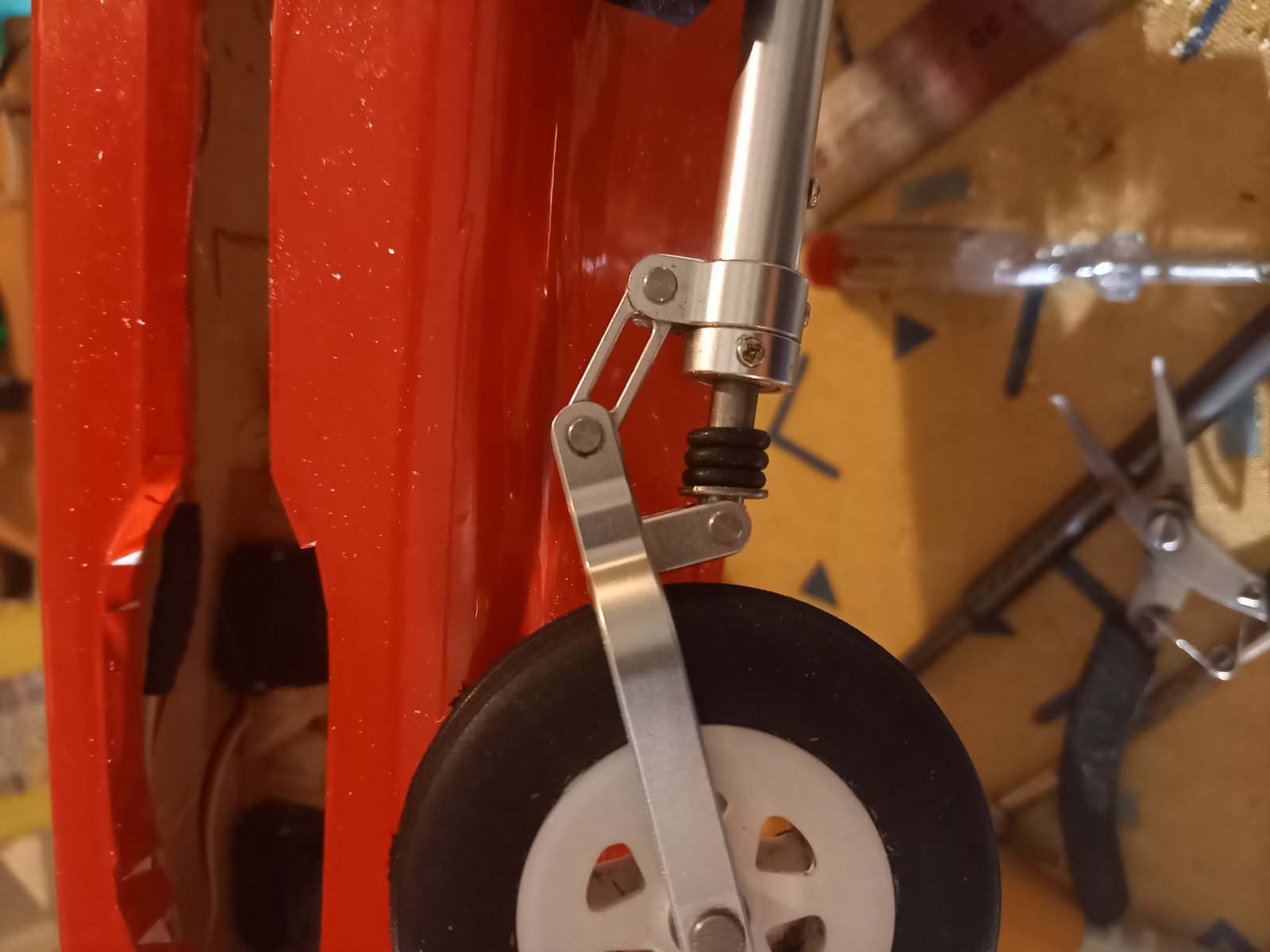

No doubt a paved runway would help with the legs "as is", but here's the nasty thing: that nose leg suspension ain't right.
The swingarm in extended position is near vertical, while the cantilever acting on the vertical spring is near horizontal.
Now when the plane rolls, due to this setup, the slightest bump will push the wheel backwards, compressing the spring.
This will bring the swingarm towards horizontal, but the cantilever towards vertical. This changes the springing geometry such, that the springforce is regressive instead of progressive. The further the suspension is compressed, the lower the returning force becomes.I tested this with weights, and at a given additional weight that will NOT compress the extended spring, when the nose is pushed down the spring will not return.
So when the plane rolls down the runway, the suspension compresses but won't come back.
For the maiden I improvised with a few tie-raps around the plunger, but that basically limited the spring travel "hard", which resulted in a bad landing.
So now I put a few O-rings around the spring plunger, that add a bump of additional springforce about halfway through the travel, and that should cure the issue.

Ahh yes I understand... Is it possible the model has a nose down stance when the model is static on the ground, it would have a negative wing incidence ... that would aggravate the issue, as the models ground speed increases so would the downward pressure on the nose gear... can you raise the nose stance so the wing has a positive incidence sitting on the ground?
***EDIT***
Never mind I just saw your photos of it sitting on the table, it looks like it has a good positive stance on the ground.
***EDIT***
That was actually the issue: Static, it stands 3,5 degrees positive. When rolling, the nose dips with increasiong speed until fully compressed at 0,9 degree negative: The nose (measured at the tip) dips almost 2,5" from full extended to full compressed nosegear. Those O-rings start interfering with spring stiffness at +2,6 degrees, so I have good hope the nose dipping will be limited to that.
Remember that geometry I was talking about? The first 3/4" of nose dip allready compresses the spring halfway through its travel. the remaining 1-3/4"of nose dip is spread over the remaining half of the spring travel, That is that change in leverage, and the spring being linear means that the resulting returnforce is not...
The issue is compounded by main gears with rather stiff springs and a rather progressive linkage.
To be honest, I think these legs are designed more for looks than for practicality.
