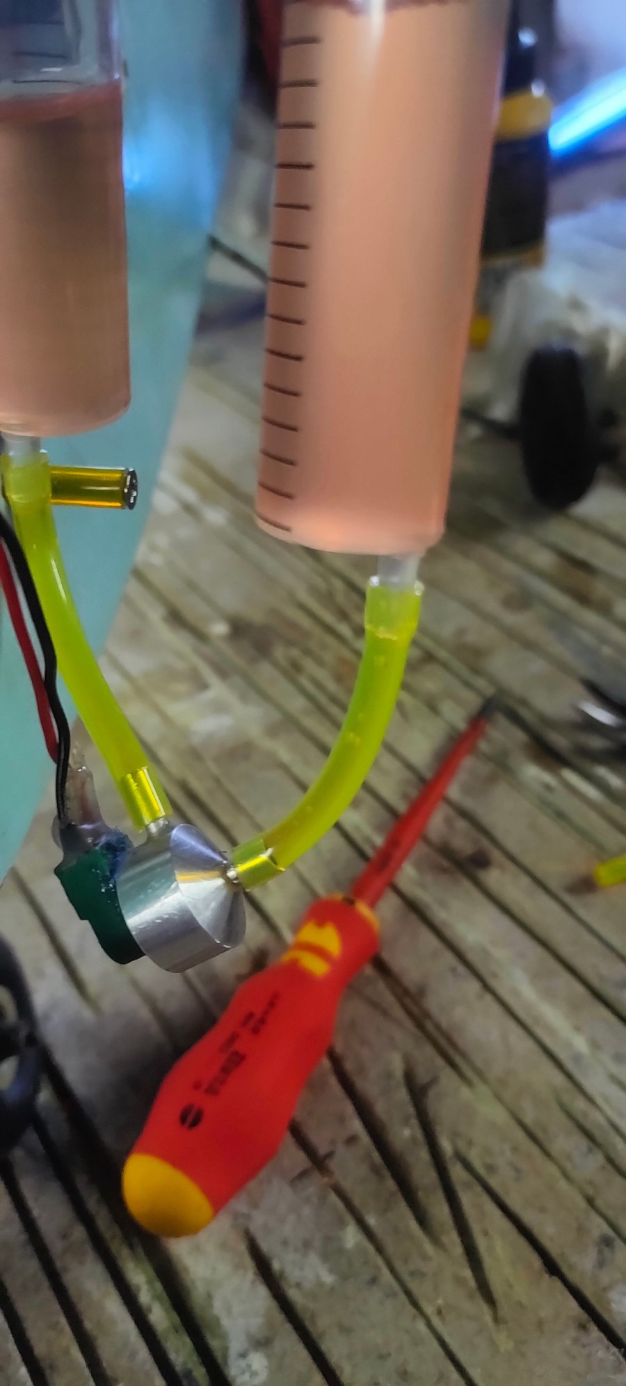

I tried with the "evaporated" gasoline, no change.
I did an other test without the valve in the fuel line, the engine run not bad, and stayed running a long time without cutoff :
I will do an other test with the valve connected to the fuel line but not electrically connected.
The aim is to identify if the problem is due to valve running or only by the housing cavity
#2184
That is dissapointing...
Please do this test with the LA, and then such, that the solenoid is BETWEEN the main needle and the carb.
For the purpose of this test it is acceptable to use longer tubing in order to get some distance between the solenoid and the engine.
The reason for doing it like this, is that with the solenoid unpowered, there is no pressure drop over the solenoid, instead the pressure drop is after the main needle.
IF the solenoid is leaking, but in the line before the main needle, there is no low-pressure, therefore also no bubbles.
With the solenoid, just for this test only, between needle and carb, the assembly will be subject to low pressure and any leakage will show.
IF leaking, there is the option of the solenoid being defective, or the housing can leak. The side tube (inlet) is glued in the housing, and there is despite my best efforts a possibility that this joint is leaking.
You can try sealing that joint by covering it all around with some Epoxy glue.
If the solenoid is defective, no other option for me than to send you a new one, but since I do this for zero profit, I would really like to be sure.
If you find the leak in the housing, I suggest you send that back to me, and I will exchange it without cost, but I like to have the housing in return so I can investigate and repair it.
I want to do my utmost to get you a working solution (and I am 100% convinced it WILL work, since I allready run gasoline now for 7 years and have never seen this issue) but as said, I do this for zero profit, I also would like to minimize my financial losses (no profit margin from which I can "buffer" these costs...).

I watched lot of your YouTube video this afternoon, and when I saw your first tests without the solenoid it gave me the idea to do the same thing and see what happens 😁😁
So, I come back from my bearing shop and they can order for next Monday a new o-ring for the valve.
I bought 3L of fresh 95E10 (for a test tomorrow).
I will do the modification on the 25LA than you advice me (solenoid off, between the needle and the carb).
If I find in my mess some pneumatic fittings, I will try to put under a small pressure the housing + solenoid, and hunt some leak in a cup of alcohol.
Don't be worried Bert, I will do all the possible test to check the integrity of the solenoid, and if there is an issue we will find a solution together, I know you spent already a lot of time for this gazer conversion and you don't benefits, and I really thank you for that! 👍
I will try to thinking to hold my phone in landscape for the next video, sorry I'm a YouTube noob 🤣🤣
Regarding the vibrations, I tried holding the solenoid by hand while it was running but it didn't change much, still bubbles.
I also thought about putting a piece of rubber between the engine and the chassis, but I'm not sure that a few millimeters of rubber significantly reduce the vibrations... What do you think?

EDIT: as an afterthought: you mentioned pneumatic testing. My request is to test under negative pressure, not positive. Sometimes, leaks along seals can have the character of a non-return valve. It is not unthinkable, that the leak opens up under negative pressure, but seals itself under positive pressure.
I did 6 tests:
- Fresh 95E10 only with solenoid off : no bubbles
- fresh 95E10 only with solenoid on : bubbles like engine running
- 95E10 with 10% oil with solenoid off : no bubbles
- 95E10 with 10% oil with solenoid on : bubbles like engine running
- water with solenoid off : no bubbles
- water with solenoid on : no bubbles
So, first it's not a problem of vibrations and no leaking from the valve, a good thing!
But it's an issue additionally create by the gasoline with volatile components + the shockwave create by the running of the valve + and maybe I think not enough back pressure from the exhaust to the tank (maybe my crap hose are too long? ~15cm?)
I think to the back pressure from the exhaust because when I push on the inlet syringe (outlet syringe is free for moving) I don't see any bubbles, so the under pressure from the carb could do a part of this issue.
And for the fresh 95E10 I can't do anything, and it probably the same than you or other guy.
If think to a solution? (Now I only see to try to do more pressure from the exhaust but I'm not sure how to do that...)

It looks like the fuel without oil gives bigger bubbles than the fuel with oil... Can you confirm that?
I know, oil has a stabilizing effect on gasoline (fuel mixed with oil can easily be kept for one year or more, fuel without oil can expire within 3 or 4 months). Which exact oil do you use?
There might be differences with different brands of oil. I have exclusively tested with Castrol PowerRS 2stroke (in some countries known as Castrol TTS), and so far I have never heard of issues with different brands of oil, but I also never have tested if oil brand makes a difference or not.
Another thing that CAN be of effect: How high is your fuel curve, and how far is the main needle open? A wide open main needle and the solenoid doing all the work, seems reasonable to think cavitation will be worse as well, because the pressure drop focusses on the solenoid. A low pressure zone combined with the stirring action of the rattling valve disk, is a rceipe for cavitation. With the needle doing most of the pressure drop, there is less deep low pressure zone on the solenoid, which thoretically SHOULD reduce cavitation.
Now that I think of it, I do remember, in the beginning of developing this system, I did encounter issues with "random wide needle opening" and tuning the engine only on the solenoid, and it worked much better when the main needle is opened no more than strictly necessary.
I normally tune the engine, with unplugged driver but the solenoid installed, to near max RPM on the needle at full throttle (like, the first click that gives a noticable RPM drop from max) and only then connect the solenoid and start acting on the curve. If I understood correct, you took the curves from Guillaume, and maybe because of that, the high speed needle setting is not optimal?
Mind you, this is NOT becaus there is anything wrong with Guillaumes curve, it is because fuel curves are not transferrable from one engine to another.
Exhaust pressure can be tested: With a proper adjusted (for max RPM), full throttle running engine, disconnecting th muffler pressure should result in an engine cutting out due to fuel starvation, and an engine tuned to max RPM without muffler pressure, should start running noticably richer when mufflerpressure is conncted.
I don't think the length of the mufflr pressure connection is an issue, I have planes with longr connections (up to 25 cm). But check if all nipples are open. Sometimes the nippl on the muffler is clogged up with burned oil from the time the engine still ran on methanol with castor oil.
Or maybe the craptrap leaks and the muffler pressure does not reach the fuel tank.
For short duration tests, you can connect muffler directly to the fuel tank. For permanent use, I strongly recommend to always use a craptrap, but of course, if the craptrap leaks, ther will be no pressure in the fuel tank.
