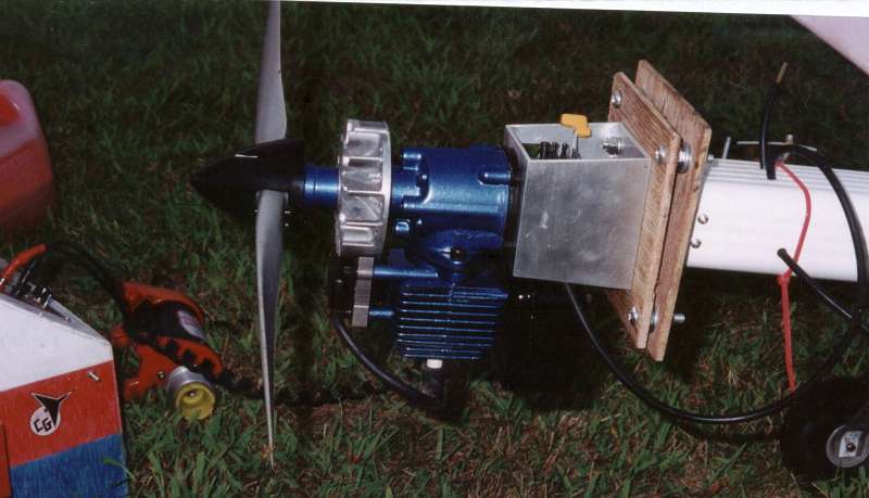

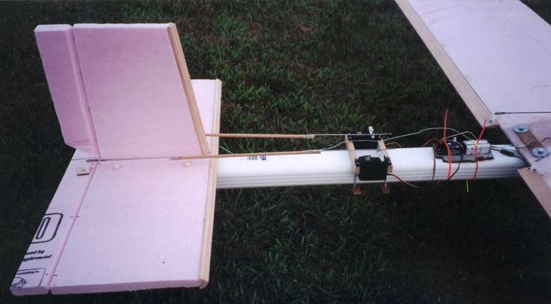

LOL. yep , we need something like AA for us. Well, I'm Mike and Im just a plain cheap a@@! Cant spend much anymore since the wife found about a dozen receipts and nearly went postal on me (sigh). So I no longer mess with my helis, cars(gas and electric), boats(same),all my glow airplane stuff and this R/C paperboy thing I was trying to perfect but nevermind that. So in trying to figure just how I could still get my fix and spend peanuts(no really, peanuts) I got into this conversion thing. BTW tom, I found my first ryobi in a dark alley, Im not proud of it but thats what happend. Ok, got a freebie ryobi, called in some favors, had it ready to fly a plane for $25 total. Now I needed a plane....Just how cheap can you build and finish and plane for a 31cc motor? $25! Yep, thats it. I call it my Pipe Dream. Go to Home Depot and buy the following:
PVC downspout 10' length makes two fuse's= $5.98
2" pink foam board 4x8 sheet=$14 but had a bad corner so I got it 1/2 off=$7..WOO HOO
3/8x1/2 hardwood spars=$3
and the rest of the cash went to nuts, bolts and rigging.
Sucker flys great! been flying all summer on it, even tought a few newbies how to fly with it. It has a 80" wing, 1200 sq in area and weighs in at a beefy 15lbs4oz but that ryobi hauls it straight up for a good ways. Piper

PS - Mr. Piper.......what a cheap/cool idea for an airplane. It is kind of a SPAD without the signboard. I love it! It is so ugly, it's pretty! LOL
It looks like the ultimate conversion test bed as well. You could come up with all sorts of comparisons between your Pipe Dream / Conversion combo and get a good idea just what airplane the engine is capable of flying. TOO COOL.
