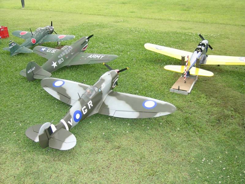

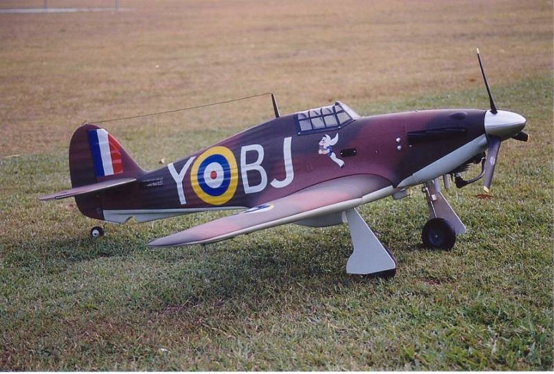

Hey Guys
Just thought I show you what my friend and I fly the 31cc Ryobi in. All 5 have Ryobi's.
CM Pro Zero, P-40E, Spitfire (repainted),
Great Planes PT-19 (84") and an ESM Hurricane.
All fly great,
Cheers KMM

KMM: All your planes look good. I like the one with the kinda purple color the most. Real sharp warbird. Best Regards Capt,n WEST MICH USA

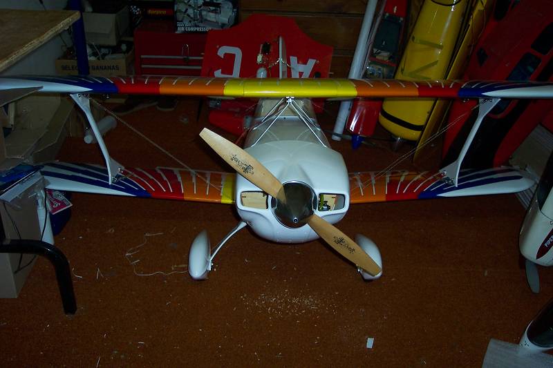

I've got a Homie 30cc in my Extreme Aircraft Cap 232 and a Homelite 33cc in a Kankge Rearwin Speedster. The Speedster flies great, very scale like. The cap is still on the bench. I'll let you know in a couple of weeks how it flies. I don't expect to be able to do 3D, but I think it will fly basic aerobatic manuvers.

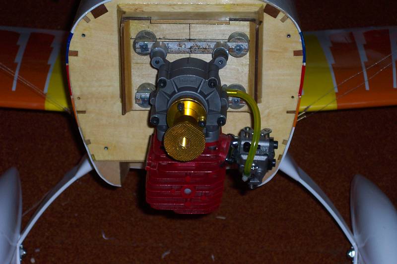

my conversion has generated a lot of positive and negative feedback lol. the engine is a CRRC Pro GF45i. it used to be a spark ignition engine. but as you can see from the photos ive converted it to run methanol and a glow plug. fuel is straight methanol/synthetic oil at 40:1. the carb has had no internal work other than removal of the filter screen and reseting of the needle valve arm. it is methanol compatable out of the box.
the adaptor is one that i machined up myself. i also know of another of these engines that has been converted as well....i sold him one of my adaptors!!!. performance is great...pulls like a train and a rock steady idle. it runs a 20x8 bolly carbon prop at 7800rpm all day everyday. it develops just over 12kg's of static thrust. airframe weighs 8kg's. we've worked out its making around 5.5hp in its current configuration.
airframe is a Pro Built Extra 300SP. 84" wingspan. it also has a smoke system installed. the whole package flies like a dream although im still learning with it lol.
cheers

hardtop: If methanol is cheap there....seems like a great idea to me. What do you see as a drawback? Thanks Capt,n
Old 12-29-2006 | 09:11 PM
  #66
Joined: Dec 2005
Posts: 264
From: rockhampton, AUSTRALIA
Default RE: What do you have your conversion in???
a drawback??......hhmmmmm
i havent personally run into any drawbacks with my engine so far. although i have had to give advice on one of these engines that refused to start....was found to be the internal needle valve arm set too low and so no fuel would flow. it now runs fine.
on the costs of fuel.......for me methanol is relatively cheap as i mix my own fuel and i can obtain it through my drag racing contacts. where i live petrol for a car costs more per litre than methanol.
another drawback ive seen is the unacceptance of running this fuel in a walbro carb. the general consensus seems to be that the methanol will "eat out" your carb. this is totally untrue. however....if you try to use nitro in the fuel THEN it WILL "eat" your pump valves and diaphragm very quickly. it is the nitro that causes the problems...not the methanol.
the only other drawback i see is the issue of obtaining an adaptor. while CH Ignitions do market these i found that at the time i needed one in a hurry and so i machined up my own.
while the above mentioned arent major drawbacks per say they are issues that can slow you down from completing your installation.
cheers
craig
