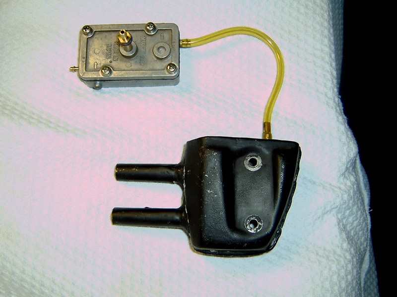

I make my mufflers either out of gutted stock mufflers, or out of steel. I really think the steel mufflers I make are about the same weight as the aluminum ones you buy because they are made of thinner stock. One of these days I'll do a weight comparison, but I don't feel like it now because the only "store bought" muffler I have is on my cowled, Ryobi powered, Tiger Moth. Don't feel like taking it all apart to weigh the muffler.

Actually I compared gutted stock with this alu piece and the weight is the same. I believe I can even make this gutted piece look nicer. It just doesn't have any exhaust tubes and that makes it very loud.
AV8TOR, show your steel mufflers, please.

Here's a few pics of mufflers I've made. The canister Pitts style muffler on my Katana took a bit to make, but everyone remarks on how it sounds just like a real airplane engine in the air. The Fokker muffler has a neat sound as well. Actually, I like the sound of all of them!!
AV8TOR
