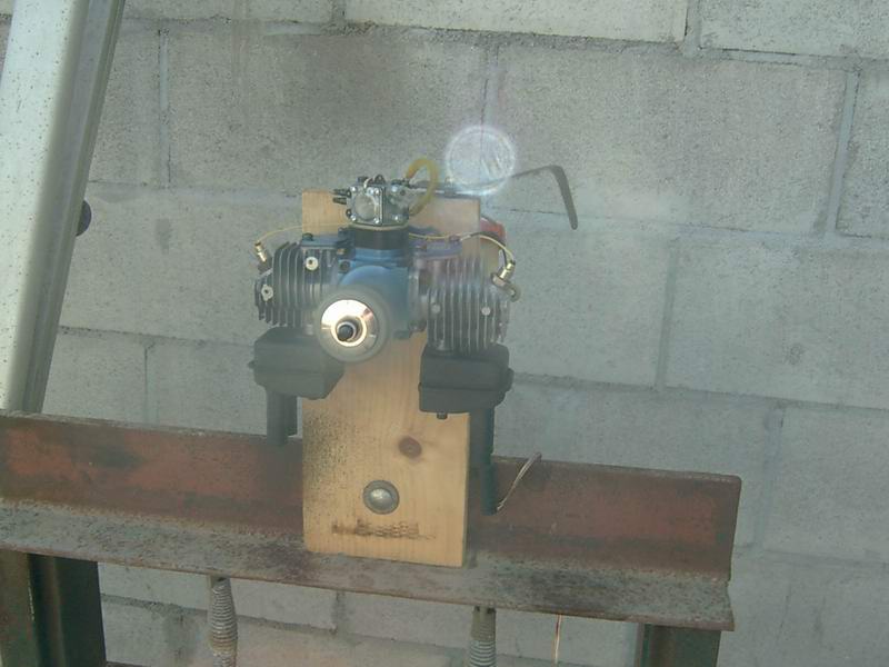

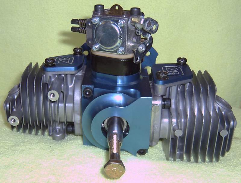

The Katana has the 23.6cc Echo that I did all the hop up mods to, including the stroker crank mod. Turns an APC 16 x 8 at over 9000 rpms. I don't think it will hover with that much pitch in the prop in this combo, but when I pull it to vertical it gets really small, very quickly...
The first post at the beginning of the previous page has info on the Super Tiger .90. It had been modified by Keith at BME to run on a regular gas/oil mix with roller bearings. I chose to run it on Gas/Glow. It runs and handles super, but see the post above for more info.
48cc twin? See here: http://www.rcuniverse.com/forum/m_5422664/tm.htm

Wait Wait Wait, you can't do that.
You have the twin all set up and you not going to mention the numbers.
At least talk about it a little.

Just finished making the mufflers and bolting it onto the test stand last evening. Might take it outside and start breaking it in today if I have the time.... Cool looking engine huh?
AV8TOR

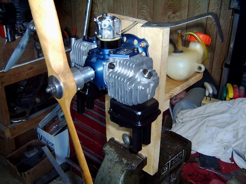

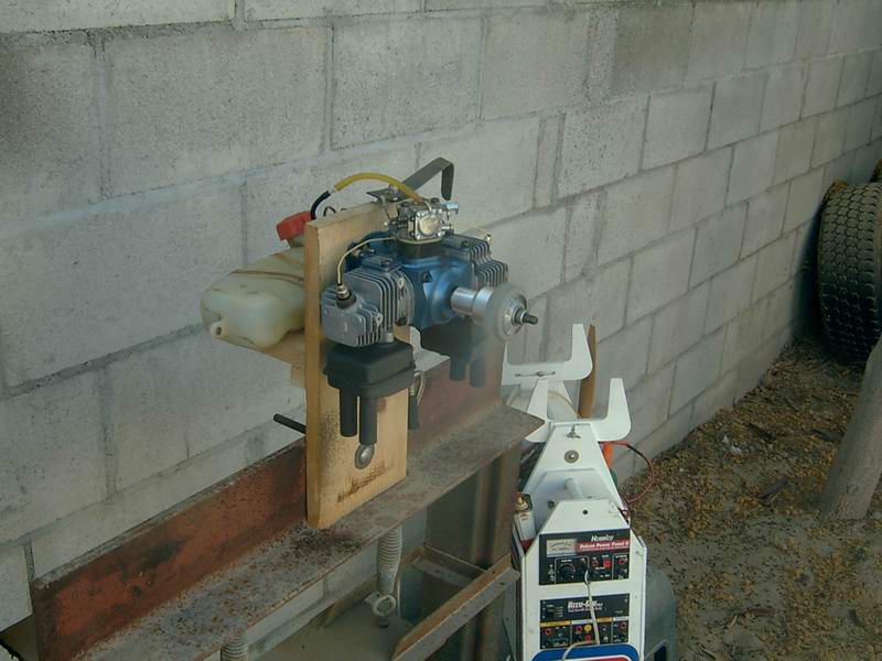

The older 23.6cc Echos had the larger ports. I believe they were made in the mid 90's.
Here's my new twin 23.6cc engine running 10 minutes ago.
Started on the third flip. Runs so smooth you can't even see the gasoline in the tank jiggle or feel any vibration at all on the test stand. It's only got 10 minutes on it, and no fine tuning, but already turns a big old 20 x 10 wide blade APC at 6500 rpms... After about 25 minutes of easy running, I shut it off, and it restarted on the second flip of the prop. Yep, I think I'm going to like this one!
I think I'm going to build another one with 25cc crankshafts, some port work..... oh boy, here we go again!
AV8TOR
