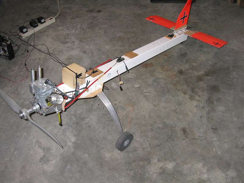

I just did a test run of a Poulan 42 conversion by Roy Scholl. Fired right up after priming. Timing at 28 BTDC and a Bambula 20x8 is giving 6700 rpm on an engine with a ways to go to be broke in. Stock carb, and I am wondering if it is too small from the way it is responding. Any body ran one with something other than stock?

I'm not sure on carb. I've just converted a poulan 46cc and i got around 7600 with stock muffler. I made a pitts muffler but have not tried it yet. What ignition is that your running on the motor?

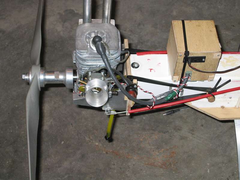

I ran a 46 on mag with some props but can't remember what the #s were now. I didn't have a muffler on the 42 durring this first run. Maybe that will improve the numbers some. I worked on a rotater manifold tonight. Almost have it finished. If you notice with the stock manifold the adjustments point at the prop and the throttle and choke isn't a straight shot either. Solving 2 problems at once.
The ignition is built by Roy also.
He did the ignition, hall setup with led indicator to show power, mounts, prop adapter and all. Nice work. Check out the size of the ignition box. That's a quarter setting on it! Magnet is a nice setup. Clamp ring on the hub. Just rotate it to where you need it and tighten it up.

Seems I was getting some where around 7000 with a couple of different 20x10 props on the 46. Can't say for sure though. I have another 46 like new waiting to be done. Think I will run it some more in the saw first. Also have another 42 converted in a plane. Will run it tomorrow maybe. If you notice on the test stand the carb is angled down. Another reason for the rotater manifold, to level it out. Doesn't prime at all hardly. Gas, like a lot of things, runs down hill, and out on the ground. This is something I noticed on my ZDZ 40. By holding the tail up, tail dragger, while priming it starts A LOT easier. The gas actually goes into the engine then. I wonder how many people don't realize this? Here are some pics of the 42 in the SPAD.

when rotated to topside needles the diaphram vent will be direct in prop wash. Check your rpms with a shield between prop and carb. Had one that did not want to turn up after rotating carb. Be interested to see if it affects your rpms

If you look close at the previous pics the diaphram vent is on top at the back. Air could blow over it, but not directly into it. Look at these pics, they are a little fuzzy. Got too close with the camera. With the rotater manifold I built the needles and idle adjustment are pointing up and the diaphram vent is on the back and bottom, though you can't see it.
It picked up a 100 rpm with the straight in manifold as opposed to the original angled one. 6800. Bambula 20x8. Put on a muffler and might have lost 25 to 50 rpm. Then tried a APC 20x10. Pulled 6400 rpm. The carb just started to need a little leaning out on the low side when I quit. Engine has a ways to go to settle in yet. Hope it picks up some then.

Eagle Flyer
The clouds lift and now it is clear. In third pic I mistook something brass colored to be linkage on back side. Oh well... no harm no foul.
