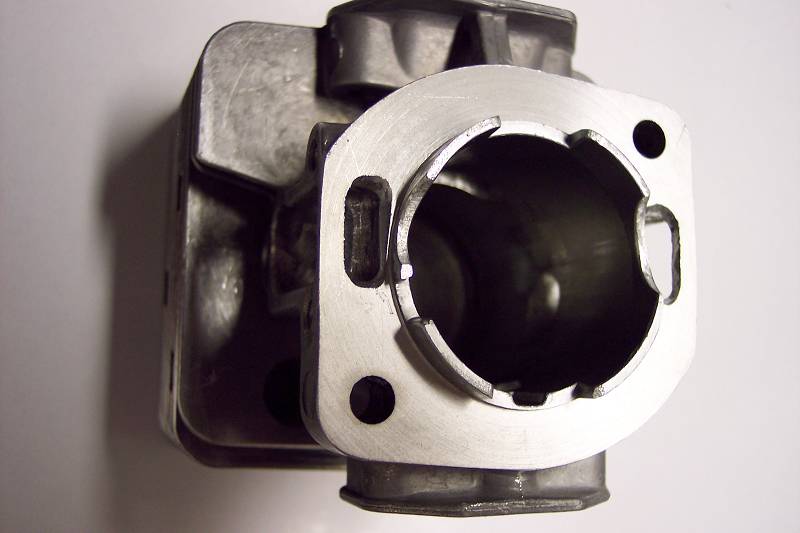

Hi Dave, I understand what you are saying. I realize it could actually help the engine run smoother. It also might not be necessary to remove as much material as you did, only running will tell. It doesn't look as you you have really weakened the piston. I don't quite have the nerve yet to repeat what you did, but I am working on a 2 bbl engine right now. I cut .020 from the bottom of the cylinder as I planned and while doing that I used your basic idea about reducing the restriction to the transfers by filing half circles in the bottom of the cylinder skirt that protrudes into the crankcase. I wanted to lower the directional intake ports with the .020 cylinder cut and while I was at it the "half circles" didn't seem like much of a risk. This engine is close to be done and usuable. I also cleaned up the carb port to suit a 1/2" bore in a carb spacer I intend to make for a Zama. Here is the photos.
Note: Removing .020" from the bottom of the cylinder turned out to be a bad idea. One thing I overlooked is a sort of a "cornice" because I don't really know what they call it around the top of the cylinder. This might be part of "squish band" idea for pollution or something at the top ring, but anyway after the .020" cut, the piston hit this rascal in the corner. I thought about trying to machine/remove it but this is just about out of the limits of my small Lathe. I am still adjusting the compression with two .010" and .005 paper gaskets. I increased the compression all right, but this is not the way. The stock gasket is about .020" thick (check it), so a thinner gasket is about what is practical, unless the top corner of the cylinder is machined away. Got you curious?, did you really take notice of it?, -- I didn't until the first bump. (I have thought about cutting a matching "L " cut in the top of the piston, and I might.)

I just got done test running my first 1bbl Toro. I did no porting except the exahust. I did nothing to the piston or the bottom of the cylender. I just wanted to see how they did like that. It did well. As well as my 2bbl engines. I got 8100 on an APC 16x8. 7500 on a Pro Zinger 18x6. And 6500 on a Zinger 20x6 (not a Pro). That is very good. For the hell of it I tried a 12x12 APC I had here. It turned it at 9800 ! I thought that was pretty funny. I had to lean it way out on the top end. No load. Not much for thrust but a top speed of 110+ MPH
Oh I forgot. These numbers were with a Pitts muffler I make and a 12.7mm carb. Same size carb as a G26.

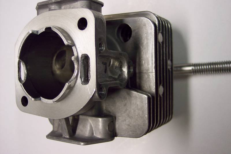

Wow, that's real good. I was thinking about the smaller transfer cross section of the 1bbl. The 1 bbl is more directional for better scavenging and chamber fill. The smaller cross section causes an increase in volocity which helps scavenging. How much did did you rise the exhust port? I think it is safe to rise it aout 1/16" (75 degrees BBDC). The intake is the same as a stock Homey 25cc at 60 degrees BTDC. It could go to 70 degrees BTDC with out problems by trimming the piston. I need to order a hub so I can test this thing. Scott, where do you get your baldridge hubs?

I actually don't go up at all. I just square off the port. If you look inside the port is V shaped on the bottom. I just square it off so it is even on the bottom. It is not much but it doies help. I am going to do some more mods on the nevt one. This one runs so good and has lightning fast responce so I am going to leave it as is.

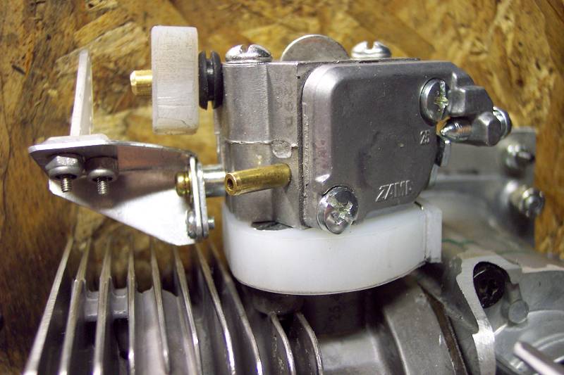

I don't use a mount. The back of the engine is perfect for mounting. The weight RTF on the engine I just did today (pictured) is 3 lbs 8.5oz. Less than a G26.

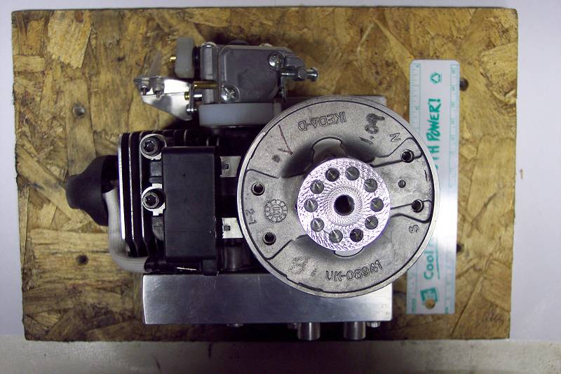

Balancing flywheels, now that can be a challenge. I have heard about balancing flywheels for years, but I never saw how anyone does it. (There must be electronic devices for this used by the big companys.) I decided to build my own balancer. I found some very small precision ball bearings with close to 1/8" I.D. (actually a hair less, metric?) and I used these. It actually works, I have balanced a few flywheels, but it is a tedious process where something like a crystal ball would also help. More than once it looked like "remove a little bit more about right here and that should do it", but it does something different than expected. Experience and learning when to leave well enough alone helps with this process. Sound familiar Scott? or do you have a majic wand for this?

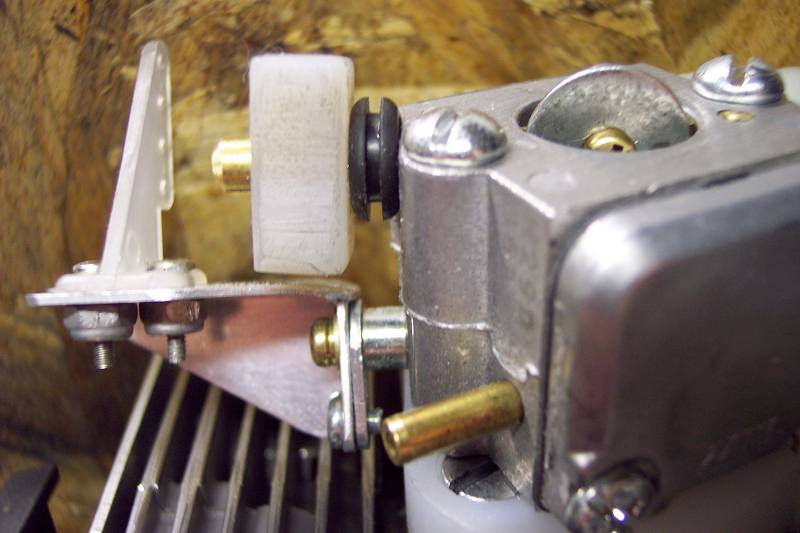

Your altitude is close enough to mine. I looked at the picture of the engine you just posted. One thing you are using that I haven't used on a Toro is a velocity stack, that could affect the results? I will check a few other props for operation, mainly as a curiosity, and I will use the Laser Tach when it gets here, it will no doubt give more precise readings than my Tachmaster. The bottom line is that when these engines are running well and producing power, you don't even need a Tach, except for testing like we are doing, because you can hear and feel the power. A stock trimmer engine sounds like a trimmer engine, but when modified and hopped up a bit, they start to sing like a glo engine. I know you have noticed this.

I use a Dubro prop ballancer. It is pretty acurate but not perfect. I get them close enough that it looks like the magnite is the only thing effecting it and not the weight. It is not perfect but very close. I need to replace the beams that hold up the balancer wheels with stainless or alluminum. That way the magnite will not effect the outcome. The Toro flywheels are pretty close anyway. I usually do not need to remove much.
The velocity stack is a good idea on any gas engine. When I put one on the toro I had to lean it quite a bit because all the gas wasn't being sucked out of the carb by the prop wash. Also it picked up 200 - 300 RPM. It doesn't effect all engines that much. But the toro it did. The muffler also helps alot. I used a 1/2 id single pipe before but now that I switched to a single 9/16 id pipe the RPM's are higher but the noise is the same.

I usually used a 11.11 mm carb on the Toro. A WA 58. I tried a 12.7 on the last one. There was no increase in top end power but the throttle responce seemed a little faster. I have a bunch of the 12.7mm from new Mac 38cc saws so I figured I would try them since i am now out of the new WA 58 carbs. I should never have sold any of them
