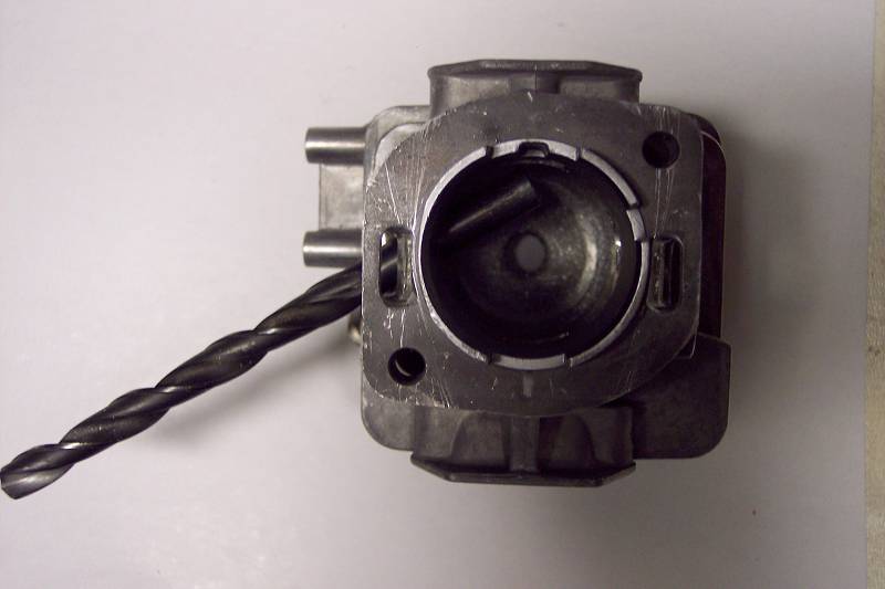

Here is a photo, it shows a 21/64" drill bit, as a gauge, in an intake port on the 2 bbl to show direction also. A 13/32" drill was used the same way on the intake manifold. You really couldn't drill the intake without ruining it. It has a countoured passage. The other photos should match the text in previous posts. Photos didn't upload. Will try again.
Important note: This drill size gauge idea turned out to probably be too large. When you look at the port with the top surface of the piston bisecting the diameter of the port, the top uncoverd half of the port looks really small and my drill gauge idea looks reasonable, but it seems that by me reffectively raising the intake ports, about .040" to maybe .060" (this is difficult to measure), I went to far and you can here this difference when you flip the prop. If you want to work a bit on these ports, I would suggest increasing the width a bit, but remember it is easy to go too far.
I am going to lower the cylinder around .020" of an inch to correct a bit of my excessiveness. The engine still runs well enough as it is, it idles well at 2k and has a top around 7500 plus. The next thing I am going to do with it is change the carb to a 2 needle Zama and forget the rotary Walbro, even though my "slotted" intake manifold did show some promise. We do need the reliability and adjustability of a 2 needle carb. A hint for working on ports with a file: fashion a piece of aluminum flashing 2" wide and about 3/4 of the cylinder diameter, to insert into the cylinder to protect the cylinder wall from the tip of the file. Clean up the edges of the flashing guard also. Without protection, you will probably scratch the cylinder wall.

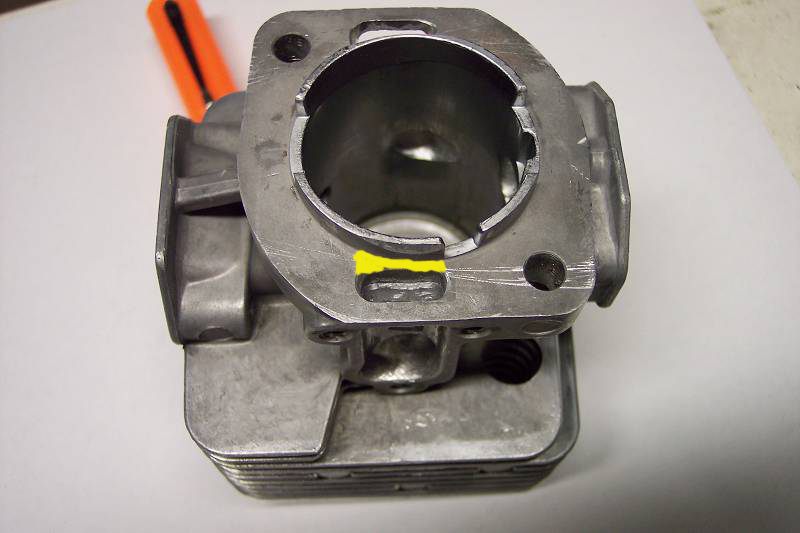

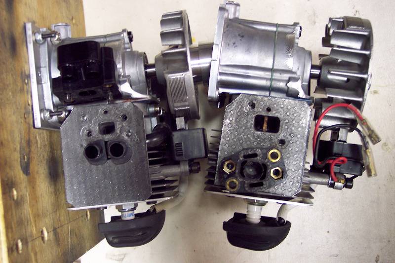

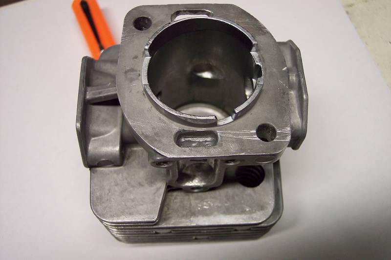

Photos uploaded, but I don't know to where? Computer said they were uploaded successfully? The second photo shows the bottom of a 2 bbl cylinder. The two openings on the sides are the transfers from the crankcase to the directional ports where the Reeds are also located. I see now that I can upload a few pictures at a time. the 2 bbl engine is verysuprising because the piston only uncovers 1/2 of the intake ports to take in the fuel charge. Now that I knew my modification of the 2 bbl intake worked, I went ahead and opened up the intake ports some more and I concentrated on the top side of the port that the piston uncovers. To look at these engines you would think the single bbl has more potential because of port sizes. I also guessed that the 2 bbl carb had more potential because the second barrel was only feeding the Reeds and probably had enough flow to add some to the primary port to the crankcase, it looks as though it does. There is no Sun out today for my Tack and I have to run some errands, but I am ready to test again. I will post the intake manifold photo etc. next.

You done good. I can see where these 2bbl engines have potential. I would like to get one to play with.

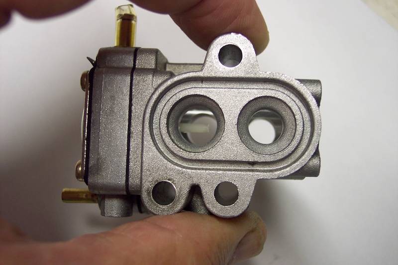

The 2bbl carb is what is working for me so far. I figured that the way it is designed, there is no adjusting of it except for idle, could be put to use. The secondary bore doesn't open until the primary is pretty far off the idle so I guessed it wouldn't flood and stumble and was worth trying. You don't know if something like this will work at all unless you try it. The carb is a Walbro and is not junky, so I wasn't going to just discard it. My original idea was a plate on top of a cut down intake, cut down 1/4", so I made a 1/4" cut down into the dividing web and could cut down the rest of it if it didn't work. This two barrel carb is fairly large, but it works well, and I am going to stick with it. I will post the photo of the modified carb intake /spacer for everyone to see, but I got to run now. I sent you the first photo by email as a test, did you get it? Added photo, 8-31-05
Note: This slotted intake idea did show some promise, until I went a bit further on opening up the intake ports. (I think that is what happened, but if you change a couple of things at a time as I probably did, even small changes, this can happen.) Sometimes it doesn't take much to skew your experimentation off the course you think you are on. I just want to point out that this has possibilities, but it is not 100% perfectly perfected.

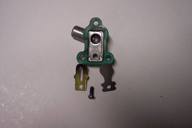

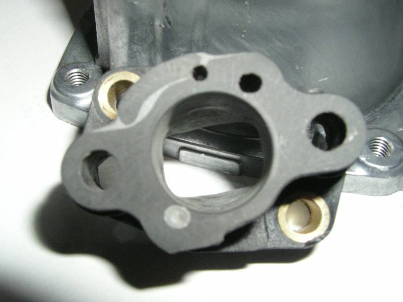

To continue with photos, here is a side by side of a stock 2 bbl manifold system and my modified intake spacer alongside an unmodified one. There is more of an increase in the bore size of my modified one than is apparent in the photo. the hole of the modified port is perpindicular wheras the unmodified one has a contoured bend shape to its bore. The size of the modified bore in the intake manifold limits how big you can go with the matching port in the engine. You can only go so big in the carb spacer and still get a gasket to work. The directional ports and the transfer passages need worked on also. I am ready to test the second enlarging of them. I now have them as large as they probably can go. I will get some photos of them also.

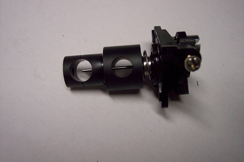

More photos. 2 bbl rotary barrel. I included my prop hub for size comparison. The hub is 1.5" long. The smaller section of the carb barrel is the primary and the larger diameter is the secondary. The needle going through it is not removable to modify this item and now I don't think it is necessary. I made the Prob Hub from Fortal, it is harder than 6061, which I wanted for the same reasons Rhysium stated. The rear of the hub has 8mm x1mm threads, 1/2" of them and the front of the hub, 1" long, has 5/16"x24TPI threads. These two thread are familiar enough looking that i didn't want to have prop bolts of both types and risk mixing them up. I use the 5/16x24 bolts on other engines also. This will keep it simpler at the field during a flying session. (I can screw up enough without adding possibilities, excuse the pun.)

If you look on the top of the carb. In the center you will see a small white plastic plug set inside the hole. Remove that plug and you can adjust the low end needle for a good low idle. I had one idleing very slow and reliably by doing that. The high speed on the other hand is a fixed jet. No way to adjust it. You can only drill it or change it. This will also work on the 1bbl models with the walbro WYJ carbs. Some have them instead of Zama carbs.

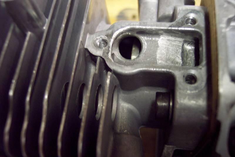

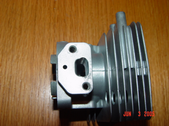

More photos. Cylinder with piston at BDC (bottom dead center) and you can see that it does not fully open the intake ports. Originally the top of the piston cut the port in about half, I now have enlarged the upper half. The second photo is the carb body, fingers for comparison. I have actually enlarged the upper half of the ports more than is shown here.

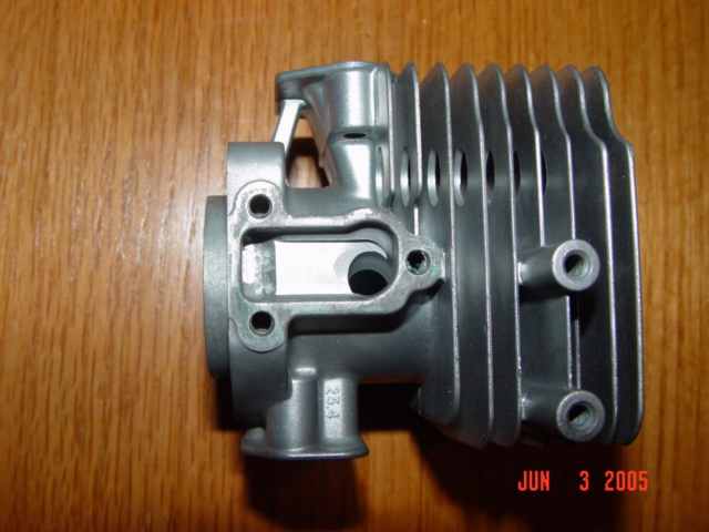

More photos. Intake port (with flashlight lighting) which can go larger than this if intake manifold was not a limit to it. Look familiar, Scott. The second shows opening to crankcase, that is all there is, two, and I worked these over as I am sure Scott does. This is what made me think about getting more use out of the intake tubing to the upper ports and the 2 bbl carb.

Here are a couple pis of what I did to the intake and boost ports. I close off the reed valve ports and make an intake to fit. I use 11mm carbs and run remote pulse. I deepen the boost ports and clean up the hole on the bottom like you did. I just mill the whole port almost 1/8" deeper. There is plenty of aluminum to work with there.

Actually the pictures I showed are of the first one I did. I now go larger on the intake port and deeper on the boost ports. The pictures shown are not the same as I do now. Just an idea of how i do them. I think the 1 bbl models may be easier to work with. I have 20 of them now i just bought so I will find out. The intake port is already massive so just the exahust will need some work. Also the bottom of the boost ports will bet some milling and the deck of the case to match the boost ports. I am also going to run a 12.7mm carb on them to see what a difference that makes.

I copied your picture of the bottom of the cylinder. I marked in yellow another thing you can do to make a little better flow. It is what i do. Cut the hole open right up to the cylinder wall. It will hurt nothing. I just use a dremel.

Great pictures. Making thr transfers deeper was the first thing that I thought of when I seen the picture of the 2bbl cylinder.
