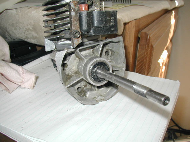

Joined: Apr 2004
Posts: 399
From: Republic,
WA
Your wish is my command. I have taken off the heavist part of the forward flange and trimmed the carb mount. I am pretty sure it a Ryobi as I bought the trimmer new and the box said Ryobi 31 CC. I used the Ryobi site to find the part number for the muffler and pulled up an assembly drawing that showed my engine. I think this is a cheap version made for the OEM trimmer makers. I just bought a Poulon Trimmer and it has the same engine. The part numbers match. Plus, it came apart exactly as I was told that it would which leads me to think we are on the right track. This is a single ring version and the barrel casting bears the number 028756. If it helps the flywheel was made in the USA.
I need to know how much more of the forward end I should remove. Should I take it down all the way back to the face of the block? I would leave some of the webs that support the forward main bearing and sealboss. The pictures I have seen show most of the belled area removed. It might be a pain to remove it all but I think I can get most of it off with the tools I have at hand, however I migh have to remove the barrel and piston to get it all. Any thoughts on this?
Joined: Aug 2003
Posts: 87
From: Springfield,
OR,
Thanks for the get back and the pictures. All I can say is WOW! What you have is what once was a 32cc Poulan/ Weedeater engine. They have been very similar for years with the Poulan perhaps being the better built but heavier of the two. Bigger bearings and crank pin with a real rod but smaller ports than the 31cc Ryobi"s. With all the merging and etc, that has been going on I can't keep up. The new Ryobi's are the old 30cc Homelite and so it goes......Just when I thought I knew it all!......Farley9n
