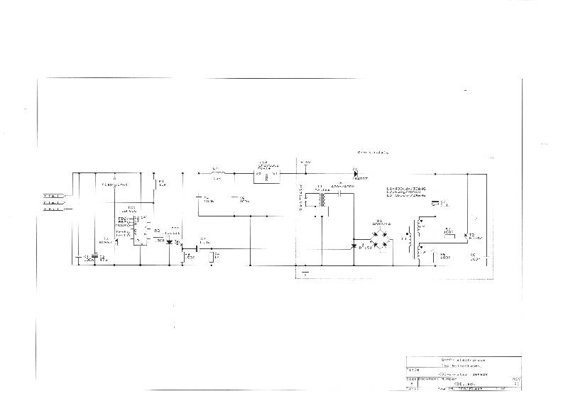

The problem can be a variable ignitiontime.
The ignitiontime must be exact and not *somewhere*.
By using two magnets, one for the ignition and one to filpback, maybe it will work.
BUT, the charge-time will be shorter, your missing the piece between the two magnets, and also the max-rpm will be lower.

The CDI can be used on any engine even on a 4 cilinder.....with a little help of a electronic/mechanic switch.
It doesn't matter if you generate a spark in the exhaustrotation, the petrol is all ready be burned.
You can also use a counter IC (CD4017) or flipflop who release the spark every second count.
I don't understand a coilsensor ?
A CDI need a exact ignitionpoint to spark, it's much faster then a normal pointswitch.
You can also use a opto-sensor with a black/white disk or a hole into a white the disk.
Something like this, only with one white line

ORIGINAL: Bigboat
Our HV-coil makes about 400 till 600 Volt, depent how the coil is wind and how the ocsilator is working.
Raisetime untill 150 Volt less than 3ms, 400 till 600 Volt within 3ms
#247
Joined: Dec 2005
Posts: 548
From: Alkmaar, NETHERLANDS
20ms = 50 Hz = 3000 RPM
2,9ms = ~350Hz = 21,000 RPM
The Voltage is also OK, it have to be between 400 and 600 Volt for a good spark.
