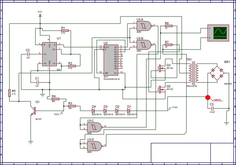

Hi, i have a problem, the IC IR2153 not exist in my country. I am designed this circuit ([link=http://www.wisnet.com.ar/cdi.JPG]My Circuit (IR2153)[/link]), i'ts correct??????, what is the frequency the IR2153???
Tnk's.

  #92
Joined: May 2004
Posts: 34
From: Laramie, WY
Default RE: Opensource CDI ignition
Hi javipallinux,
Here is a link to the datasheet.
[link]http://www.irf.com/product-info/datasheets/data/ir2153.pdf[/link]

Hi javipallinux,
This schematic will also transform the voltage up [link=http://www.uoguelph.ca/~antoon/circ/555dcac.html]NE555[/link]
BTW, wat is the reason to put the CDI on 12 Volt ?
Will you use it in a car ?
This circuit its for 125cc engine for racing (kart), and works with 12v 7A battery.
I see the schematics the ir2153, i do not deal the frequency the work
Please help me.
Tnk's.-

Why don't you use a *normal* CDI without a programble microprossesor ?
I don't think you need one, programble CDI's will only get more power and rpm's from a engine when this engine run on top off wat the engine can do.
A CDI without the a PIC can do the job for you, [link=http://www.modelbouw.gompy.net/ontsteking/schema1.gif]Example[/link]
This is a elctronic ignition, not using a micro at all [link=http://www.modelbouw.gompy.net/ontsteking/ontstek01a.gif]electroni-ignition[/link]
Last schematic will cleanup the spark and make it strong and allway on the right time.

Not it need whit programble microprossesor............. please tell me what is the frequency the IR2153

Depent of the rpm of your engine.
If your engine makes 5000 rpm, the IR2153 must ocsillate at least at 2500 puls/m on one of the outputpins.
The bridge makes two positives pulses from the output of the transformer to load the capacistor.
Every spark nead atleast 1 positive puls from the bridge to load this capacistor.
Better is to chose a 10x higher ocsillate of the IR2153

In the datasheet of ir2153 the frequency its calculated by Rt and Ct, according to the table with Rt=33K and Ct=1nF, the frequency its approximately 20Khz; it is correct????

Yes, follow the yellowline.
20.000Hz, 1nF, ~30kOhm.....30kOhm doesn't exist, next value = 33kOhm.
