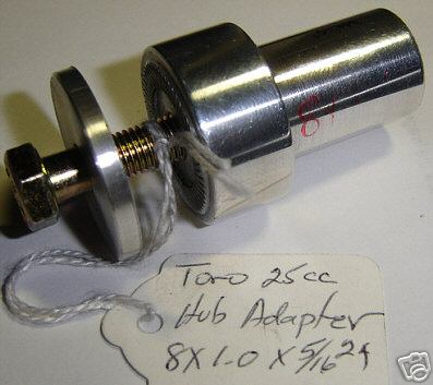

I am converting 4 Toro 25cc engines. I do not have a lathe, so I need to buy the prop hubs from someone.
On eBay i found this prop hub, but I am a little vorried if it has good enough contact with the flywheel.
The only part toching the flywheel is the back of the hub, but the diameter is rather small.
Has anyone tried this, and how do you make your hubs?

Looks to me like the thread on the crankshaft end is 8mmx1 and the prop bolt is 5/16-24. This set-up would be for electronic ignition as the flywheel is not used and the hub would screw on to the crankshaft. Of course the 8mm thread could be at the end of the shaft too. I make all my hubs to look like that but I do CH ignitions on all them. I just stripped a Toro 25 to start to convert so I have not measured the threads yet.

Topcat makes very nice hubs. They are knuled on both ends for tight fit. The well at the bottom of the flywheel allows omly a 7/8" diameter shank on the hub. Use blue or red locktite to secure hub. I use his hubs.

I make my own like that, but I mill 2 flats so I can use a 17mm spaner to tighten them onto the crank, and use loctite too. I guess you could also just tighten a prop onto the front and use the prop to tighten the hub onto the crank.

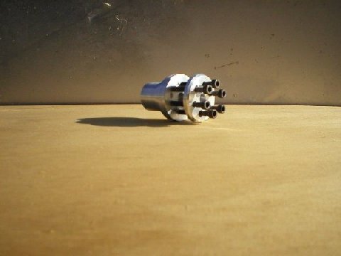

I used to buy a few from topcat myself.top notch.very good price.youll need to screw that onto the flywheel or like stated cut the flywheel center out.little locktite and a pipe wrench after a rag put around hub and its done.heres a pic of one of my 6 bolt hubs i make for WWI and golden age from my lathe i just purchased this year.

I fly mostly WW1 birds. That hub with the bolts looks good. I have gone to a scrap yard & picked up 1 in. alum. shaft about 1 foot long & cut my own. They have a tool to find the center of the shaft to drill & tap the hole.

Thats where i pick up my stock from.I just bought 2 peices,each 1 foot long.1 peice is 1.5 inches dia,the other one 1.75 dia.$10.00 for both peices.I have to go back and get some more because i cut them up for size already and im going to make one that fits all the way over the crank for an EI.I still have a couple of topcats.I to have 4 toros to convert yet.did one and sold it already.Im still getting used to my lathe yet but after i do a hub like the g23 well see.i just bought a boring bar also.I have a 80 inch sopwith triplane scratch built from jerry bates plans im restoring and have a 6 bolt hub on it.

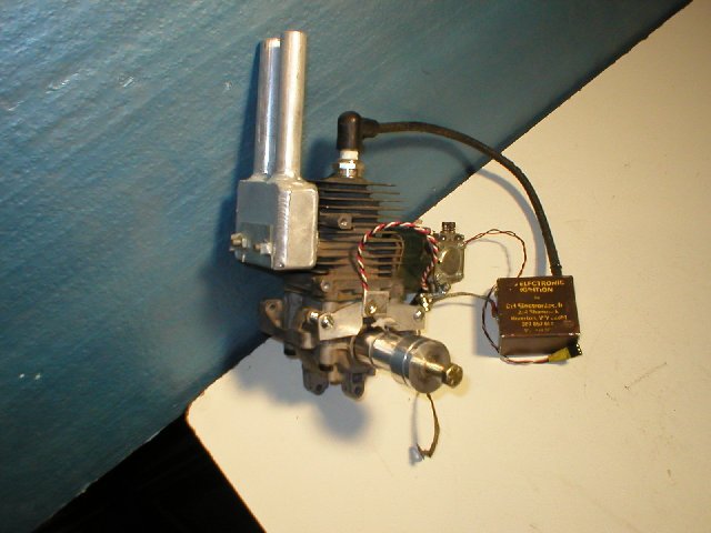

Heres 2 of my engines that ive recently done.The first one is the echo 23.6cc.all up RTF weight with prop,muff,ign,everything is 52ozs.the second onr is the stihl 27.2cc.All up weight RTF is the same as the echo.52ozs.I have a ch ign,no syncro on it.I have the stock carb on the echo i just havent changed it out to a 10mm yet,have to rebuild the carb or reset the needle and seat.Theres a thread started on the stihl 27cc with some rpm#s from mine.
