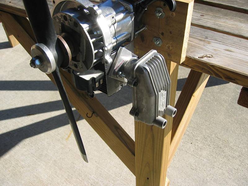

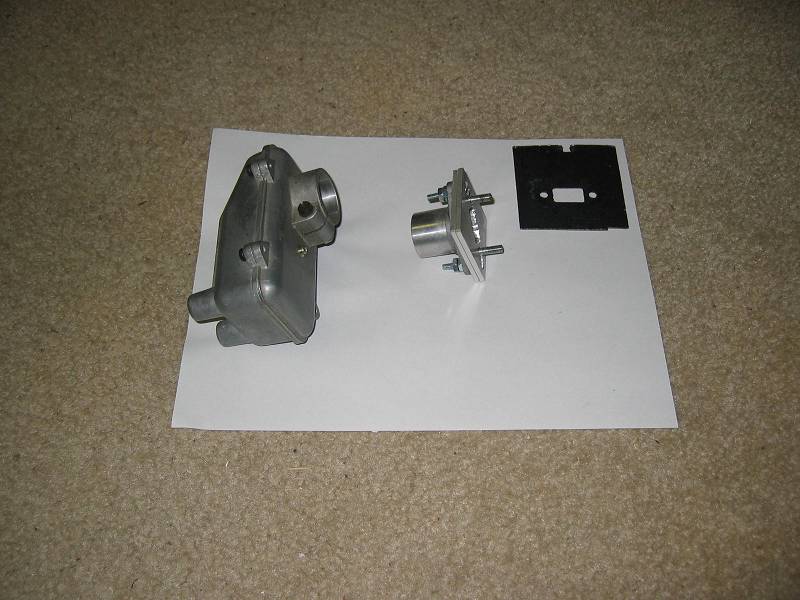

MB 290 25cc prop data.
16x8 MA 6500 ---- Box stock except for spark arrestor screen.
16x8 MA 6700/6800 ---- Remove exhaust deflector and packing in muffler.
16x8 MA 7300 ---- ST 2000 muffler.
It appears that most any exhaust change improves RPM considerably.
ST sure does make ugly mufflers. However the muffler to engine adaptor should work with a tuned pipe.
Bill

I got a chance to talk to the Pontoon boat builder today. We talked about building exhausts and selling them. A plane jane exhaust for a 25cc Mac or similar engine would be $16 plus shipping. Now on a more complex exhaust, the price may be around $25- $30 or more. We intend to cut the price of a $99 exhaust to about 1/2 of that or $50. This guys welding is top notch. Will be working more on this when we get back from vacation. May even have a webb-site someday. With converted engines. Best Regards Capt,n Added... Forgot to say....to keep price down , the buyer would have to in some cases supply us with the exact dimensions he wants the exhaust to be.

Captn’John,
I am ready for two mufflers.
There might be a method to make the mufflers somewhat universal fitting several engines and we should talk. ST and MB290 are very close and flipflop reports that the Evolution and G-26 are also close. One muffler might be made to fit five engines. I will also find out the spacing and dimensions of the Moki.
Most of us can take material off and drill holes but don’t have welding facilities. Often I have simply wanted a rectangular box closed on one end with outlet tubes on the other end.
Bill
