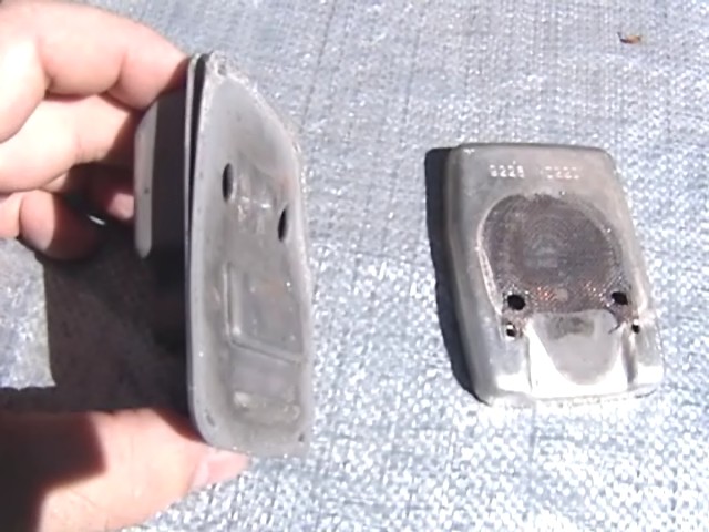

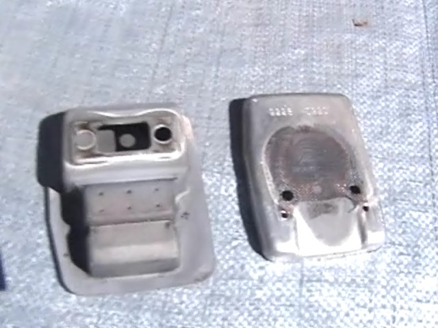

Just to try and help out with some new info....
I took my stock muffler, a hair over 8 oz. Slit it in half at the bent over flange, and seperated all the internals out..lots of junk in there..I cleaned everything and jb welded the two outer can halves back together , with the two standoffs, or tubes that keep the seal tight at the ehaust once installed..I didn't skimp on the jb weld..and I came out at just UNDER four ounces on stock muffler...man the original thing was heavy! Now I am no expert on whether the jb weld will hold, or what the rpm change will be. But I thought someone might be interested.. Unfortunately I am not sure when I will get this motor on a stand and propped..so I can't guarantee any running info in the near future..
hope this gets the ideas started though, anxious to hear some flight reports ..mine MIGHT be going on a 62 inch 3d profile...
I am definitely interested in your findings. Please keep us posted.
The original muffler appeared to be cross flow designed. Do you have any pictures of the inside?
Bill

Actually after reviewing what I did.. I may have used the original piece that fits the ehaust port, and an internal piece of the mufflr as the outboard section..I believe the screened part was the original outer piece? Sorry didn't take to many notes during the operation!
anyhow, here are a few pics (hopefully) i think my motor in this configuration weighs 3 pounds 10 ounce....
