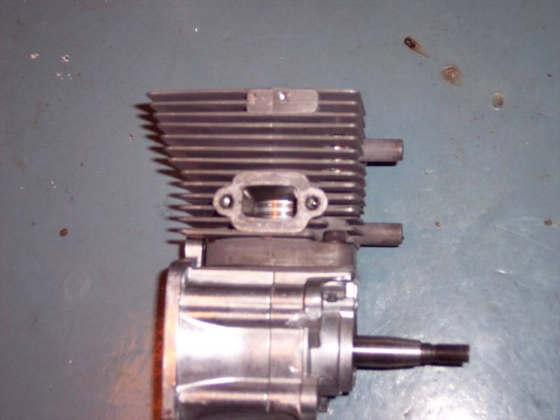

I have dismantled this engine far enough to do an evaluation.
It appears to be well constructed and very similar to a Kioritz. Two ring domed piston and what appears to be a plated cylinder. The porting is very mild but the exhaust flange is generous. The intake port is large but the manifold is only 10mm bore, the intake manifold is designed to be easily bored to 15mm and matched to the port. The carburetor is 13mm bore. The rings also appear to have some type plating, maybe moly. Finning is generous, much more than Kioritz. Extensive heat shielding is provided for the intended use. Compression is impressive for a 25cc engine.
The question I have is will MTD service these engines with parts or will they consider it a 'throw away' engine. The cost of the entire blower is less than a cylinder and piston for an Echo. Since I have several Echo engines, I may check if the parts will interchange. The manual shows all blower parts but only the complete engine so I assume parts will not be available. Blower model-MB290, engine assembly P/N 753-05005. Call 1-800-345-8746 for authorized U.S. service dealer.

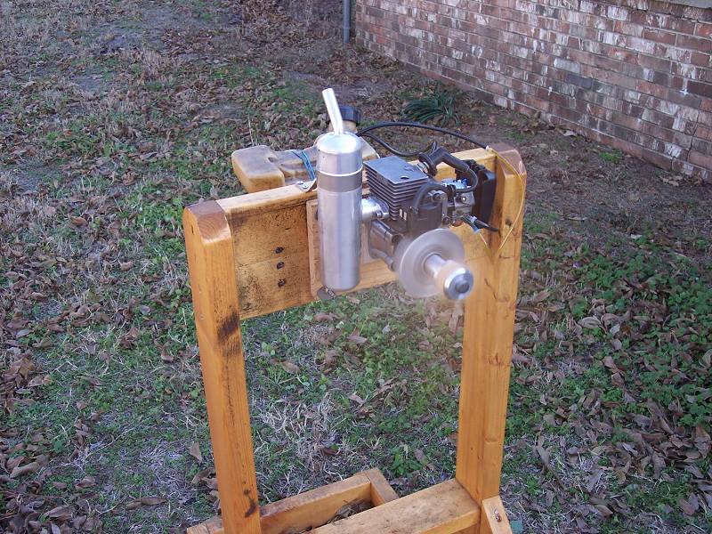

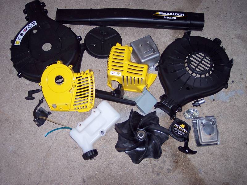

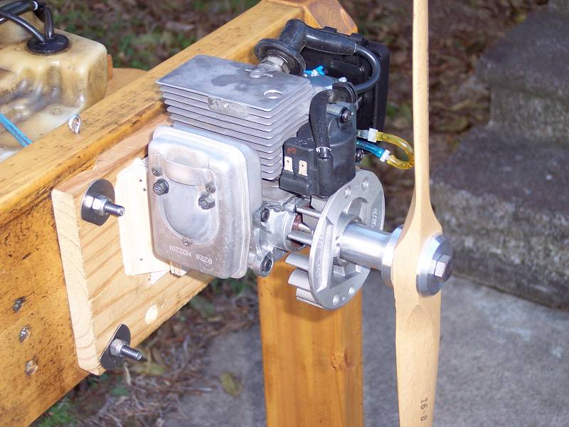

Ok,Ok, just trying to see if I could get you guys stirred up. I tried posting pictures last night but they wouldn't upload for some reason. I started converting mine late Saturday afternoon and finished it up yesterday. First shot shows the motor out of the blower and stripped of the bolt on items. Second shot shows how it looks after a couple minutes work with the bandsaw and about an hour with the Moto-Tool. 1 pound 11 ounces now. Third shot shows it on the test stand almost ready to go, completely stock. This completely stock idea turned out to cause me a couple of hours extra work to build a motor mount adapter that would fit my test stand (had to space it out so that long arm for the throttle would fit) Last shot shows it running with a Bambula 16x8. Now it weighs 3lbs 13oz with the stock muffler, carb and air cleaner. Pumped the primer bulb a few times until I saw the gas lines full, full choke it popped after 3 flips, half choke it started on the 6th flip. I ran about 3/4 tank of gas through the motor in the blower, so it still has a lot of breaking in to do. It turned the Bambula 7050rpm, sounded happy, and had very good throttle response. This motor should respond well to an aftermarket muffler as the stock muffler has the tiniest outlet I've ever seen on a gas motor (looks like a cross section of about 3 of your thumbnails stacked toether) I did slot the needle valves so I could adjust the carb, easy to do with a cut-off tool with your moto-tool. It will be sometime next weekend before I get a chance to try it with a different carb and muffler, it's dark when I get home from work ya know.

Here's 1

Two

three

four

Just getting the bugs out of computer. I could post on RCU it seems ,but did not get feedback. Hope I got her now. Man that sure is a nice looking engine NOW!!!!!! May buy another. My blower really picks up RPM if you jam the blow nozzel deep in hard snow. Really sounds good. Your RPM on that size prop sounds good also. Thanks Capt,n

I ran it some more today on a different muffler. A solid 7770rpm today. This is a Hatori heli muffler for the G-23 that I've had laying around for about 10 years. Large volume, a lot less restrictive, but still very quiet(wouldn't fit too well on most planes though). I knew this motor was going to respond to a muffler change, still on the stock carb and air filter. The stock carb is great for running on the test stand as you can put the throttle anywhere you want and it will hold that position. None of the B&B type mufflers that I have will bolt straight on, but anything designed for the G-23 can be made to fit with some moto-tool work (bolt hole spacing is a little less) I've got a heli header (that I've already modifed to fit) and V-Tech tuned muffler that should give a big boost in horsepower that I'm anxious to try after I get a little more run time on the motor.
Pics still won't upload, I've got to find out what the problem is.

muffler
