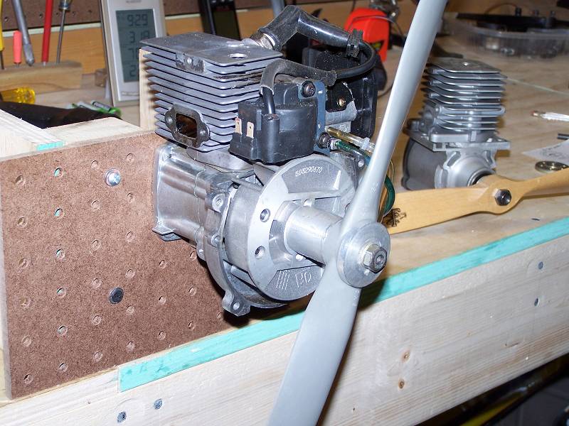

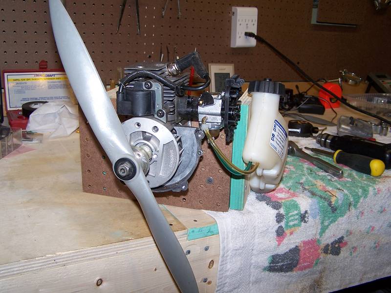

MB290 Here is what prop end looks like. I have installed the cmplete G38 prop hub. I do not like the way it seats against flywheel...but good enough for a test.

Isn't that coil setup for the engine to run clockwise ?
Old 03-16-2006 | 10:19 AM
  #110
Posts: 12,957
From: Hesperia Michigan, MI
Default RE: WHAT A DEAL
Antique: When I pull starter rope...engine turns in CCW direction. Should work. Remember the flywheel is backwards...not like most engines???? Whay do you think its the wrong direction!!!! Capt,n

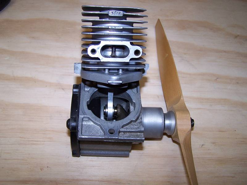

I disassembled my MB290 today. With the low airflow over the cooling fins when its in a blower, I plan on cutting the fins way down. It will never reach temp in an airplane, and I plan to use it in a sport plane without a cowl. I am also going to cut the case down and remove as much excess metal as possible. Hopefully reduce it a few ounces.
One thing is for sure, theres no shortage of screws holding that thing together.
How do you think this will work on an ultra stick 120?

I hope you realize that there is nothing holding the flywheel in place with the G-38 prop hub unless you've made some sort of spacer for the hub to bottom out against that we can't see in your picture.[sm=confused.gif]

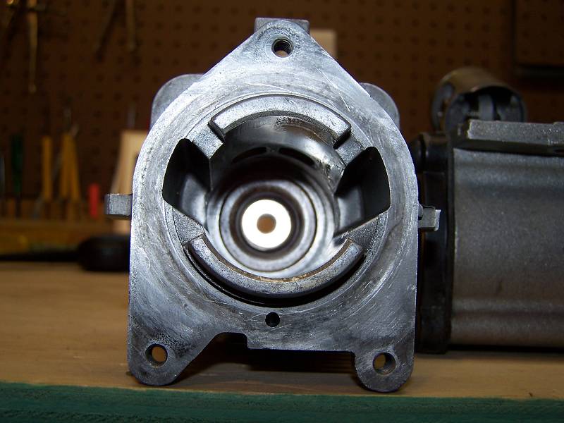

You are sure right flipflop! I am going to make aluminum apapter. Or cut the spacer that is on there to correct length. The G38 did not seat because od the 2 bosses there. Another fix would be...is to remove flywheel and mill the 2 bosses out of there. Sure wish I had a mill and lathe. I had the use off all that good stuff at work. Now retired...and got to get more tools to do this kind of stuff.[:-] Capt,n

Got MB290 going. One flip starts. Did 4 starts in a row. Sounds great. Will post photo later. Capt,n Edit to add photo...with new prop adapter I made. The engine has a real good transition and good idle. Never touched the mixture screws. Caps still covering adjusting screws. Regars Capt,n

sweet.. can't wait to get the engine going. I completely disassembled it and began removing the excess metal around the flywheel, cutting the cooling fins down, machined the intake manifold to the same size as the carb and removed the round tabs that dont let it completely flow.
Prior to disassembling the blower, I put about 12 tanks of fuel thru the motor. It looks great, completely clean and no carbon anywhere. Just a slight black oily coating in the exhaust port. I am running Mobil-1 MX2T synthetic. I am impressed by the quality of the motor. It appears to be very well built and the carb was perfectly tuned from the factory.
