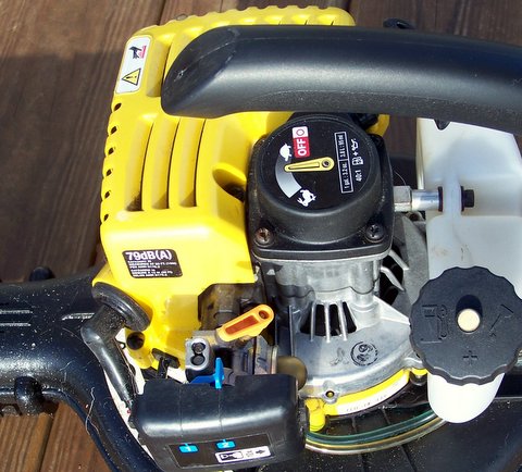

Old 02-08-2006 | 08:03 PM
  #68
Posts: 12,957
From: Hesperia Michigan, MI
Default RE: WHAT A DEAL
Here is a photo of the MB290 Blower.

mangolo: How are you doing on your MB290 engine? I cannot find a list of internal parts. I even contacted the company. No engine parts available. Will keep searching for more on parts interchange with other engines like it. Capt,n

Curiosity got the best of me and I bought one of these. Its looks like a great little engine that may give the Toro 25 a run for the money.
The shaft threads are 5/16-24, the same as the Homelite threads so a prop adapter made for a Homelite 25 would work just fine. The mufflers are different though but Scott Ellingson (poco242) can make you a muffler for it. I gave this engine to him to play with.
Old 02-24-2006 | 07:32 PM
  #74
Posts: 424
From: Naples, TX
Actually, the thread size is 8mm x 1.00 pitch. I just double checked to make sure. A 5/16 will screw on a couple of turns before it starts to bind though.
