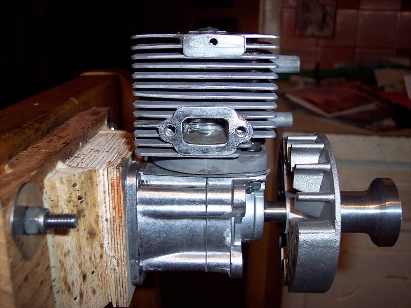

Just ran it with a Wacker muffler for the Poulan 25, rpm was the same as yesterday with the heli muffler with a LOT more noise[]
Next weekend I'll try a bigger carb and maybe the V-tech. NOPE, not in the same power class as the G-26, but for the $64.91 I have invested in it so far, it's a GREAT little motor.

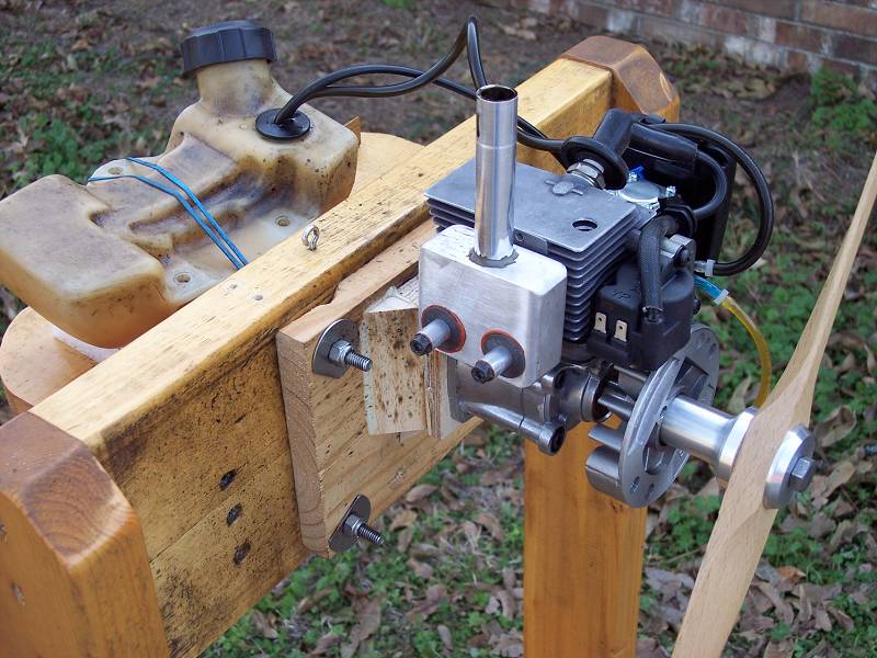

Well, since the Cowboys are playing so badly, I went ahead and tried the V-tech. 7860rpm now. Not as big a boost as I was expecting. I think the small stock carb is holding it back now. Having fun though, will find out more next weekend.

If you haven't bored the manifold to match the carb, that is a problem. The manifold as cast has only a 10mm bore and the throttle plate is 14mm. The manifold is designed to be bored out. The venturi is larger than the manifold bore. Just bore deep enough to remove the built-in restrictor and blend in to the main body. The manifold matches the intake port well.

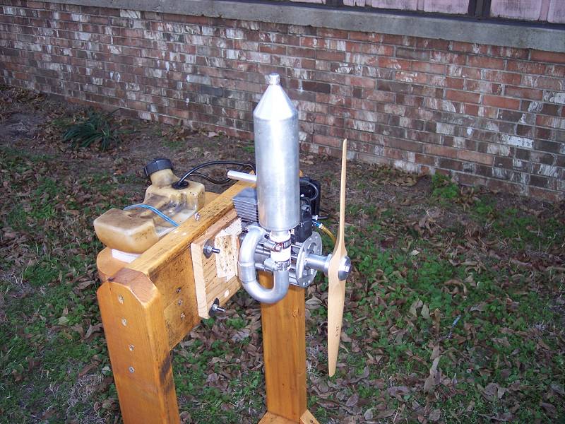

Back again... todays testing was done with a G-23 carb adapter, one of the 11mm Walbros I got from Scott Ellingson and the Wacker muffler. I had the G-23 carb adapter laying around and it perfectly with just a tiny bit of port matching (or Moto-tooling, whatever you want to call it) I wanted to keep the stock adapter unmodified so I could go back and do some more testing with the stock intake. The Bambula 16x8, Pro Zinger 16x8, and APC 16x8 all turned right around 7860rpm. Rats, I was wanting to see over 8000 so I tried a MA 16x6,8100rpm and an APC 17x6 turned 8010rpm. Nice.... but again, I was expecting a little bit more. OK, it's time to get serious. Out comes the degree wheel so I can find out exactly what is going on. Stock intake duration is 127*, that's not too bad. But the stock exhaust duration is a horsepower squashing 122*. Ugh... got to fix that. Milled the exhaust port, moto-tooled the intake. Now the intake is at 134* and the exhaust is at 153*. Went ahead and removed some of the fins on the back of the cylinder while I was at it. With Christmas and all I don't know yet if I'll get the chance to run it tomorrow or not.
