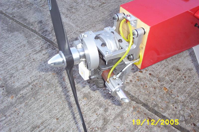

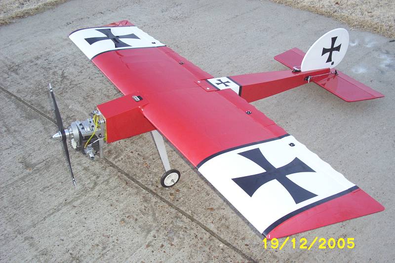

Here are a few pics of my Great Planes Giant Big Stik. I have installed a Mac 38cc conversion engine I got from Scott Ellingson at Brielli Engines. The Mac swings a Dynaflite 18x6 prop at 8000+ RPM. The plane weighs 13.5lbs dry. With a span of 80.5" and a wing area of 1520 sq in I should have more than enough power to do some good sport flying. The Mac 38cc engine weighed 4lbs 5oz.

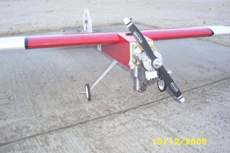

Looks like fun, I second the keeping us informed. Just took a look at the landing gear, http://www2.towerhobbies.com/cgi-bin...&I=LXKJY4&P=RF
They omit the measurement centerline axle to top mount surface, could you furnish?
Wheel size? and prop clearance for 18" prop with level fuselage?

The ground clearance of the Dyanflite 18x6 prop is only 1" or so. To get that I did not use the wheels that came with the Giant Big stik, but opted to use some 4" WW1 wheels I had from and earlier project. That gave me the ground clearance I needed to use a 18" prop. I like tail dragger's so I built mine that way. You wanted to know about ground clearance with a level fuselage. I believe you must be talking about a trike site up with this plane. If you want to use a tricycle landing gear setup with an 18" prop I am sure you would need larger wheels than the ones that come with the plane.
The note on Tower Hobbies is correct. The cg and servo throws in the manual are wrong. I used the suggested ones that came with the little addendum card in the kit.

the measurement: centerline axle to top mount surface, could you furnish?
The pic shows the referred to measurement.
I agree with the trike gear comment. I understand that with 4" wheels using the 18" prop you have 1" prop clearance when the tail has lifted off during takeoff run before liftoff.

No I have not flown it yet. I started having engine problems with getting it to start. I called Scott Ellingson about it and he said the Mac 38 needs to spin at 1400RPM to start. The best I could get out of my Craftsman 18v drill was 900 RPM with a fully charge battery. Scott said I was doing everything right and wanted me to send him the engine. When Scott got the engine he tested it and he was right. Scott has a makitta drill than spins over 1400RPM and the motor started right up. I talked to Scott about this and he has taken it back in trade and with a little extra he is making me a MAC 42cc with EI ignition conversion. This Mac 42cc is really a Poulan 42cc and will have more power and weigh less. I am waiting to get the new engine back from Scott and will be testing it soon.

I also have learned the hard way with regards to these mac 38's I had the self same issues with a powercraft chainsaw which is a carbon copy of the mac 38 chainsaw except they were blue in colour (see photo) I found I could only start mine with a 240v ac domestic drill with a modified starter rubber. bit of a bummer unless the local flying field has a mains supply right next to take off[&o][&o] and here is a piccy of the converted engine its dimensions are excellent but this getting to spin in excess of 1400 rpm is a bit of a bummer....well it is for us in blighty never mind I'll keep looking for engines to mod
