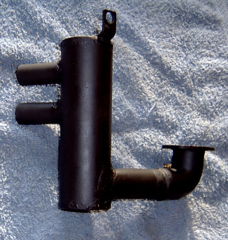

Hi,
A baffle is a device inside the muffler to help cut down noise. What you want to do is completely "gut" the muffler. Open it up and take out anything and everything in there except for the two pieces of tubing that the bolts go through. These keep the muffler from collapsing when you tighten the bolts. Then put it back together, drill two holes for your outlet tubes, and braze or silver solder the outlet tubes in. Here's a couple of pics. The last one is a custom muffler I built for my Katana.

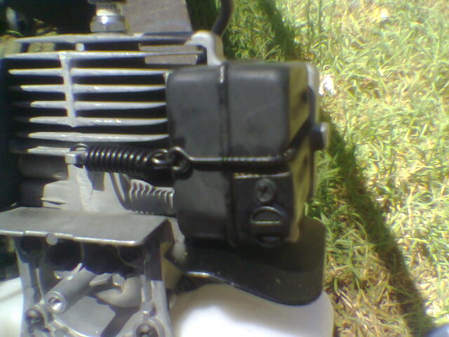

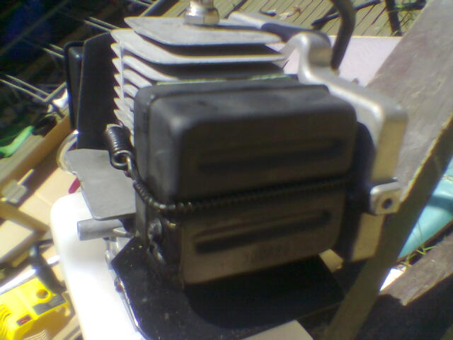

here are some pics of the muffler in question ... its not held on with bolts, but instead its that wire and spring that runs around it.
when i pull it apart i take out a plat and a tube is this rite? then im going 2 add two 1/2inch tubes at 2inches long each. is this also rite?

Old 01-12-2006 | 10:16 PM
av8tor1977's Avatar
Joined: May 2003
Posts: 7,245
Received 6 Likes on 5 Posts
From: Tucson, AZ
Default RE: stock mufflers
In your case there probably aren't any tubes inside to worry about, but just take out anything you find inside. You want just the empty shell. Then yes, just braze or silver solder two 1/2" tubes in for exits.

Looks like a McCulloch 28/32 engine
Get rid of the screen
