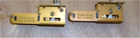

Big thanks goes out to Boxcar. He saw this thread and had pity on me about the retracts. Sold me enough air retracts to keep 3 giant scale warbirds flying at a price I could handle.
Will post flight report when I get these Spring Airs/Robart struts installed. Thanks Ken !!
Jim,, glad your getting faster speeds with the 16x8. I went back to the 17x6 and seem to have better slow speed thrust and control now. I bet we both start getting better runs after a few more gallons of fuel.

Flew the Spitfire with the new retracts in high wind conditions yesterday. The GT25cc powered Spit cuts through the winds with no problem. And the retracts/struts held up very nicely.
