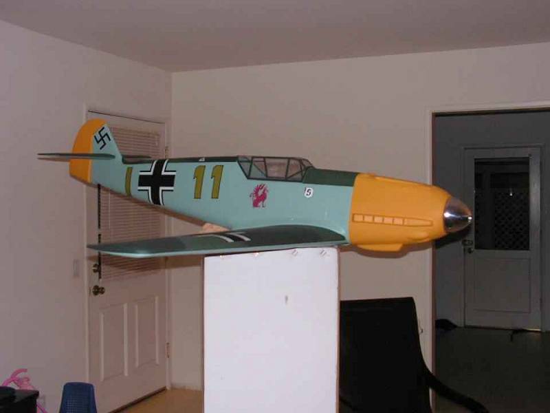

I used dowl rods , sanded for the thrust and drilled them for the bolts. Then painted them in Olive drab fuel proof paint. (Third photo in my first post.)
Scott has contacted me about custom building a scale wrap around muffler and velocity stack if I wanted to order a new cowling to dress it up. I admit the old cowling has been hacked to death and I chose to cut out the muffler area as well. It would have been in contact with the hot muffler and burned anyway.
I'm going to see how it flys and then decide if I want to mess with more scale details on a less than scale warbird. I'm now looking at the KMP Me109-E ARF as a next scale flyer. Scott already has a Brillelli in mind for that one too. It will have all the fancy custom exhaust piping and possibly custom scale air intakes instead of a big stack sticking out of the carb.
I will probably have the ARF shipped to Scott first and let him mull over it for as long as he needs to. (Scott doesn't know it yet though. lol) Then I might just get my 109 with a gasser already installed with the mods and cowling done. (If he has the time that is. He's a busy guy.)
"Photo of KMP 109 is from the Warbirds section and belongs to a fellow RCU member."

Sturtz, The wire that comes off the engine for the EI, what type of connector is that? What will it fit. I run Airtronics "Z" and Hitec. What size fuel line fits the engine best? The local hobby shop here doesn't carry gas fuel line in stock. Get a video of your plane when you fly it and post it.
My Feedback: (20)
Joined: Sep 2004
Posts: 1,537
From: El Reno,
OK
The EI plug to the engine is simply a connector ring type to use with one of the head bolts.
I'm using a clear gas tubing I purchased from Scott. It fits over standard glow tubing but needs to be secured. I'm using small zip ties inside and out of the fuel tank. The fuel tank's stopper must be for gas only as well.
