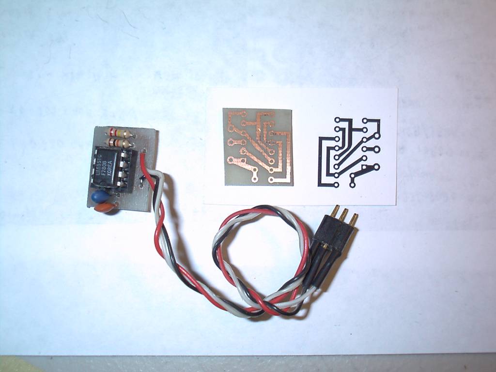

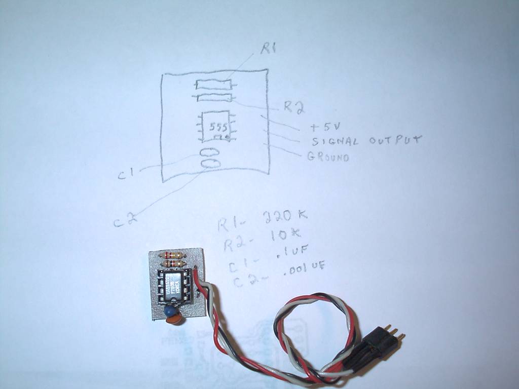

Brett..that tester for ignitions I make here...555 timer chip 2 caps and 2 resistors..mine is set for 3000 rpms. want the schematic? it's a small board about 3/4 x 3/4 inch.. I'll upload a picture of my tester board drilled ready for components..
John
John

PA
Yes the output is a fixed value timed pulse.. but if you play around with a variable resistor in the range, you could make it really sing !! I've done it but most small enough pots to fit on the board were twitchy..so when you plug this one in, it assumes the role of 3000 rpm..can be changed.. maybe a series of dip switches?? now there's an idea!! try it Charlie.. who knows.. you may be the next electronic guru!
John
John

Just added the component layout hand drawn but effective, with the resistor and cap values...
I think when I did it, I substitued a pot for R-2 the 10k resistor...so try a 50k pot maybe? enjoy!
John
John
