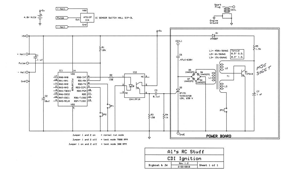

in this schematic http://www.rcuniverse.com/forum/m_43...38/key_/tm.htm
Why not have the pic increase or decrease the pulse to drive the mosfets according to engine RPM. That way at low rpm the unit is consuming very little current.

My ASCII- artwork isn't nice.
Wat I mean is, pause, high, pause, low, pause, high, pause, low,.....
This we have to make on both channels from the pic.
If transistor1 is high, transistor2 must be low and between switching (!) there must be a break/pause.
The transformer in the new schematic is a normal transformer and didn't work as a flybacktransformer.
This transformer need AC and the problem is, we don't have AC so we have to make it.
But AC have a smooth sinus wave and we don't have.
The Voltage will go from high within 0 usec to low......and thats not good.
Transformers don't like the squerpuls we put into the transformer.
But1 transformers act analogous, so inside the transformer the squerpuls will be reformed to a sinuswave.
But2 we have to given the transformer some time to do this and this is the break/pause between the high and low switching.

Dead time injection is not needed when a push-pull system inimplemented using a transformer with a center tap, only when half orfull bridges are used, to prevent a shoot-trough.
The square wave voltage isn't really a problem, because transformersare inductive, and therefore the current can't follow the square wavepattern; instead, the current will be more like a triangle shape.Ofcourse, driving the transformer with sine waves is more efficient. Itis possible to generate a sine wave using PWM hardware, but then thefrequency would be much lower, and thus a larger and heaviertransformer would be needed. This is ofcourse not what we want. A verysmall, light transformer needs a very high frequency input.
The problem with the current designs, is that the software has toconstantly check the sensor input for the pulse. This means the timingis rather inaccurate; at, say, 10krpm, the input needs to be checked at120kHz to achieve 1 degrees accuracy.
With the input capture hardware, an accuracy of 3.75 thousands of adegree is possible, and far less CPU intensive. Also, measuring theinterval between the pulses, which is needed to determine the speed, isfar easier.
I'll look into the schematics to find out if it is possible to use theexisting board with a few minor patches. If not, a different, lessaccurate and less flexible implementation of the software would beneeded to use the board.
The placement of the sensor (or, more accurately, the place of therising edge of the sensor respective to the TDC position) is a somewhatcomplicated matter. If the input capture function cannot be used, itwould be easier if the rising edge is outside the range where theignition should take place. On the other hand, if the rising edgeoccures at the exact moment the ignition should fire at low speed,starting will be easier. This is for a capacitive ignition system, foran inductive ignition, it is again different.

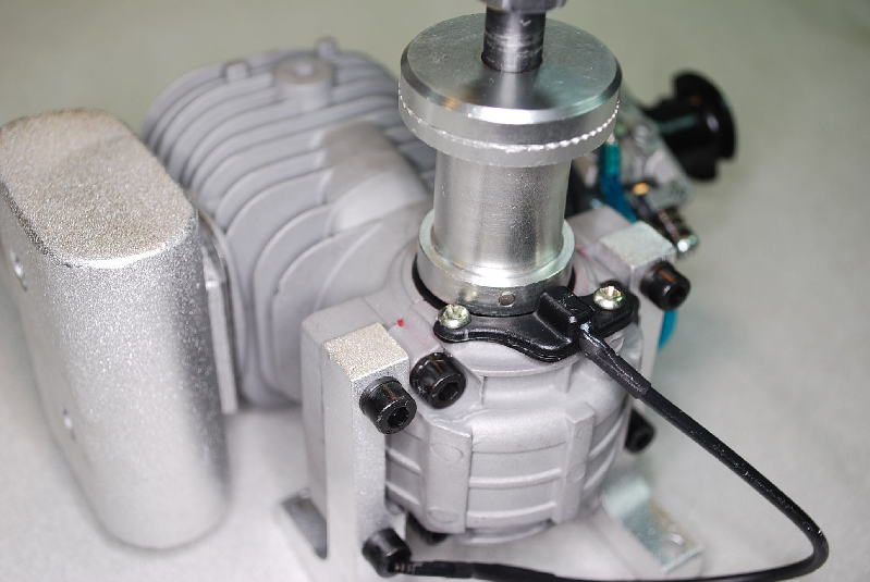

Some further comments on timing.
Almost all are using a Hall effect sensor for a pulse. Timing will vary depending on the engine manufacture but is typically 28 to 30 degrees before Top Dead Center. We attach the propellor to the shaft in such a manner that when we "flip" the propellor, the magnet passes by the Hall sensor and fires the plug. You can see the magnet and Hall sensor clearly in the attached photo.

Ok, so when flipping, we do get a pulse from the hall sensor, but what is the offset between the rising edge of the sensor and the desired time for the ignition? If there is no offset, and you use a capacitive system, starting the engine should be easy (from a CDI point of view). If there is an offset, or if you're using an inductive system, it's a bit more difficult. The problem with inductive systems is that you can't run a continuous current through the coil, waiting for the edge from the sensor to generate the spark. If you just keep the transistor on, and thus have a continuous current through the coil, it could overheat and fail.

What I would like to change about the existing design, is to connect the hall sensor to pin 9 instead of pin 7, the SCR to pin 2 instead of pin 6, and move the jumpers on pins 7 and 8 to two other pins, probably 17 and 18, to be able to use the UART for communication with a PC or laptop for configuration and debugging.
While I´m not thrilled about the design, in particular, the (in my opinion) unnecessary optocoupler, the rather fragile flyback converter, and the use of a 7805 voltage regulator instead of a low-drop regulator or shunt regulator.
But by far the worst part is the rather poor choice of the I/O pins of the microcontroller, which makes it impossible to use any of the specialized peripherals.
I don't mean to offend anyone by saying this, but I feel it needs to be said to be able to explain what I would like to change, and why. <br type="_moz"/>

once the engine is running, I really don't care where the sensor is.
The idea is that you measure and filter the interval between the pulses, and constantly estimate the rotor position, based on this interval measurement. Every time a pulse is received, you calculate the difference between the estimated and measured position of the crankshaft, and adjust the estimated position by a fraction of the difference. That way, you always have a fairly high-resolution live estimation of the crankshaft position, which is constantly adjusted but small amounts, and keeps tracking the actual position.
This way, it doesn't matter exactly where the sensor is, because the switching events are related to the estimated crankshaft position, and not directly to the sensor input.

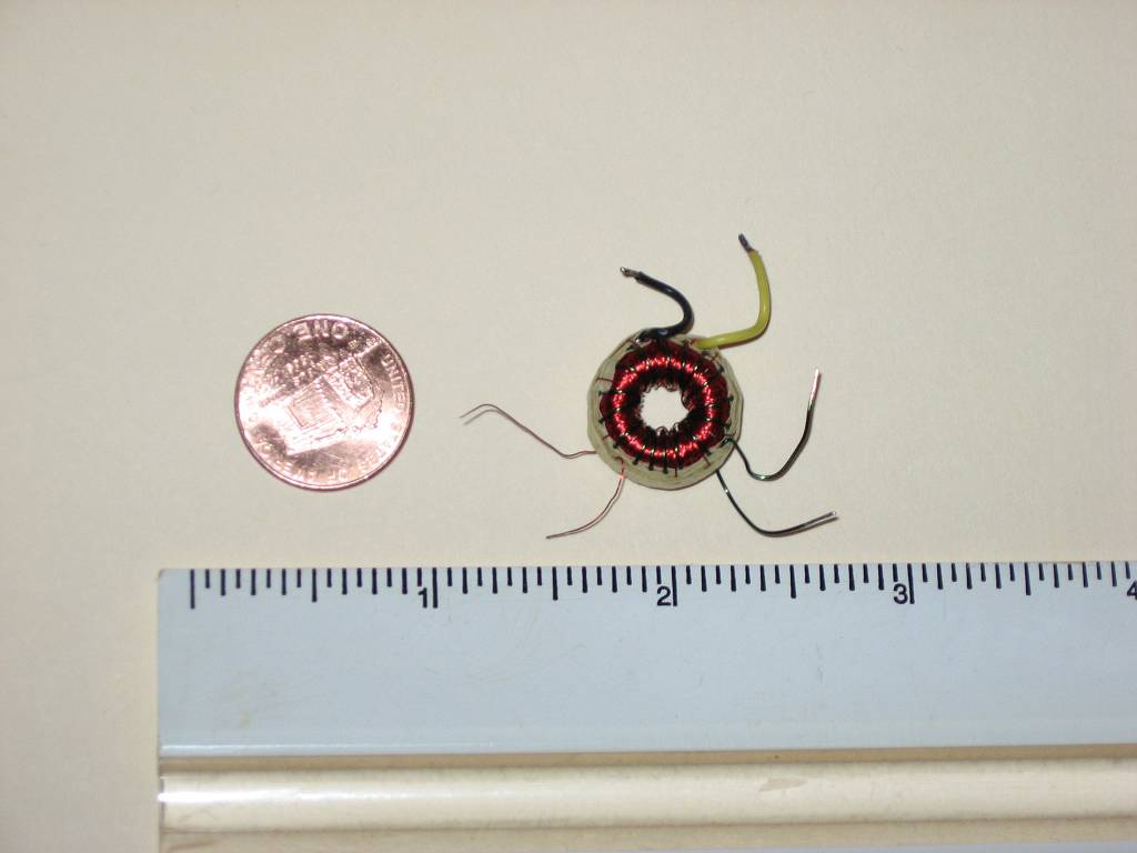

I was going to build a prototype this week using the attached circuit. With the changes coming, I will defer until we have a proven software package.
On thing I would like to see incorporated is the use of a commercially available transformer such as a CTX210655-R. We can either buy new or salvage from a laptop or LCD monitor.
Winding these on a toroid is an art form. I'm not so sure my arthritic fingers are up to the task. Too many propellor strikes!
AlZ
AlZ

You always have to use "old" information, because you have to measurethe speed. The filtering may or may not be needed (I intent to makethis configurable) because of some jitter (variation) in the hallsensor edges.
It would ofcourse be possible to improve the acceleration behaviour (ina future version) by either using a different position sensor, like amissing tooth sprocket, by calculating and correcting for acceleration,or by using extra sensors, like an throttle position or intake manifoldpressure sensor.
I wouldn't know where to get affordable, small and lightweight pressuresensors, but a throttle position sensor should be very difficult. Itwould also be possible to measure the signal to the throttle servo, anduse that for ignition advance.
All this is, ofcourse, for future versions, first we'll have to build a system that works, and works better than the existing software.
@Azalner:Ithink you understand the proposed algorithm perfectly. It would be easy if the sensor can be adjusted to generate an edge at ~30 BDC for starting, and you did understand correctly that the position of the sensor doesn't matter afterwards, as long as the actual position in input correctly in the software. It isn't quite clear to me if this is always possible, or if there are engines where it is very difficult or possible to adjust the sensor or magnet.
Ihave already implemented a FIR(finite impulse respons)filter for the intervals, and therefore for the crankshaft speed. I'm not worried about spurious pulses on the input, if you use a sufficiently low resistance pull-up or pull-down resistor, any noise will be suppressed. A couple of clamping diodes and maybe a small capacitor to either power supply rail would also be a good idea.

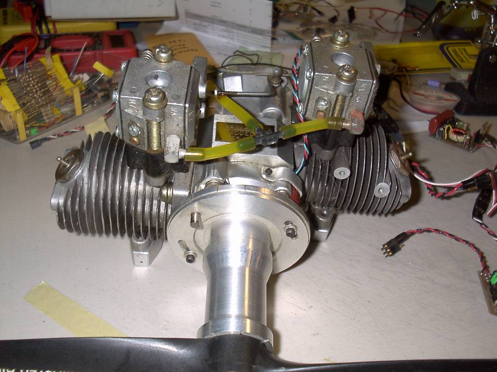

Al..
This motor wouldn't fire and run set at 28 degrees of advance..so there has to be a great amount of retard in timing from around 0 to 300 rpm's for hand starting of twins and other slow turning motors.. it's a twin Echo weedeater conversion that does run on glow quite well, but ignition will have to wait till we get a functioning timer board with software.
John
John
