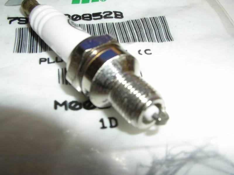

Has anyone converted a four stroke trimmer to gas / glow (2/3 gas mixed with 1/3 10% glow fuel)?
I just picked up a 26cc 4 stroke trimmer head and I'm interested in any tips before I tear into it.

The hard part will be making a glow plug adapter the the Ryobi 26cc. It usea a special thread plug and it is very deep. The plug thread measures 10mm diameter and is 10mm deep. No one makes an adapter, so you are on your own. You also may have trouble getting enough fuel, since the main jet is fixed. The four stroke pumper carbs use a modified pump action, due to the weak pulse available.

I measured the bore of the plug while still in the package. It is slightly over 1/4". A glow plug is 1/4x32 thread, so it is a little large to tap for a plug. you will have to fabricate a new adapter. The threads should be about 5mm deep and the plug recessed into the body as much as possible. A rim at the top could be slotted to allow a large screw driver to tighten the adapter. I thought about doing this, but the carb mods and plug issues stopped me. Someone in an earlier thread drilled out the main jet in the stock carb. You could do a search and find the thread. If you make a good adapter, make an extra for me. This would save a pound. Mine weighs 76oz with mag. ooch!

The 10mm hole you mentioned would convert to .3937". If a standard glowplug has a 1/4 X 32 thread this would only leave 0.1437" worth of material for threads. This is a pretty narrow margin as you indicated.
I just ordered my engine so I don't have it here to examine the inside of the combustion chamber. Does it look like there's enough room in the head to drill and tap for a standard 14mm spark plug (adapter)? If not I may have to devise a way to modify a glow plug to fit the 10mm hole (ie braze the threads and recut the threads). I guess another alternative would be to weld the current spark plug hole in the head closed and then drill / tap for the 1/4 X 32 glow plug.

I would make a screw in adapter. Here is a picture of the plug. The hole in the middle is about 1/4". The valve train and cover take up most of the head.

I wonder if the spark plug can be gutted and then modified to accept a glow plug in the area where the electrodes would normally be...

The problem is that the feeling has been the glow plug should be down at the end of the threaded part of the spark plug shell, both to increase compression and to expose the glow plug to the mixture in the best fashion. When doing this with a standard spark plug shell when making a homemade adapter, the plug shell gets really thin at the thread area in order to provide an entry for even a narrowed down glow plug socket or wrench. With the plug shown, it's going to be a real problem it looks like....

Thanks for that feedback. i'm beginning to think that welding the spark plug hole shut and then drilling, countersinking, and tapping for the 1/4 X 32 glow plug might be the best way to pursue this.

As I said above, the hole measured 1/4" which is a little large for a 1/4"x32 tap. Maybe the hole could be silver soldered and then tapped. The threaded section could be cut down to expose the hot coil more. Maybe the head could be welded shut and drilled and tapped.

How about the right size Heli-coil. Drill for Helicoil and then install the Helicoil for same size as standard glow plug. NO 2 Method: If you remove head...can you just Heli-arc the spark plug hole shut...dress-up weld in dome and drill , tap and spot face for glow plug. If that is not possible I have one more idea. Leave spark plug in and drill from inside the cumbustion chamber to a new spot where you can spot-face and tap for a glow plug in different location. Best Regards Capt,n
