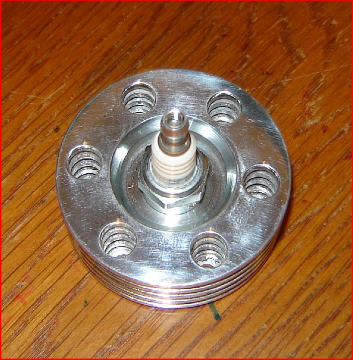

HUummm. I had a like new Supertiger .90 gave to me. It has a broken off exhaust bolt. It seems like making a new gas head for it may be fun!! Capt,n

Has anyone considered a gas / glow version, further reducing the weight of the ignition system?

I'm working on a Gas/Glow Super Tiger .90. Should be ready soon.

There are typically several big glow engines (Super Tiger or other) in the classified ads at any given time. A lot of people shy away from these due to the glow fuel consumption rate (real or imagined) and carb / pump problems (real or imagined). Either way this creates an opportunity for the conversion crowd to pursue another line of conversion (from glow to gas / glow) relatively cheaply. Just one opinion...

How are you going to determine which is the right carb for the conversion?
Old 02-04-2007 | 12:40 PM
Posts: 12,957
From: Hesperia Michigan, MI
Default RE: Another Conversion
I believe the stock glow carb on a Supertiger .90 should be ok for at least a good test. You can aways make an adapter for a small pump carb. Capt,n

I found this Webra ....sounds like it has a needle brg rod! Capt,n http://www.webra-austria.at/neu2007/...07.php?lang=EN ADDED Also like in post #11 foamcut has a very good idea....there is going to be a lot of conversion options for gas/glow or just gas. Everyhing for just about anybody!!!
