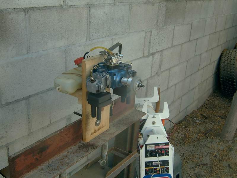

#134
Not much to that, except more money and weight...
It handles very nice. Started on the third flip. No vibration whatsoever. Can't even see the gas jiggle in the tank, nor feel vibration on the test stand at any speed. With only 10 minutes on the engine and no fine tuning, a quick full throttle blast showed 6500 rpms with that big old 20 x 10 wide blade APC prop. After about 25 minutes of easy running I shut it down, and it restarted on the second flip of the prop. It's going to be a keeper!!
Thank god it starts so easy by hand flipping.... I have a gear reduced starter rigged up to a 16 volt high amp nicad pack. It turns my Poulan 42cc over easily and fast. I later tried to spin this twin over to injest some after run oil with the starter, and it won't turn it!!
AV8TOR
AV8TOR
#135
Sounds like you got a winner there. I see in your photo you have the Glow Power on about as many amps as plug will take. Did you un-hook glow completely? How was the Idle without glow drivers on? Thanks capt,n
#136
Yeah, I let it run for a while with the glow power on, and then disconnected it. Good catch on seeing the glow power was on for the photo! I was wondering whom, if anyone would notice that.
It ran fine without glow power; just like my other engines. They will often idle just a hair slower with the glow power on, and this one is the same, though it idles quite slow without glow power as well.
I really wasn't sure how it would run without the glow power on, as I put some old non-idle bar Fox plugs I had in it for break in. I've noticed that often times with these Gas/Glow jobs that they will "eat" a glow plug on break in due to the tiny metal particles shed during the initial break in. That's why I put some old "disposable" glow plugs in it to start. After another tank of fuel, I will change over to the OS or Saito 4 stroke plugs that I normally use. I expect then it will handle even nicer and run smoother; though I have no complaints at this point anyway... It might also pick up a touch of power as the hotter plugs will advance the timing somewhat.
So be warned everyone... If your new engine starts acting "flaky" after a while when first run, change the glow plug. You will find that the glow plug looks fine, but it has been contaminated by tiny metal particles and it's bad. Put a new plug in and the engine will start acting normally again.
Cool project and I'm REALLY happy with the engine.
AV8TOR
AV8TOR
#137
Looks great. Did you get any pictures of the welded crank? Was sit welded all the way around or tacked? Also noticed no bearing in front of the case or behind the prop hub. Any reason one way or the other. What carb did you use? All I have left to move to the new house and shop is the lathe and mill. Maybe I can get to mine in a while. We will see.
#138
Hi,
No, I didn't weld all the way around. I stopped on each side before I got to the pin as I didn't want to overheat that area.
As far as the front bearing, it bothered me a bit that it left so little of the crank sticking out to attach a hub. After studying it I thought that while it would be somewhat stronger with the third bearing, I didn't feel it was necessary. I mentioned it to Keith and he also thought it would be ok without it.
Carb is a 13.5mm venturi that I had here. I'll get the number off it if you want.
AV8TOR
AV8TOR

#147
I haven't had time to run it much more, but it runs excellent. I'm getting 6700 with an APC wide blade 20 x 10, but I think I will prop it down some to let it rev up a bit more. The 23.6cc singles seem happier spinning up over 7500. Keith said a lot of people liked a 20 x 8 on their twins. It will idle reliably at 1600 rpms. I'm running Gas/Glow, and no problems.
One hint though.... At one point it mysteriously didn't want to start. Long story short I found that my field box battery got a little low, and it wouldn't light both glow plugs. It would light one just fine, but not both. So if you are going to run your twin on Gas/Glow, make sure to check with the glow plugs out that your equipment will make them both glow nice and orange. Other than that, starts are usually one or to flips. I haven't used a starter on it yet.
Also, it will end up that the carb regulator cover and it's hole will be facing forward. This can cause tuning problems due to the ram air from the prop, and later from the slipstream. Solder a small 90 degree brass tube into the regulator cover pointed into the carb opening to avoid this potential problem. If your engine is going to be cowled, run a hose from this tube into the fuselage to sense static air; not pressurized cowling air.
Good luck,
AV8TOR
Good luck,
AV8TOR
