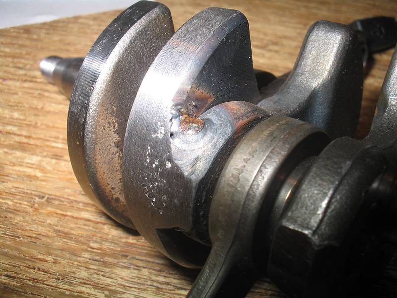

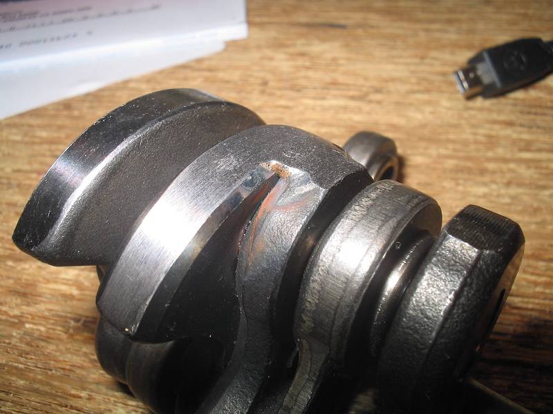

Trouble in Paradise.
With about an hour on my twin I went back to the shop because I just didn't like the way it was running.
The last time I ran it and after it was warm it didn't want to throttle up.
I figured it was breaking in and needed a Carb. adjustment or something.
It was pretty warm the last time I ran it, but not over heated.
I noticed air in the line so I turned the prop over by hand.
Well it felt like it was binding up. Not under compression but in mid stroke.
So I took it apart and found the crank was bent.
When the guy welded it he welded it on the end of the counter balances, not as shown
in the welded crank pictures I posted earlier.
I didn't fit my crank my self so I can't say for sure how good of a fit it was but Jack is a perfectionist.
Any ideas?
One thing about parts are pretty cheap "FREE" so I'll just be out the labor.

Hi Ralph, have you solved the problem with the bent crank on the Echo twin?

Maybe.
The guy who put them together didn't pin them and only welded on the on the outer edge of the counter weights.
This is not how we had agreed to put them together.
He still says that it is strong enough the way he did it.
It does appear that something metal went through my engine.
There were metal fragments in the engine and a deep score in one cylinder.
He says that is why the crank bent, I'm saying the crank would not of bent if it had been done the way we talked about it.
So I've been working on my Cub and thinking about the twin, hoping to come up with a better idea?

Ralph, did you check your reed assembly to see if one of the metal petals came apart? Maybe a wrist pin keeper? None of that would cause a lock to bend or twist the crank in my mind.

The reeds are fine as is the everything else, except the scored piston, cylinder and bent crank.
I believe it ingested foreign material.
Do you think 3/8 of an inch of weld on the ends of the counter weights would be enough to hold the cranks together?
Old 06-18-2007 | 05:07 PM
  #215
tim220225's Avatar
Joined: Jan 2004
Posts: 1,005
From: Mobile, AL
Default RE: Echo BME twin
I would think from the welds in the pictures you posted that you would be fine. I recall talking to Keith about this and he said they just tacked them as your picture shows. I asked about tacking the stub of the crank and he said it wasn't necessary. All they did in the past was pin a few.

The picture of the crank I poster was not the crank I used, Keith did that crank.
I had the 1st crank done and installed by the time I got this crank.
Here are pictures of the replacement crank.

I specifically did not weld the crank like that, both for strength and maintaining centering, (at least to my way of thinking), and because I didn't want to heat up that area and take a chance of overheating and/or weakening the rod pin or roller bearing.
You might check to see if the "foreign object" wasn't a piece of rod roller bearing....

All the bearings and cages were there.
3 of us gave it the once over and found everything where it was suppose to be.
I don't really have an answer.

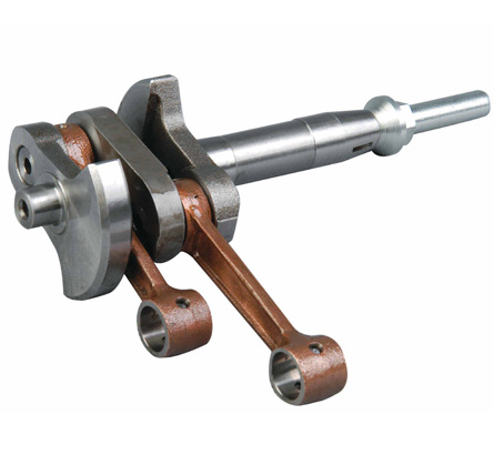

this may works , stroke 35mm

Ok, I'll bite.... what is it out of, or did you make it??

this is my new cranksift for 120CC. I use Zenoah G62 cylinder and make it as twin 120CC . think this engine maybe more powerfull than most 100CC engine in the market like 3W106 OR DA100. little heavy for sure, but who care about few oz
