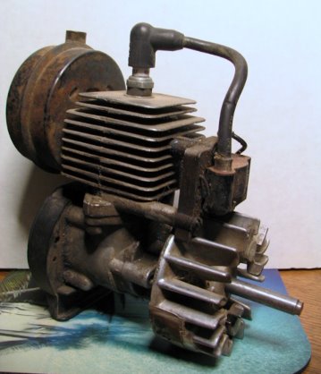

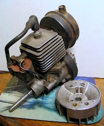

Thanks. This engine looks has slightly different bosses in the crankcase bolt-up areas than the ones in the conversion sites. The threaded part of the shaft has been cut off, the choke plate is missing, and it looks like it has cut a fair amount of grass.I don't mind fiddling with this (winter's almost here) but a plug and play zenoah or SPE would be OK too.

You can clean that up easily to make a good motor. If you want more power just take the magneto flywheel and with a dremal grind a keyway for the woddruff key that's about 1/8 inch counter-clock wise from the slot that's there, you'll gain 500 rpm.
The 26 SPEs from BMCA and Brillelli are good also, if you want a rear carb the LS-26 is a good choice.

Thank you- 'sounds like the cheapest mod of all. I assume these consumer engines are generally detuned to make them durable and easy to start. Regarding this mod, is this new keyway indexed counter-clockwise 1/8" while looking at the backside of the flywheel? Assuming this advances the timing a few degrees, how adversly will this affect: starting, low idle, or early part of transition?
I'm looking for easy starting, an idle that doesn't shake the glue joints loose, transition without dying, and with enough quiet power to fly a 1/4 sig cub realistically. I know, "good luck with that". So far I have nothing into this engine and would be happy to spend what it takes to get towards those goals. I hate throwing away perfectly good lumps of metal too.

The advanced timing would make it idle rougher. Ideally, you would switch to auto advance electronic ignition for more power, less weight, smooth idle, and the ability to hand start if desired.
For reference, my brother has a stock Ryobi on his Ryans Rebel. The plane has an 80" wingspan and weighs about 14.5 lbs. The Ryobi flies it nicely. Sufficient power for basic aerobatics, but not a rocket.

ORIGINAL: idler
Yes, might be a little harder to start. My friend has been doing this for years, he uses a pull rope to start them. When I had a mag on mine I used a regular starter. My friend liked to fainted when he saw me had flip my Ryobi after I converted it to EI, he bought two EIs from LS that day.
ORIGINAL: idler
EI is the way to go.

You can move the timming with out making a key way. You can take out the key and just move the flywheel 6 degres. Hold it in place real good and lock it down with the prop hub. it will hold. it is on a taper and will not move unless you hit the prop on somthing. like the ground. but with mine I had to hit the ground hard. the prop broke and the flywheel moved. but I hit the ground so hard it broke alot more then the prop. lol
It does work and works well. but going with cdi is beter then changing the timming on a mag.. but Gas/Glow is the best. and it is alot of fun.
