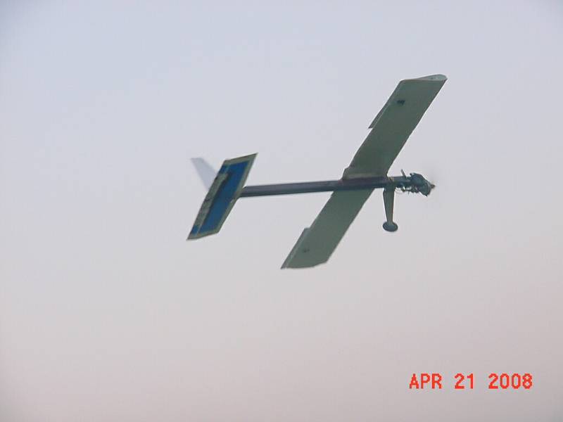

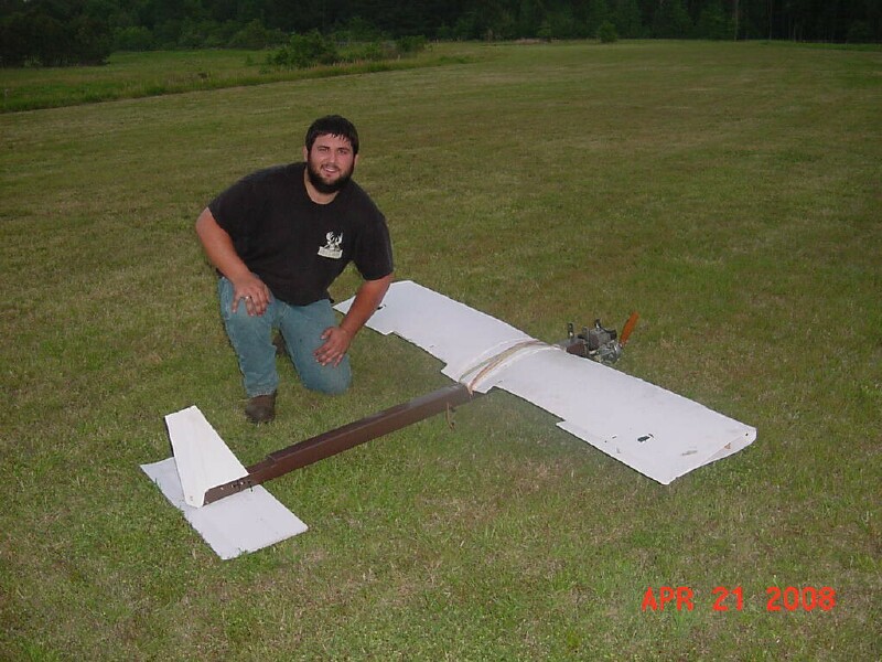

Old 04-21-2008 | 10:42 PM
  #53
Joined: Jul 2007
Posts: 594
From: gilmer/nacogdoches, TX
Default RE: weedeater/chainsaw 39cc for free, where to start?
ok i think i have figured out the problem!! the high speed needle was broken, instead of breaking the plastic i broke the needle itself so all this time i couldn't figure out why when i turned the high side nothing happened!! i pulled all the plastic out and the top portion of the needle, now all that is left to adjust is the little bolt that is deep down in the needle recess on the side of the carb, i can see it, but i can't figure out a way to adjust it..
today i tried a 15x8 prop at a max of 7200rpm and then a 16x6-10 at around 6000rpm max.. all of this was done by adjusting only the low end, if only i could figure out a way to turn the remaining piece of bolt down in the carb on the high side i think i would have a great engine! regardless, i got the big turd to fly here are some pictures of my first scratch built no plans spad with my first weedie conversion as well.
btw, if anyone can think of a way to turn the high speed needle please let me know asap! thanks!

Old 04-23-2008 | 09:53 PM
  #54
Joined: Jul 2007
Posts: 594
got a different carb on today with an adjustable high and low needle, but the engine only made 6000rpm with a 15x10 prop.. does it need a new ring, or is that rpm about right for a stihl 30cc engine? it seems to be a little weak to me, where is a good place to get a ring for this engine for a decent price?
also the engine wasn't real reliable, it would run great on the table and then i would get it down on the runway and it would die half the time, the other half it wouldn't make full rpm, but every once in a while it would run up strong, it would fly slow, barely enough power to fly and run fine the entire flight and landing and then taxi back, then i would kill it, put it on the table, top off the tank and fire it up again only to find it not running right!! i spent about 5 hours working with this engine all day today, and it only was dependable about 3 or 4 times, the rest of the time i was working on it! i spent a very frustrated afternoon, could low compression cause this unreliability? the engine has to have some compression to turn the 15x10 6200 rpms and the 16x6-10 6000rpms, but this is barely enough power to pull this plane, i would be fine with that, what i am not fine with is the unreliability of the engine!!! any suggestions?
Old 04-24-2008 | 01:50 AM
