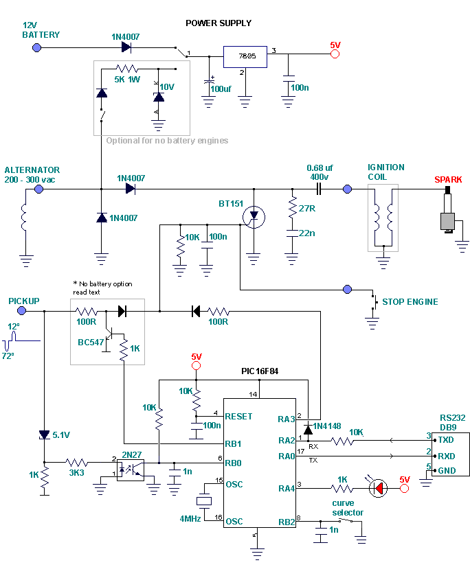

OK, then think of value added. I have added a $3.00 PIC chip with almost no other components (no Xtal, no extra switches, only one diode) programmed it with some simple software and tied it to a CDI. This, in my opinion, is a cost effective solution to make a gas engine more versatile. If you are happy with fixed ignition timing and it's doing your job, that's fine too.

Hi! I have found in here [link]http://www.sportdevices.com/ignition/ignition.htm[/link] this.
Will this works that you think about?
It will be work on Hall sensor?

The first schematic has a high voltage alternator, which produces 200-300 volts. This makes it a bit easier to generate enough high voltage from the spark coil. The second circuit acts on pulsing 12 volts through the spark coil. I'm not sure that it would work, but maybe it does with the right coil. The way the input to the PIC is shown will work with a PIC.
