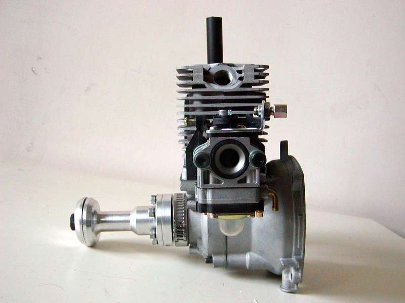

I use this"MAGE FUSE" ignition .
Old 05-24-2004 | 12:11 PM
  #237
Antique's Avatar
Posts: 9,825
From: Somewhere, DC
Default RE: Scratch Built Ignition???
Tomy, Tell us more about your ignition system. Can you share some details ?

Is that a CD ignition? ( must be, I see the small toroid coil, but no little box).
What engine do you use it in?
Looks very small and compact!
Old 05-25-2004 | 07:44 PM

this is a factory build CDI ignition . only weigh 83g . and use epoy seal all inside incase crash or humidification . this ignition are using 4 or 5 cell battery . very strong speak. aluminium shell and ferrite ring can eliminate all EMC interfere . but only one things , this is not repairable but it's reliable I use this ignition on my S.P.E 40Z engine . 40cc ,1600g total weigh , sway 20X10 prop up to 6400rpm . very good ignition and engine .

How much does the ignition system cost, and can you send it to U.S.A.??

this ignition are 69USD per set. and will coming to USA at June
