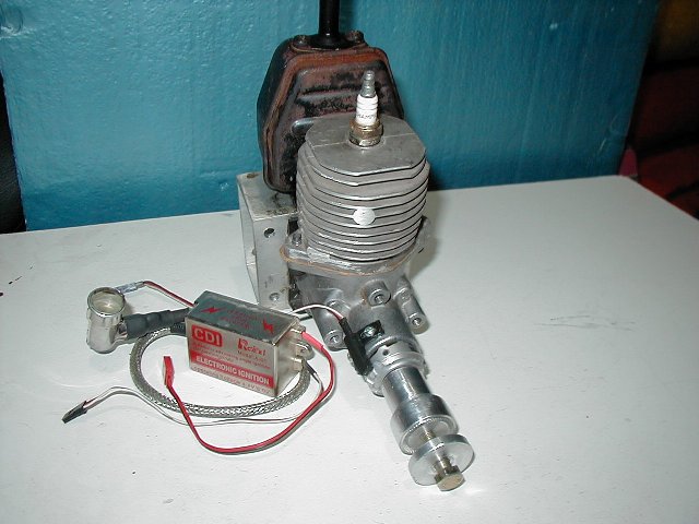

Check out the gas/glow thread here in the engineconversions.Theres to much to explain but after you read just the first few,maybe 6 pages youll get the idea.heres a pic of my 31cc ryobi i just did.Cut out center of flywheel,trued up in lathe,then screwed hub on.You can see the magnet in the flywheel hub.I also rounded the cylinder for a more airplane look.Total weight as in the pic with ign is 3-1/4 lbs.I would really suggest you go to the gas/glow thread to help with a decision.But it might be easier in your position right now just to get a ccw engine,what size are you looking for or what size and style of plane are you going to put it on?
ID:	986775   Click image for larger version

Default RE: Smallest trimmer for conversion?
deadcell, as buck1856 suggested,consider taking a peek [link=http://www.rcuniverse.com/forum/m_1267448/tm.htm]Here[/link]

ORIGINAL: buck1856
I've got a 31cc Ryobi
and i'm looking to put it on my Lanier Stinger 120
I had at one time a Quadra 50 on it, but traded it for something else.
Wish I had the Q50 back now!!
Trying to get all this done without spending a ton of money.
Thanks DC
P.S. I read the first 10 pages and last 10 pages of that thread on gas/glow.
Sounds like all I need is the spark/glowplug converter , and some glow fuel to mix with gas.
I'm curious if its a bad idea to mix flow fuel that has a higher content of oil in it with the gas.
Will that hurt anything?

Your not using that much oil,your to buy the 10 percent nitro,10 percent oil content glow fuel.When mixed with the gas you probably only have about 8% oil content maybe.And the ryobi will never have the power of a Q50.Look up ryobi 31 in the search bar under this forum and youll see what it flies.The ryobi may fly it but i dont think very good,but i could be wrong depending on weight.
