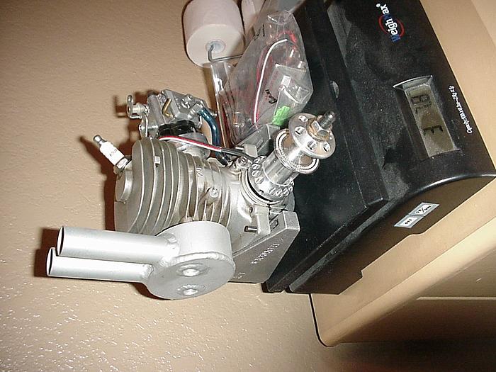

Hi Buck, I am going to try to send you some of my Pictures of my converted Echo 3900cc engines. Later George
MVC-001F.JPG 18 8 2008 22:01:14
MVC-002F.JPG 18 8 2008 22:01:44
MVC-003F.JPG 18 8 2008 22:02:54 You will have to click on my Gallery at the bottom of the page.

Hey,thanks for the pics and nice looking engine.I have an echo 45cc im doing right now so ill have to wait on a 3900 for a little while.I foiund a short block but i dont remeber if it was a 346,3600,or 3900.Ill have to go search it down again.I went to the site also and those prices are at least,if not just a hair cheaper than what the echo dealer close to me sells to me for.For instance,i paid $129.00 for a 24cc short block.But he wanted $99.00 for a cylinder kit.

hello Buck, Is that echo 45cc from the CS-440? I have one I have been puttering around with, if it is the one with the three part block. Anyway my local echo dealer can't get any parts for it. I need the cylinder gasket and the oil seals for the shaft. Have you had any problems like that? George
