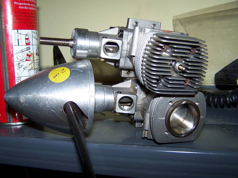

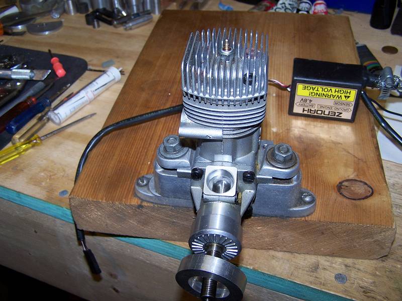

I got a working CD ignition now so I am going to convert & run this SuperTiger .90. I am going to use 20% oil in gas for lube. I got about 5 mini spark plugs to try. 1/4x32 size. I may tap heat to 10mm later. I am going to bore out the ring hanging on end of propshaft to slip fit on hub. Capt.n

What size/brand/ prop and what RPM should I shoot for? I will try to get close to your RPM on Gas/spark ignition. I am going to try 20% Klotz oil in fuel, going on the theory...more oil more power! I have 3 other fuel and carb combinations to try also. Capt,n

I am glad you asked. No I do not sell engines. I have many that are ready to be test run. I do not like to run them in cold snowy weather. As I read this conversion stuff, I just got the bug to do a few. Well I got to many now to finish. Thats ok, because I can use parts like on the Homelites to replace parts when I make a mistake like forgetting to remove the little ball that is spring loaded on choke shaft. It ruined one of my best engines. I can fix it with spare parts from the extra partly done engines. I have been helping my Grandson a lot with RC airplanes. He is in collage, but we get together quite often. He in turn is getting other collage kids into RC. It is real rewarding to me. I do help about everybody in the area on engine powered devices. In turn I have had some pretty good power products that people do not want. One was a Echo string trimmer, because the woman who owned it bought another one that started more easy. The Echo has very high compression. I do not understand how I come buy this stuff sometimes. I bought a Like new SuperTiger .90 with nice spinner and prop for $2...thats right ...two dollars. The head was missing...do not know why, the rest looks perfect! In the future there will be more give-aways, I got too much!!!! Capt,n

The carburator was on engine when I bought the ST .90. In the photo I had it off and on yet another engine, 25cc Homelite! The engine has real good crankcase compression even with head off. I Sealed the top of the cyl with my hand and it has very good cylinder compression too!!! My friend says the spinner is worth $20 alone!! Not bad for $2 Capt,n
