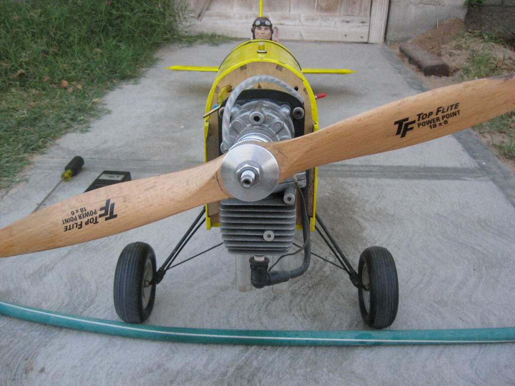

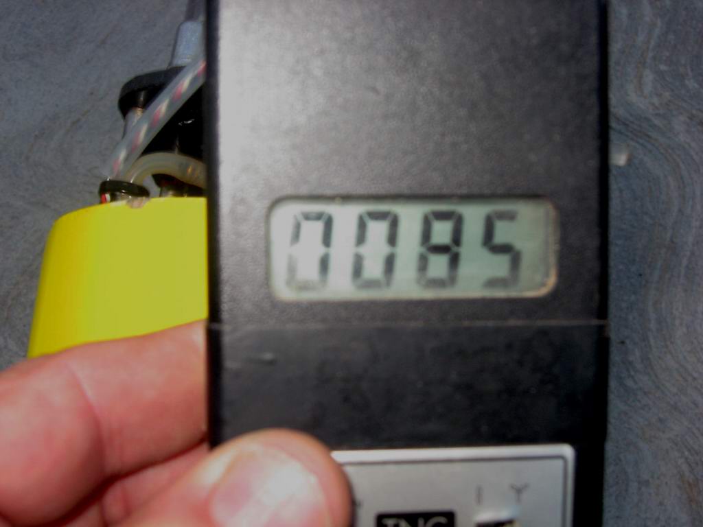

I really like electronic ignition, and in fact, out of a rather large fleet of planes, I don't have a single magneto equipped plane.
The benefits are lighter weight, easier starting, better idle, more power, and nicer looking as well. I can't give you an exact figure on how much more power, but you would gain some. You don't have the drag of the magneto aerodynamically, nor the drag of the magneto magnets as they make electrical power for the spark. Also, you can optimize the timing, which can result in net power gains too.
I have a Ryobi 31 in my Giant Tiger Moth Biplane. As usual for me, I have hopped it up by raising the compression, increasing the exhaust port timing, using a free flowing muffler, and a larger than stock carburetor along with electronic ignition. But it works, as it turns an 18 x 6 Top Flite wide prop at 8500 rpms! No, you should never turn a Ryobi over 7500 static or you risk blowing it up. In my case, I can't make a larger prop fit the spinner size for this particular plane, so I either don't use full throttle, or limit it to a few seconds at a time in this case.
AV8TOR
