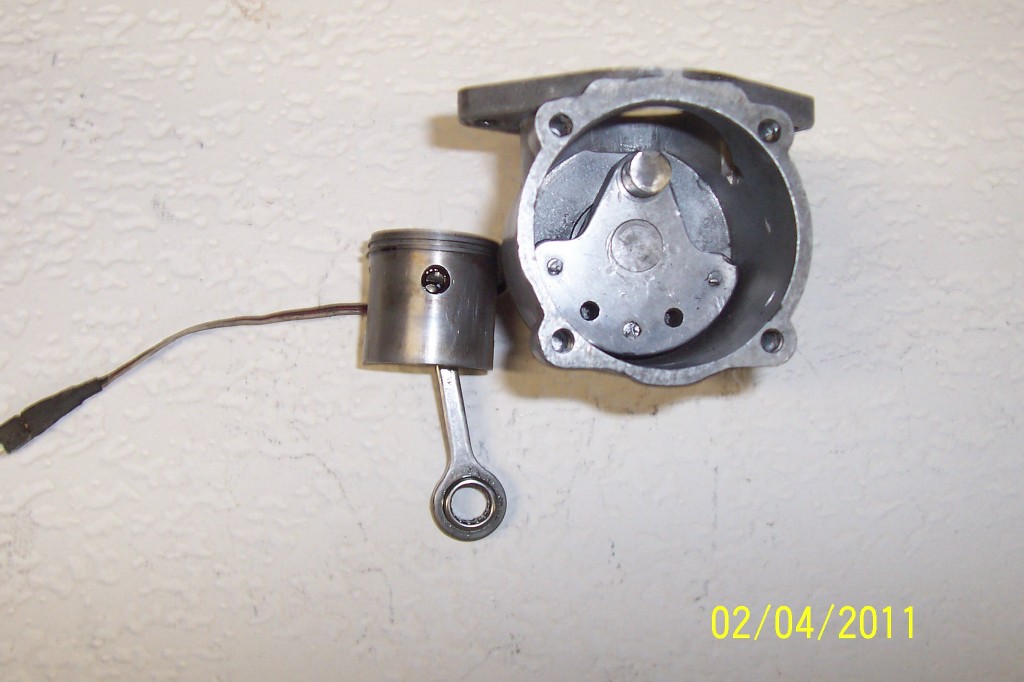

I aquired a "YARD MACHINE" (RYOBOI) engine the other day, and when I dismanted it, I discovered that it uses an O ring for the crankcase gasket. I have used O rings for sometime with great success. If anyone is interested in this arrangemnet I use, feel free to contact me: FLATHEAD

This information should help those who would like a better Con-rod for your RYOBI. I have never had a a conrod failure, but I believe it is possible. For that reason, I have been looking. I aquired several POULAN 31cc weedwhips, and the conrod impressed me. It is solid steel, but the rod journal is larger than the RYOBI, but very similiar to the RYOBI. The wrist pin is the same diameter as the RYOBI. I pressed the journal out of the POULAN crank, and devised a mount for my lathe that allows me to fasten a DREMEL TOOL on the tool holder. I used an emery stone on the DREMEL to grind the journal down to fit the RYOBI crank. I then pressed the modified journal into the RYOBI crank, using SLEEVE LOCKER for further strength. Yesterday, I put the engine back togather and with everything else stock except for electronic ignition, a 18X6-10 wood prop, I recorded 6300 RPM. I ran the engine for 15 minutes. I will dismantel the engine for inspection before I run it again to see if there are any trouble spots. I will keep those interested informed as I futher modify the engine like larger carb, further timing ect. Sorry, but I have not figured out how to put pictures on this site, however, I have taken pictures. FLATHEAD

Still hanging in there on improvments on the 33 RYOBI, and I continue to find differences. I dismantled several engines when I replaced the rod with a POULAN produced rod, see previcous post. I was compairing crankshafts, and noticed that one of the short-shaft crankshafts has a dfference as to where the keyway is. Using a degree wheel, it appears to me that there is a 10 to 15 degree difference. I looked at the long shafts engines (2) that I had handy, and could find no difference. It is possible I suppose that the crank slipped at some time since it is pressed on, or maybe it was an attempt by the manufacture to gain power or RPM. Any thoughts on this. I have always used electronic ignition on my "RYOBI" conversions, but it does seem possible that it would improve high end RPM, but may also be harderto start. Just wondering. FALATHEAD

Those were linked pictures from Facebook I think? Apparently he changed his Facebook account?
But the technique of removing some metal from the back of the crankcase to place the back plate as close to the crankshaft as possible is a old trick used for many years.
On engines without the reed valve in the back plate some have added metal to the back plate to make it extend farther into the crankcase and therefore reducing crankcase volume.

I think you are getting me confused with somebody else. Everything that I have done so far with these 31's has been to improve reliability. I currently have 3 31's that are flyable. 2 of them have been in the air. The 3rd one hasn't flown yet but will be flown soon.
The 2 ring or single ring issue, as far as I can tell doesn't seem to matter. 1 of my motors is a single and the other has 2 rings. At the field one day I swapped motors and got nearly the same preformance. I used the same prop, 18X10 Dynathrust.
The 3rd motor, hasn't been flown yet. It has a single ring and it was a long shaft. I cut the crankshaft down, drilled centers in it and single point threaded a 5/16 -24 thread on it. I ran it thursday before the heatwave started and it started right up. On this long shaft 31 the keyway was not on center. It was off maybe 5 degrees. The motor seemed to idle slower and smoother. The top end didn't seem to be as high. I'm running all these motors on the stock magneto.
With the motor mount and reed valve issue. All my effort has been to get away from the molded reed valve mount and then to incorporate a better engine mount that spreads the torque out more evenly on the firewall. I use 3/8" 7 ply for my firewalls.
Larry
