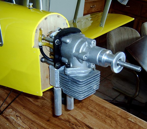

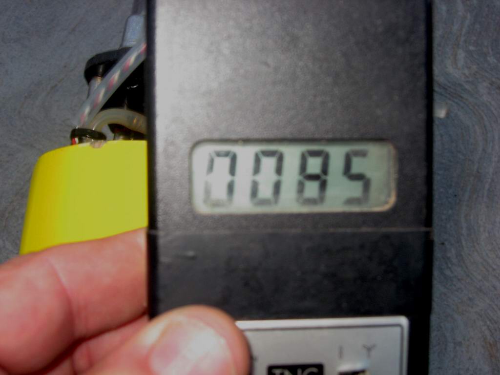

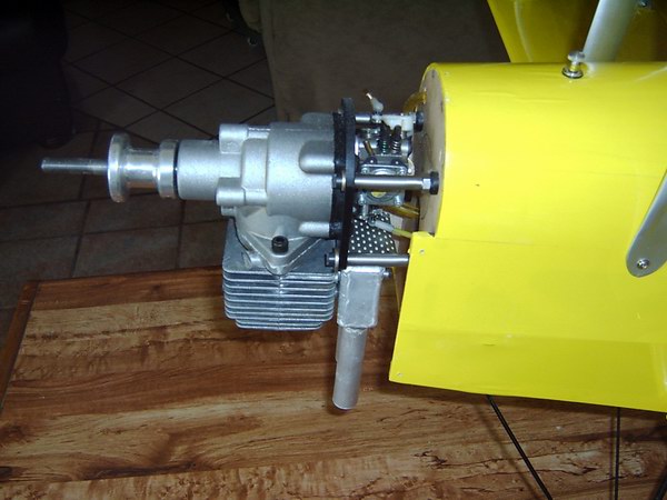

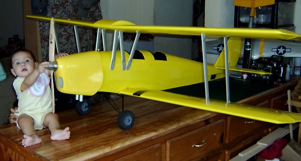

I've been meaning to do this ever since this thread started and have been too busy to get around to it. But now I have been going through all my planes doing battery and fuel system maintenance, and I finally got around to the Ryobi on my big 76" wingspan Tiger Moth.
It has a Ryobi with a good cylinder with no "smog slits", a Frank Bowman ring, exhaust port timing set to 150 degrees, deck height set to .020", an 11mm carb, electronic ignition set to 28 degrees, an aftermarket two tube muffler and a Top Flite 18 x 6 prop. Nothing special really.
Anyway, it turns the 18 x 6 at 8500 rpms. Yeah I know; I need to put an 18 x 8 or a 20 x 6 on it to get the revs down to a more reasonable 7500 rpms.... With this setup it will easily loop the big Tiger Moth at half throttle.
Here's some pics.
AV8TOR

Here's another kind of neat picture of it...

I thought I saw grass in one of those earlier pictures? Is there grass in AZ
That's a screaming Ryobi

Hi av8tor1977... You may have mentioned before but what are the vital specifications and the manufacturer of your ryobi equiped Tigermoth?
Thanks, diceco

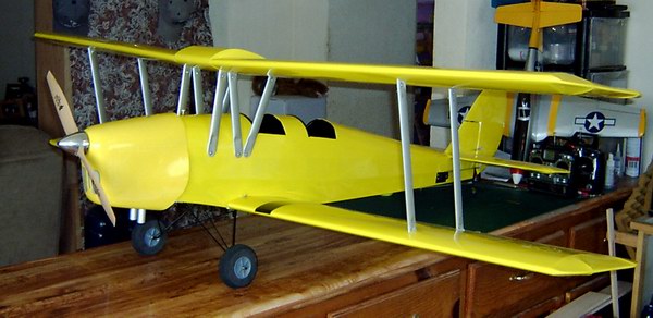

Hi,
It is the NitroPlanes Tiger moth. Wing span 76", weight with the Ryobi ready to fly 13 lbs. 3 oz. Wing loading is 16.7, wing cube loading is a ridiculously low 4.7. It would fly great on a decent 20cc gas engine if you are interested in scale like flight. The airplane came with only the two ailerons on the bottom wing. I added the two ailerons on the top wing for a four aileron ship. (I am not too concerned about "true scale" as long as it flies how I like it....) The Ryobi fits completely within the cowl with no cutting the sides. It balanced fine without ballast using the Ryobi on electronic ignition.
W8YE, I think you "shamed me". I actually got busy and trimmed that grass this afternoon...
AV8TOR
P.S. What a shame that Nitro Planes spent all their restocking time and money on "electron" airplanes. I have several of their gassers and really like them AND the price I got them at. But now they are pretty much out of stock of all "interesting" (gasoline capable) airplanes. Then all the magazines write about these days are are those dam n electrics.... Careful guys, I am afraid we are a "dying breed." []
