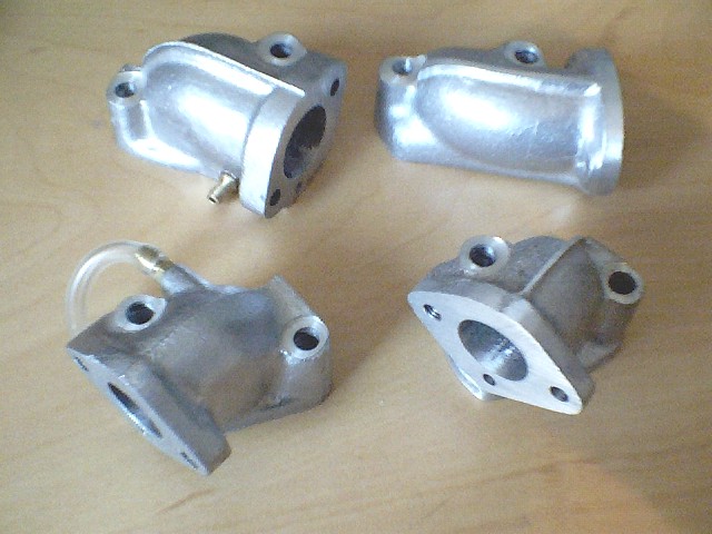

The muffler is the bottom of an aluminum gas cylinder. It was machined up all pretty. It has a round disk with a step on it that bolts to the engine. One bolt holds the disk to the can. The can has a hole in it to let the exhaust out. I stole the idea from somone who makes such a "puck" muffler for Ryobis. It is not blocked. I increased the size of the hole until I got full RPM.
I am thinking of maching an intake manifold out of aluminum bar stock. At least I will know everything is tidy and right. The old plastic unit is a bit grungy.

I made an aluminum manifold for a Kiortz fourty something cc and it worked great. Maybe the gaskets proxide enough heat insulation? That engine was a fine performer until it hit the ground at 100+ mph. The crank is bent and I can't figure how to straighten it. I have beat on it and pried on it to no avail. Anyway, back to the Zenoah.
