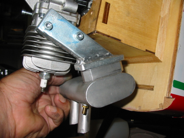

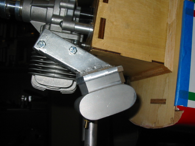

The DLE 30 is a good runner with Franks Piston ring. The rings he makes are very good and break in faster. I have not had too much extra time...have not been of much help here lately. Ido have a photo of a exhaust adapter I made so I can run a Pitts muffler on 2 of my engines...maybe other engines too! Capt,n PS I have not had time to even read the last3 AMA magizines yet! UPDATE 3rd photo is the more finished photo!

looks nice John

How soon are you going to start selling those?

<hr />I will not be selling them...but I am learning what aluminum stock the guy has that did the welding &amp; what can be done. I am drawing up a better one (all one piece) that if thingsgoright with aprototype, withthe right pricing so he can weld them up, sell them at a price below others on the market by 25-30% and still make it worth it for him. He would probably do it. Lets face it ...people need work in the USA! Capt,n PS Inside tube is 2 sleeve spacers so bolts will not crush it.

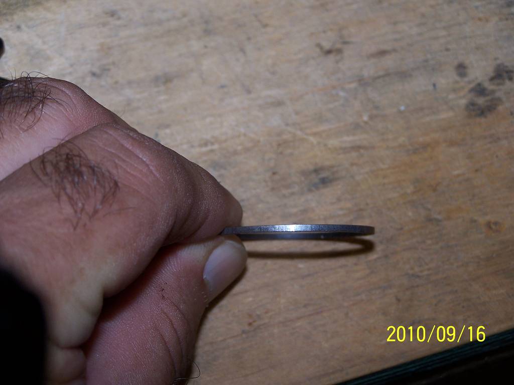

So what's the consensus on the rings supplied with the DLE-55? Are they still made from very hard metal, and not very concentric?
Will the engine still take a considerably longer time to break in with the stock ring, than it will with a Frank Bowman ring?
I don't get out to the field that often, and would prefer not taking a whole year, or two, waiting for my engine to break in. To me it's worth the $10 bucks just to expedite this process...the cooler running, and more performance, would just be an added bonus for me!

Below is a photo of a DLE30 ring sfter several tanks of running. Get a Bowman ring if you want to save a lot of time on hours of break-in. Save you some fuel too! Capt,n

That's what I thought...Looks like I'll be ordering another ring then.
Already got one installed in a DLE-30, but haven't run it yet.

DLE rings must be diamond coated, I don't know if they will ever wear in
